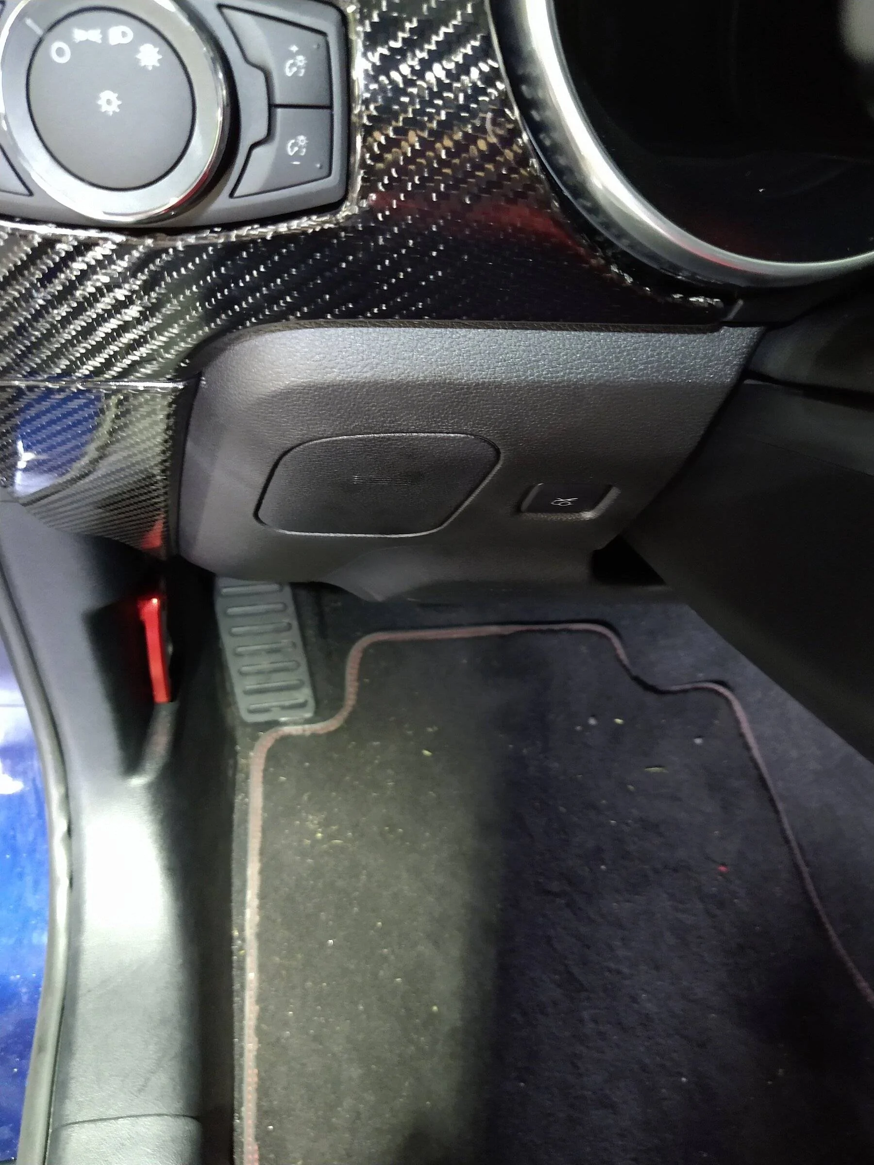

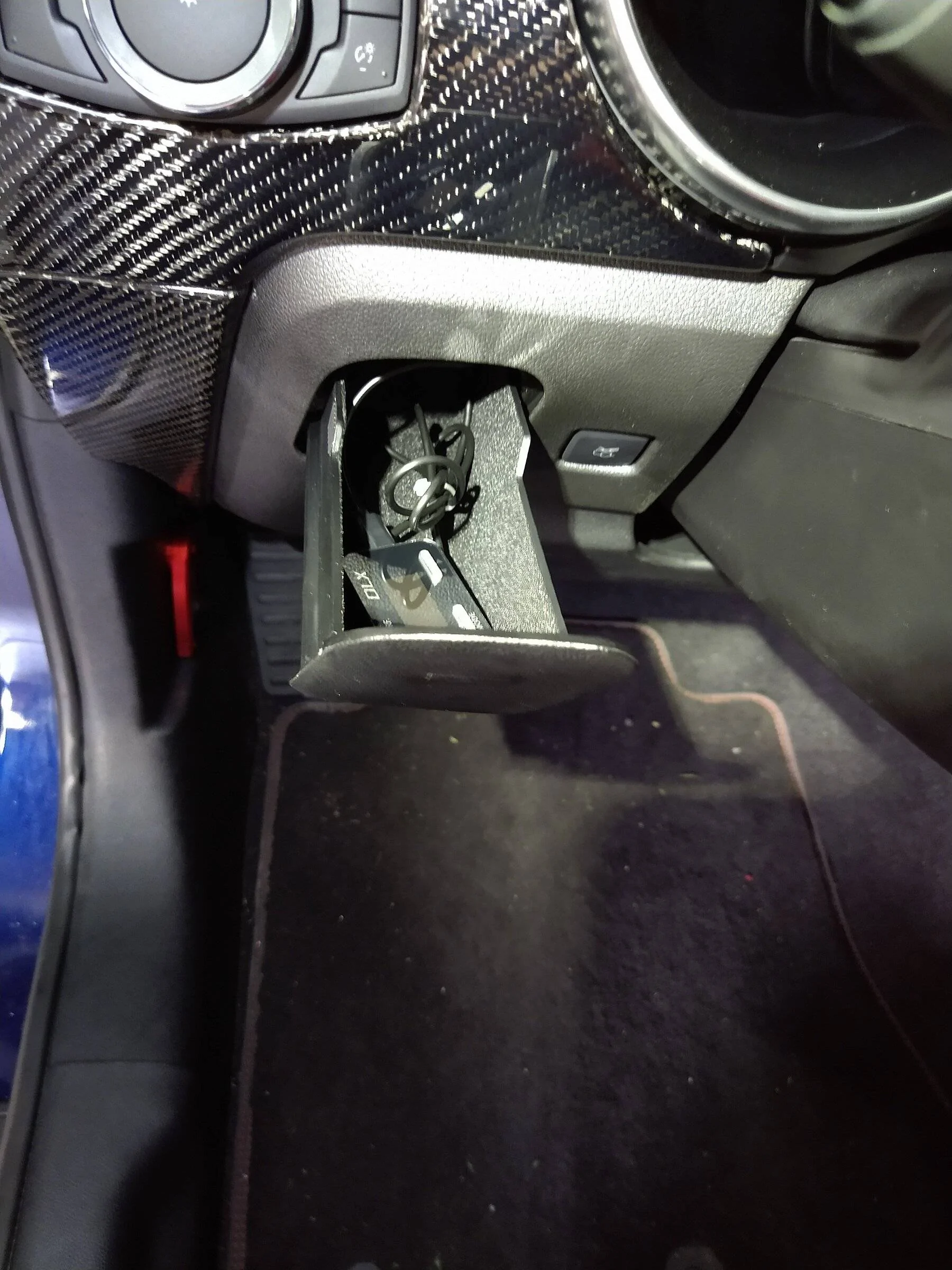

I routed the controller and put in my left side sunglass bin. It's hidden and easy to gain access to. Will take on road this week and give feedback. I will start out at Sport 6.

Good idea to hide it there! Definitely would like to hear your review when you do get some time testing it out.

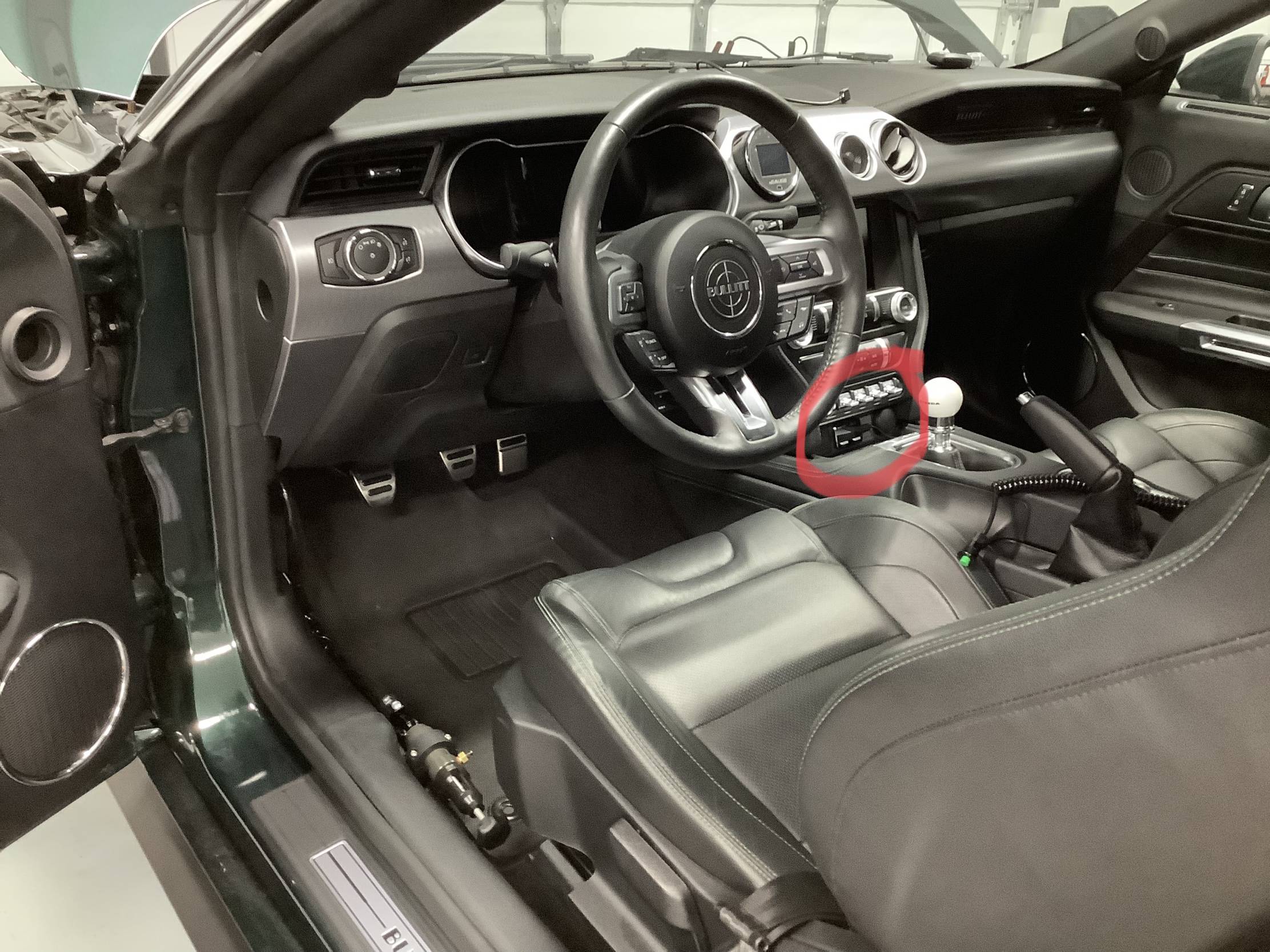

The sunglasses cubby is a good spot to hide the controller. That’s where I would have chosen to put mine too, if that spot wasn’t already occupied. I had to mount mine out in the open instead. Oh well, at least I have easy access to it where it is.
