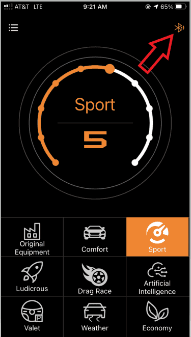

is anyone else having issues with the bluetooth loosing connection when you get back in the vehicle after it has sat for a while? the past couple of times i have had to kill the app on my phone and restart it and then it connects immediately. I have an iphone X

I have the same connection issue with my android phone.

Mike@SolerEngr
Mike@SolerEngr
Gold Sponsor
Jun 5, 2020
282
173
Alabama
www.solerengineering.com
2015 Stingray, 2021 GT Premium
No worries, there's a BlueTooth icon on the top right corner of the main screen to force connection when it doesn't do it automatically. Tap on it and you are good to go.

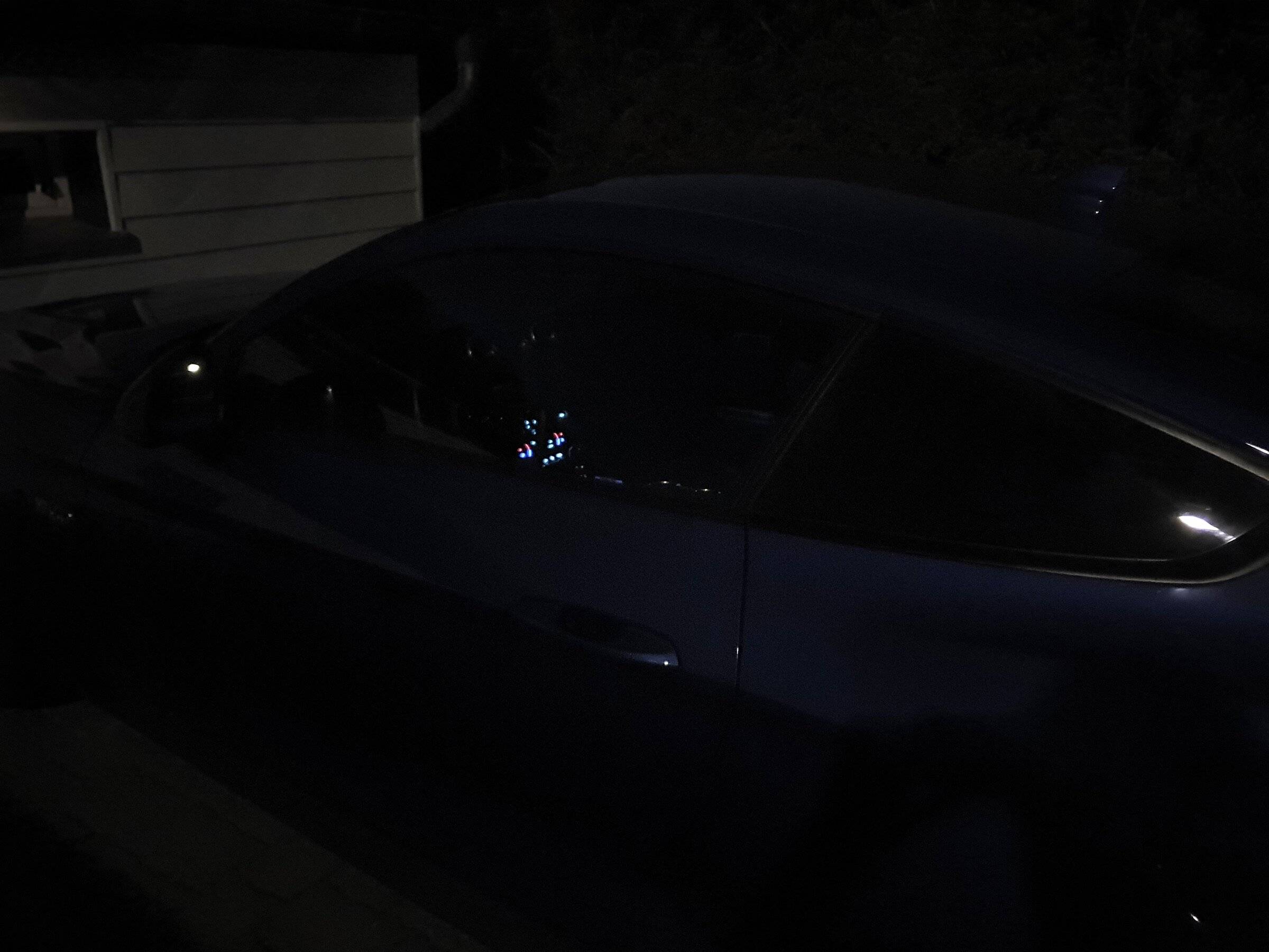

I've just finished installing the controller and will try it out tomorrow. I have unplugged the display after install.
Something odd I have noticed: The center console backlights won't turn off now (sorry, finished install while it was dark but you can see the lights are still illuminated after the car is locked, everything else is turned off).
Give it like 5 min. To see if they turn off. The Keep Alive Memory is weird. I was just sitting in my car today with the ignition off and depressing the clutch and checking out a couple of things. The led bar graph on the Soler TC display was functional. It went off after a few minutes.

Yes the manual also mentions it will stay on for a while. Was waiting for about 20 minutes, but it is still one. I unplugged the display on mine. Also, need to check a way how to securely attach it other then using ductape.
I put it on trickle charge for the night to be safe in case something is wrong, don't wanna have the battery depleted over night. I will check tomorrow morning if the lights are still on.
