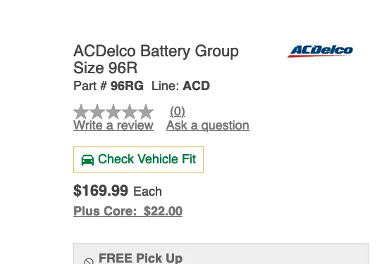

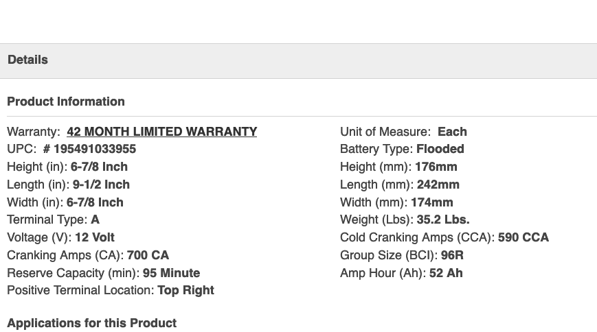

"store and came out and slow to turn over the starter solenoid clicking NO start> jump-start drove about 20 mins to work and killed it and it started like always. "
Have, no battery cables, or AAA, you're going to end up the creek without a paddle.
Get a battery, here is a very good replacement
to be considered>
Check the specs before blowing it off.
Exact and better than the Ford product, and cost-effective for sure. These batteries will last 10 years.
