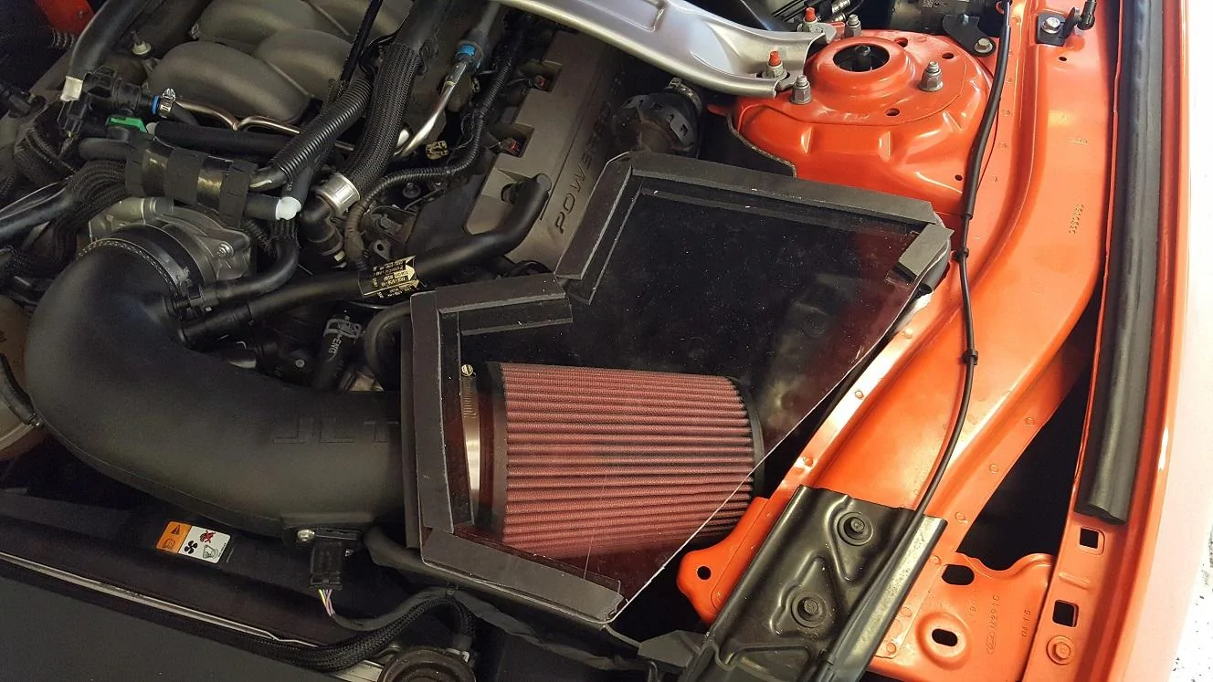

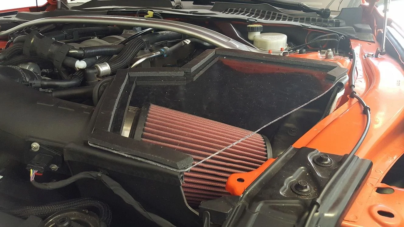

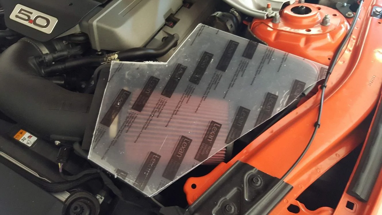

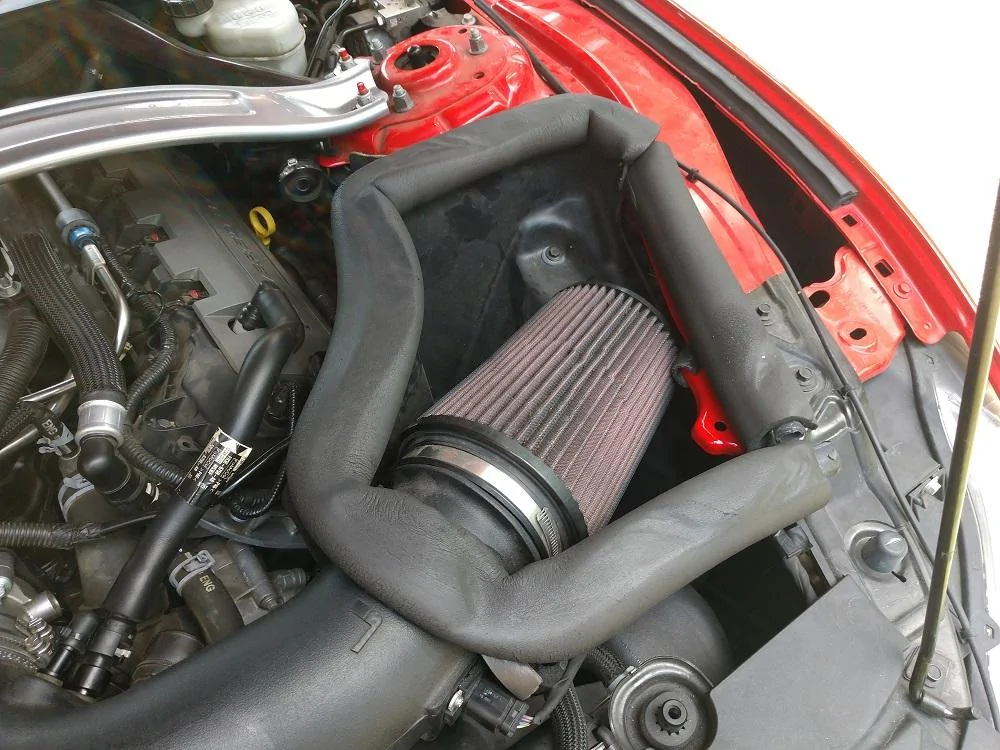

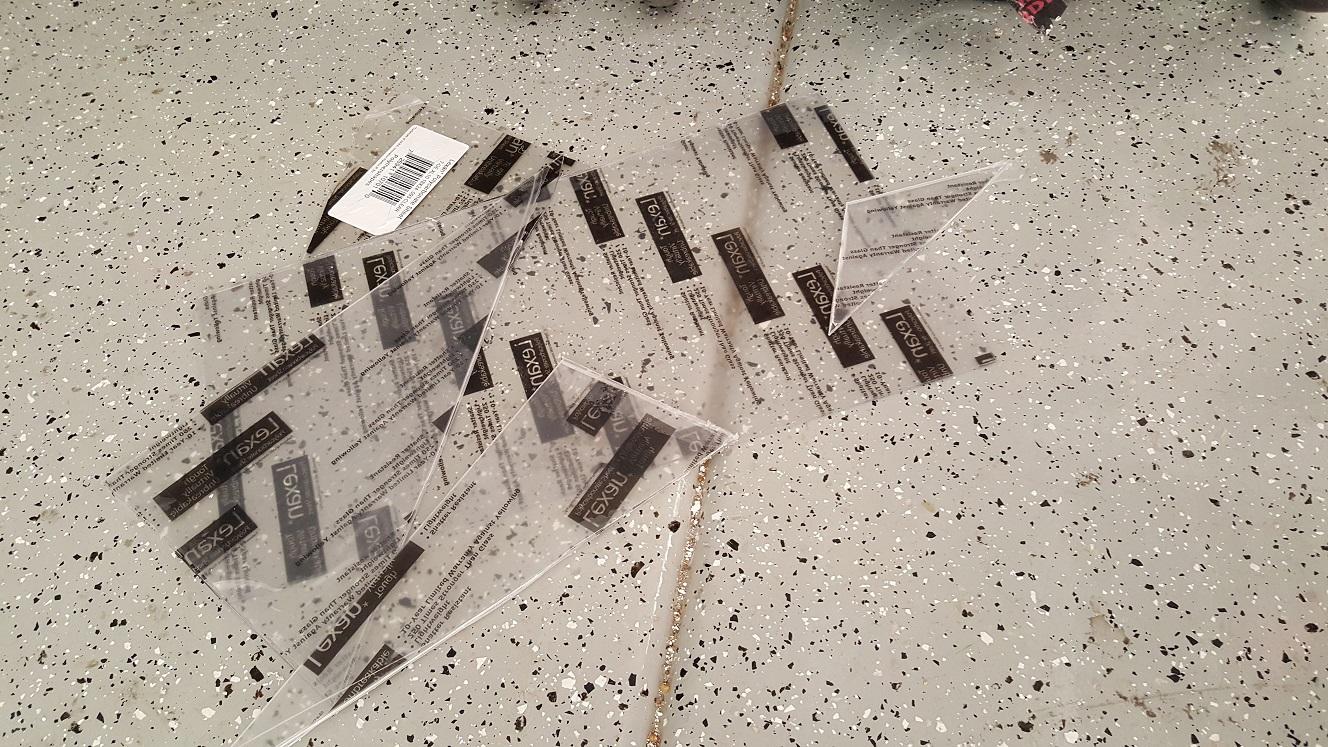

I have my cover done now. It cost about $15. I went to lowes for the plexi glass, and advanced auto for the weatherstripping. Took me about 20 mins to drill the honeycombs and about that long to make the cover. I can't go test it yet because of the heavy rain for the next few days. I will let everyone know if the temps climb slower.
I still think JLT should make a cover that is removable. That's the good thing about this DIY project. You can take the cover off or leave it on very easily.

Removing the engine shroud helps un reducing bay temps as well. Any pics?

Hopefully these pics work.

Two more pics.

Another
Did you remove the shroud? I removed the hood blanket before putting the lid on the JLT and the temps went up even faster I thought. Needless to say, I put it back.
When the heavy rain is over in a few days, I'll test with the lid on.

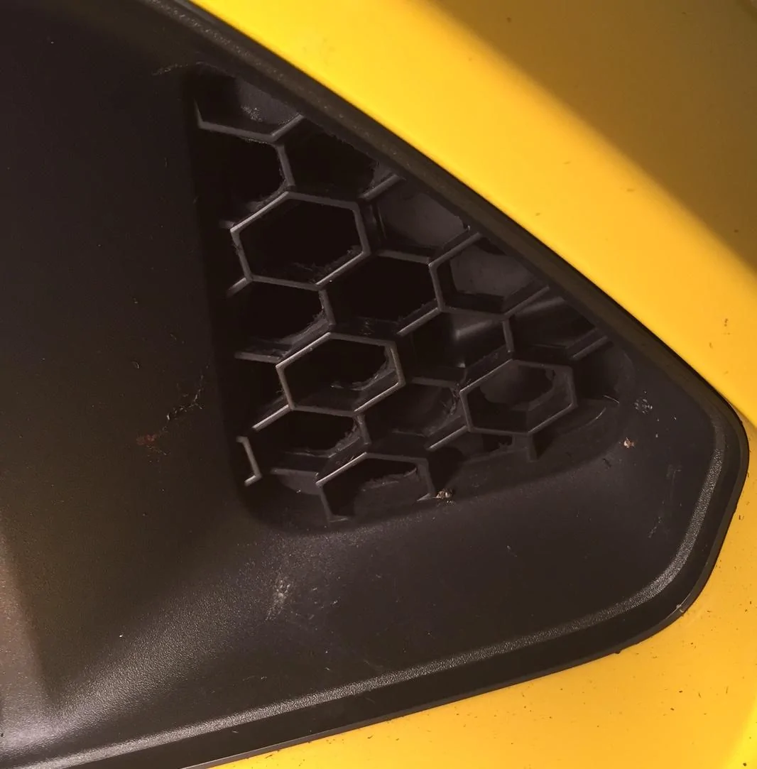

I left the hood blanket on but removed the dust cover from the engine. My lid is sealed down from the hood. Over the last few days I have been only 3 degrees above ambient.
You can clean those cuts up using a Dremel and sanding wheel, just use long even strokes, hahaha. Looks good!
Edit,
Also make sure that the air inlet tube is correctly positioned over the grill port. I am also planning on putting a filter sock over the filter because I drilled and Dremel ed the honey comb area on the grill, worried about my filter getting wet under stormy conditions. Sock should help solve this issue and protect my maf sensor

I plan on cleaning up those edges. What dust cover are you referring to that you removed? Also do you see more hood movement at hwy speeds? Did you just drill the honeycomb on the right side or did you drill out some on the main opening as well?

The engine shroud, plastic cover that says 5.0 on the front, dust Cover. That thing keeps alot of heat imo trapped in the engine bay.
I haven't notice more hood movement at all since drilling the holes out. Seem about the same, only difference is the average iat's went down by 1 degree from just having the cover on. With just the cover I was averaging 4-5 degree above ambient and after with the cover and holes drilled and being much cooler lately, I'm averaging 3-4 degrees above ambient. Very good imo. I only drilled out the drivers side lil triangle, every hole, even the half honey combs and then cleaned all holes up the best I could with a Dremel and sanding stone cone.

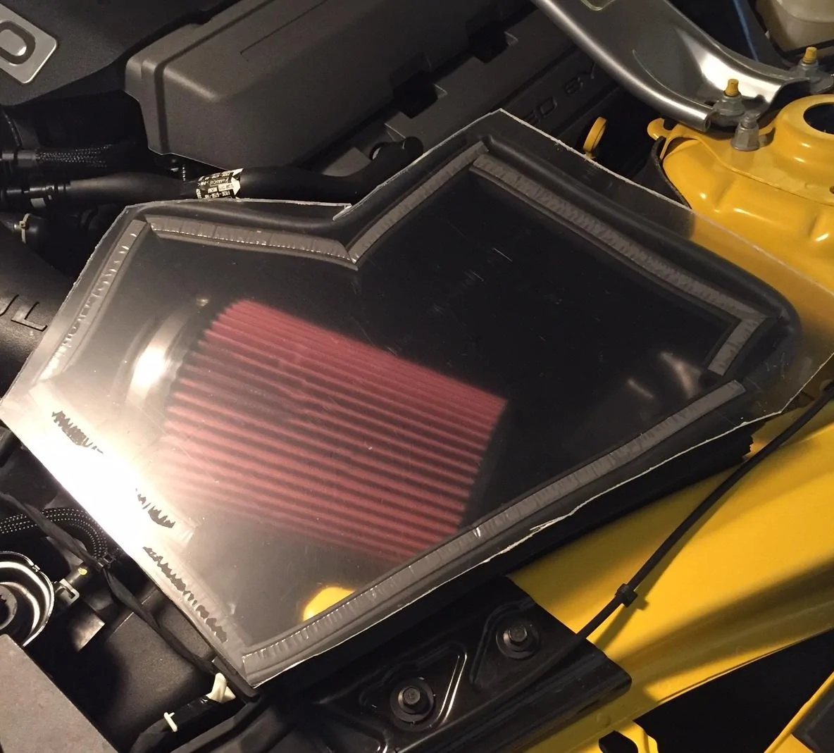

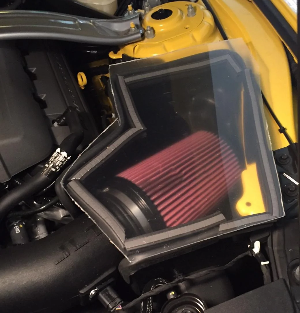

Reviving this old thread, here's my go at this. Started with a 18x24 piece of lexan from Home Depot, etched is down (used dremel for part of the corner cut), and the dremel to round off the edges. Some insulation foam tape around the bottom side to keep it in place and from sliding around, and then same up top so hood could push down on it more to help seal it. Appears to be helping on these hot days now, IATs will still creep at idle, but more slowly and haven't been as high.
