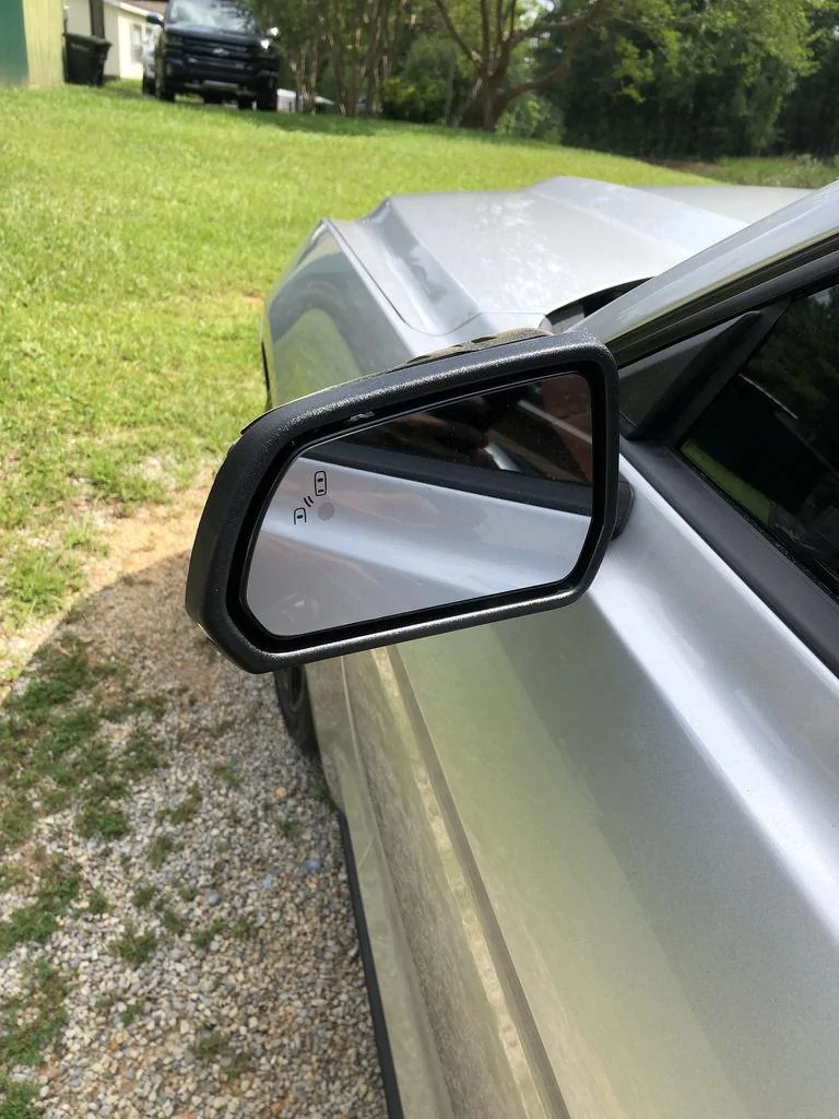

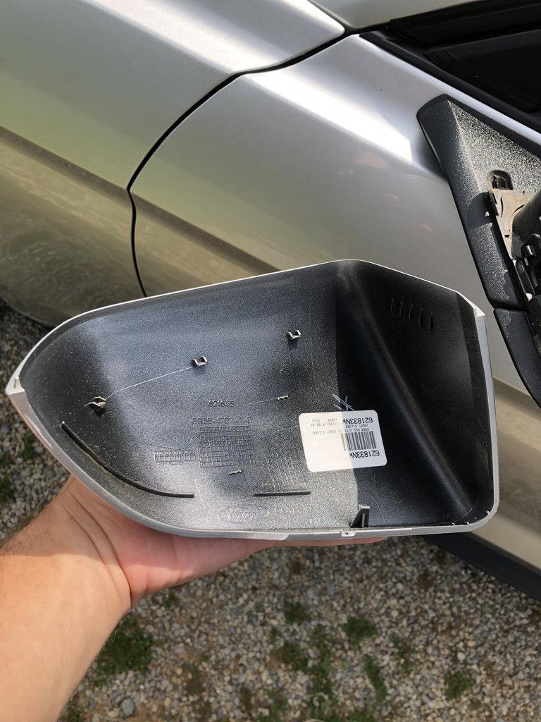

Was looking for instructions to remove the mirror covers and came up with the posts below. But they don't make sense because they can't both be right. Anyone know how to remove the covers? Searched the forum and just found these and nothing in a web search which just pulled up other generations, or how to install overlays on top of the factory covers or how to remove the mirrors from the car, etc.. Nothing for how to remove the covers.

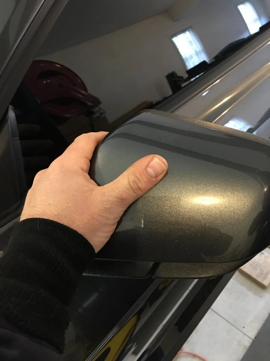

Just use your hands and standing behind the mirror place one hand here
and the other ready to catch it and pull towards your belly and it pops right off. Just did it last week.

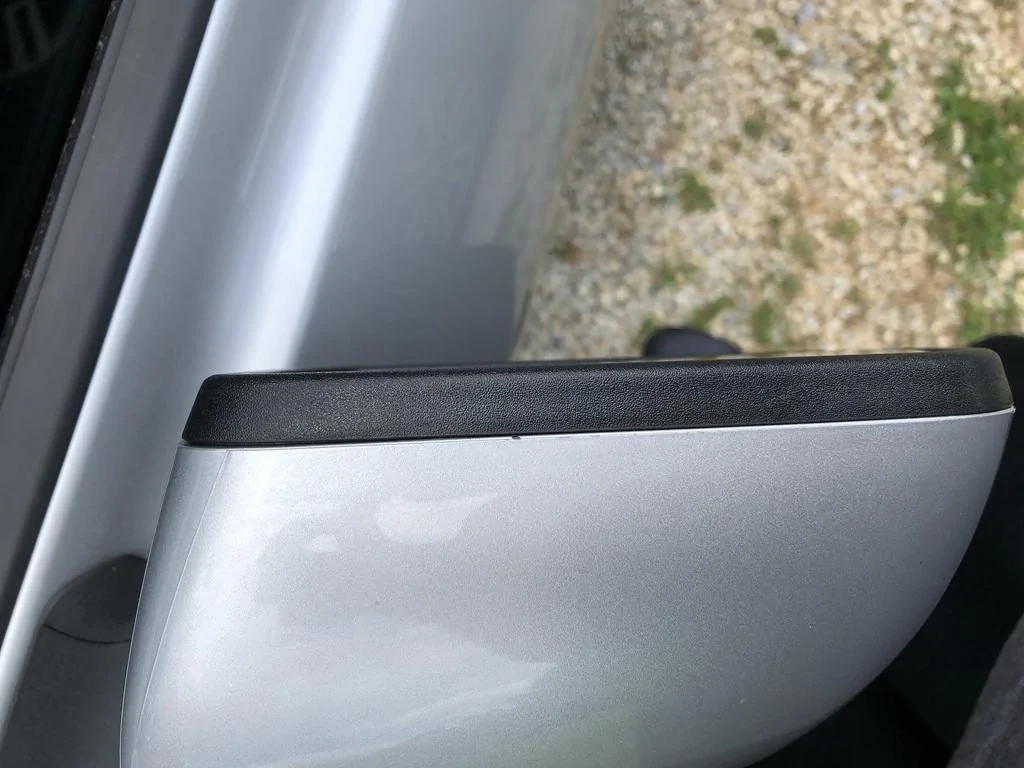

But its still not clear if there is a screw. Some say yes, others say no. I wonder if the BLIS mirrors have a different cover and different removal than the non-BLIS mirrors. Mine are BLIS, BTW. Or maybe people are just ripping the cap off the screw and relying on the tabs to hold it on when re-installed.
The BLIS mirror caps definitely do not have any screws holding them on. I've taken mine off several times by pulling without any issues.

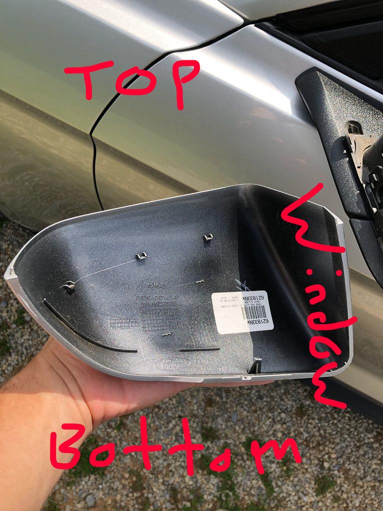

Awesome! Thanks. I guess it will remain a mystery why some mirrors have a screw. Or maybe none do and people saying that were basing it on the service manual which mentions one rather than first hand experience. Or maybe Ford planned to have a screw but never did or dropped it at some point.
Your pictures are great for showing the tabs. Since you've done it a few times, do you have any advice on where to grab and how to pull to pop them off?

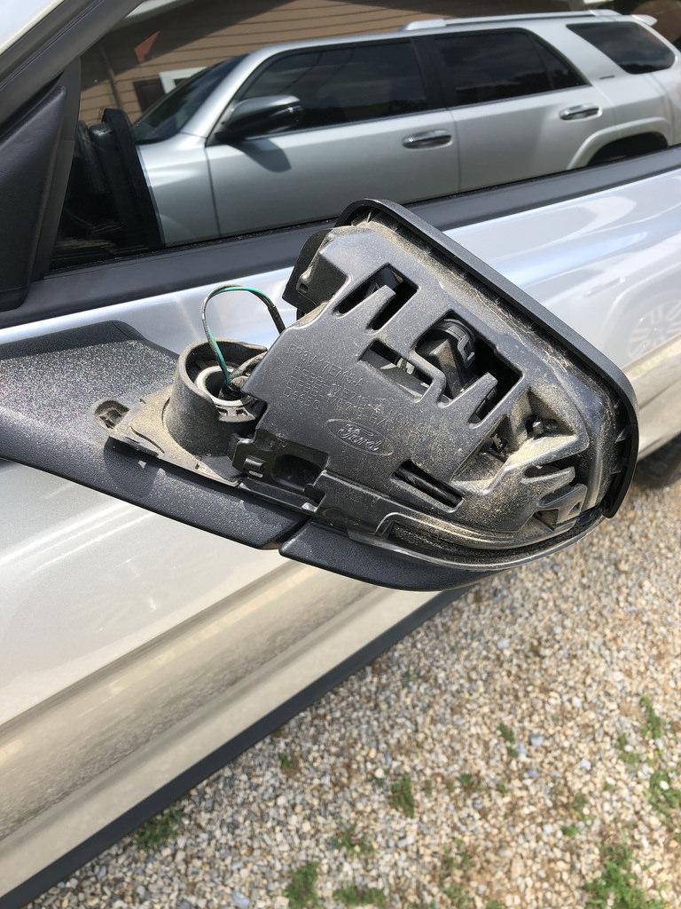

Since you have removed yours a few times, when reinstalling the cap back on, does it still seal well where it meets the black edging of the mirror assembly?
Are those little pins on the cap at the edge bottom corners where it would meet the black edging?
Thanks for the photos, defintley helps me more with my question in the other thread.
I would grab the edge closest to the door and pull straight out towards the front of the car with your hands. Then do the other side. I tried using trim removal tools the first time I did it, but that just ended up chipping the paint in one spot. It's one of those things where you feel like you're going to break it, but it will be fine.
It looks like it seals to me.

It does feel like it's going to snap, but it shouldn't. Just pull with steady and even force towards the front of the car. Like [MENTION=19673]AgentAlex[/MENTION] said.
Also, no screw. Just tabs.
When putting it back on, it does snap back on and sits flat. Make sure if you are wrapping it with vinyl, that the vinyl is perfectly flat in the seam. I had a few wrinkles and it refused to snap back on the car until I trimmed them off.

That is not how you remove the caps.
If you look at the tabs closely (in the above pic), you can clearly see how the engineered it to be taken off. There is even a little place to insert the plastic tool to release the bottom tab, and you swing the cap upwards off the other 3 tabs.
But, if you grab the cap from the underside (near the window) and pry/pull/peal forward, it should just pop off and you can lift up.
The bottom tab looks like it has a buttress to keep it from flexing. So do you think you use a tool to push whatever that tab is hooked on rather than pull down on the tab itself?

Correct, the tab won't flex, but you don't pull down on the tab, you pry the cap's plastic upwards. Allowing the tab to snap out.
I'm thinking you mean pry the cap plastic downward nearest the tab and the tab moves with it. But if not I'm too dense to figure this out. LoL

Sent you a PM, but you end up pulling up, to flex the plastic housing upwards, off the hinge point of the tab. You are not actually prying the tab, you are flexing the cap housing.

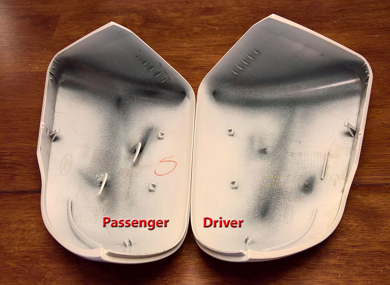

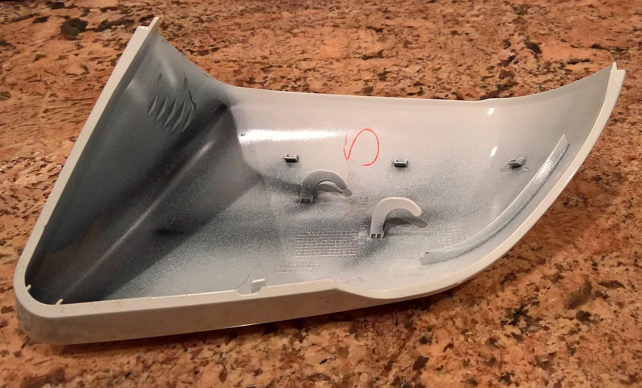

Am finally getting the paint done next week so pulled the caps.
