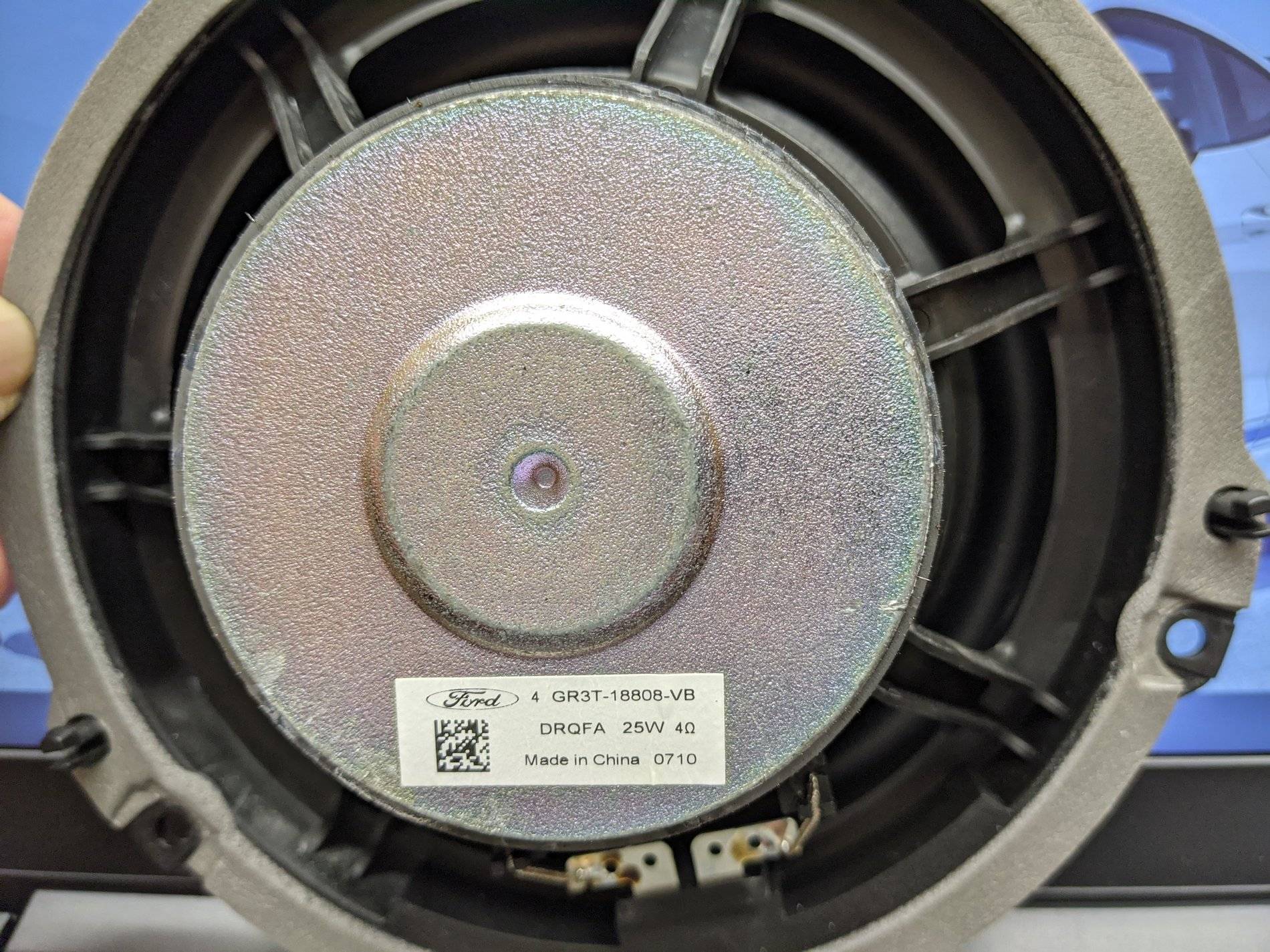

How can you tell the impedance on the 2019+ B&O speakers?

It is printed on the backside of the round magnet.
I don't know. I removed mine and it's written on the back, is how I did... I suppose you have to take them out unless someone has already done it and can tell you :)

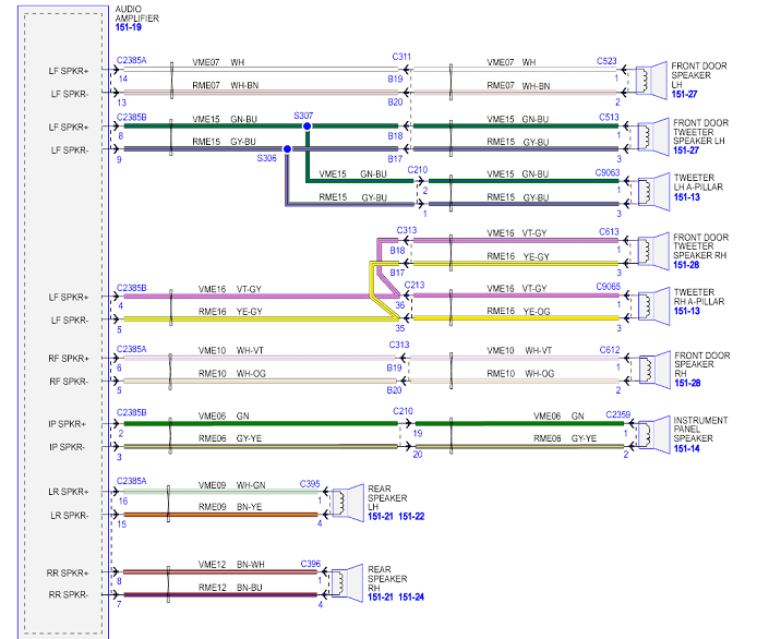

Here is the speaker wiring color diagram... The negative for the left is the white/brown wire, and white /ogre for the right. Took me a bloody while to work out what is what on the right, as you can't tell the colors much... Plus I was not sure what "OGRE" is. but it's the red looking strip.

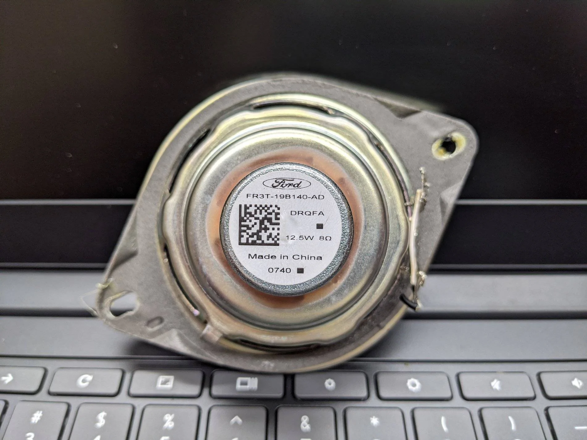

The tweeter is 8 ohm. Made in China ............. Shame on Ford !
8 ohms. Good info; thanks. Lots of parts on our cars are made in China, as probably is the computer keyboard that tweeter is sitting on. What specifically makes that particular tweeter poor quality?
