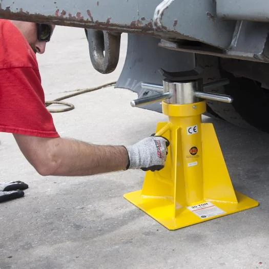

I've been kicking around the idea of installing a lift, either 2 post or perhaps even buying a Quickjack. I just don't trust any jack or jack stand if I'm under the car without redundancy. I don't even trust my Race Ramps without adding jack stands as a fail safe. I've searched on this topic and the most often mentioned solution other than a professional or consumer grade lift solution is wood cribbing.
However, I think I've found a solution. I'm thinking about buying 1 or 2 of these below. Between the ramps I have, my trusty Arcan XL jack, jack stands, jacking rails and these I cannot think of a jacking situation that can't be covered with redundancy. They aren't cheap but still much cheaper than a lift.
https://esco.net/products/esco-20-ton-screw-style-jack-stand/29/

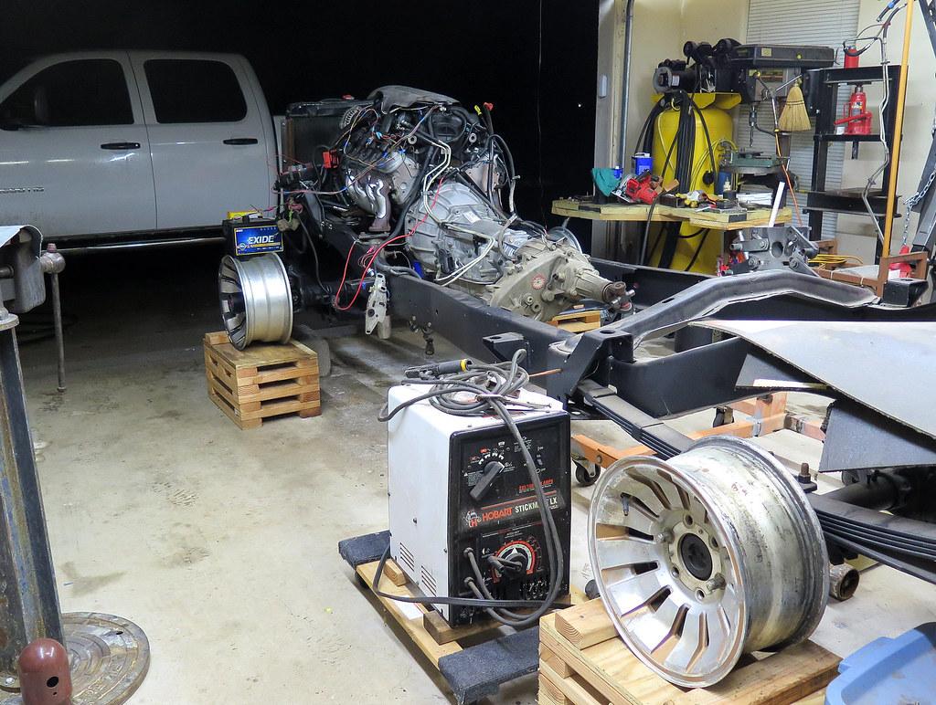

I do all the work on my vehicles unless it's covered under a warranty including rotating tires even when it's free from Discount, I don't like waiting and a little work is good on my chassis as I get older. So I do like options, I have a 2.5T floor jack, multiple bottle jacks, plastic ramps and a bunch of jack stands. Recently I picked up an air over hydraulic Pittsburg bottle jack from a pawn shop for 65 bucks. It's slow but easier to manage than the floor jack for placing jack stands under the truck for tire rotations.
The GT is a new situation, the plastic ramps worked fine for my 5.0 back in the late 90's but based on posts here, not a solution for a PP or lowered GT.
On the short, short list since I plan to change the oil soon is a low profile HF Daytona jack and jacking rails. It's not a must have when I can improvise and make the plastic ramps work or drive up on a few 2x12's and use the floor jack but I will need this gear soon enough.
I also plan on a resonator delete and that is where I would prefer cribbing but mine and the garage are still occupied by the Jeep chassis. I will say cribbing is cheap, strong and comforting working over, around and under so highly recommend it. Stacked they take up about the same room as a floor jack.
