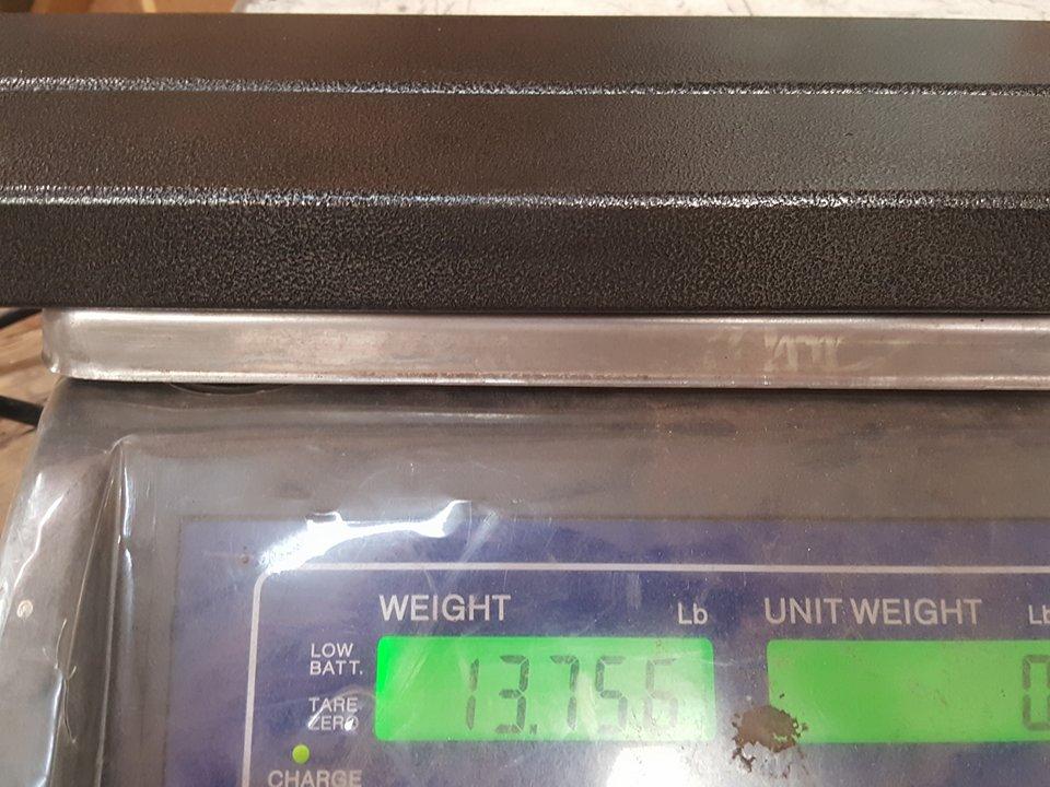

Then you'd be a prime candidate for them if your changing your wheels every weekend.
Why ? They would make no difference other than add weight (I know - they're -relatively - light) - but why ?

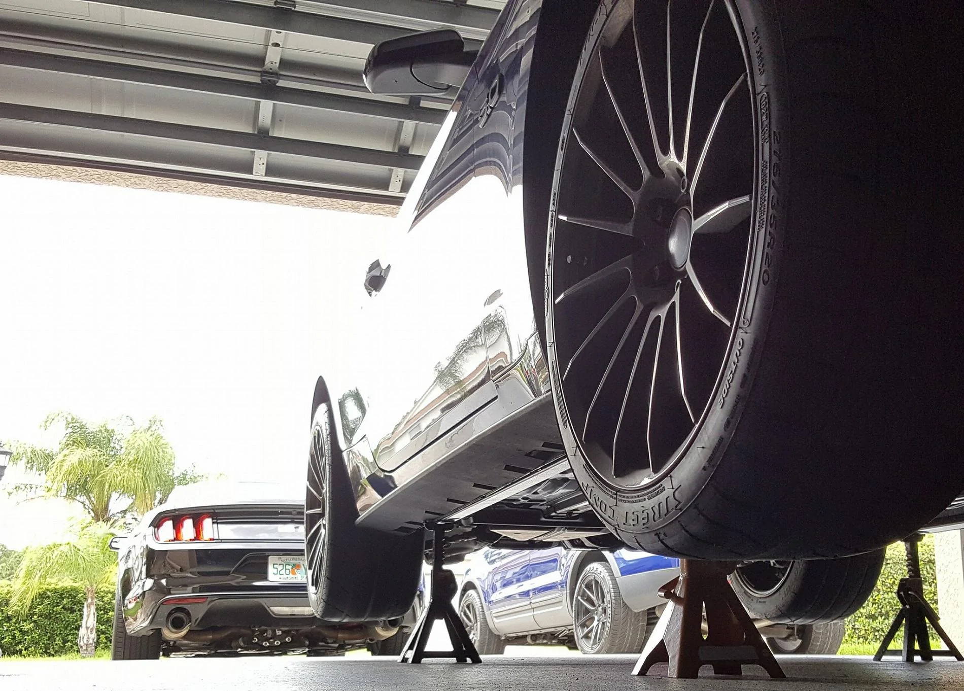

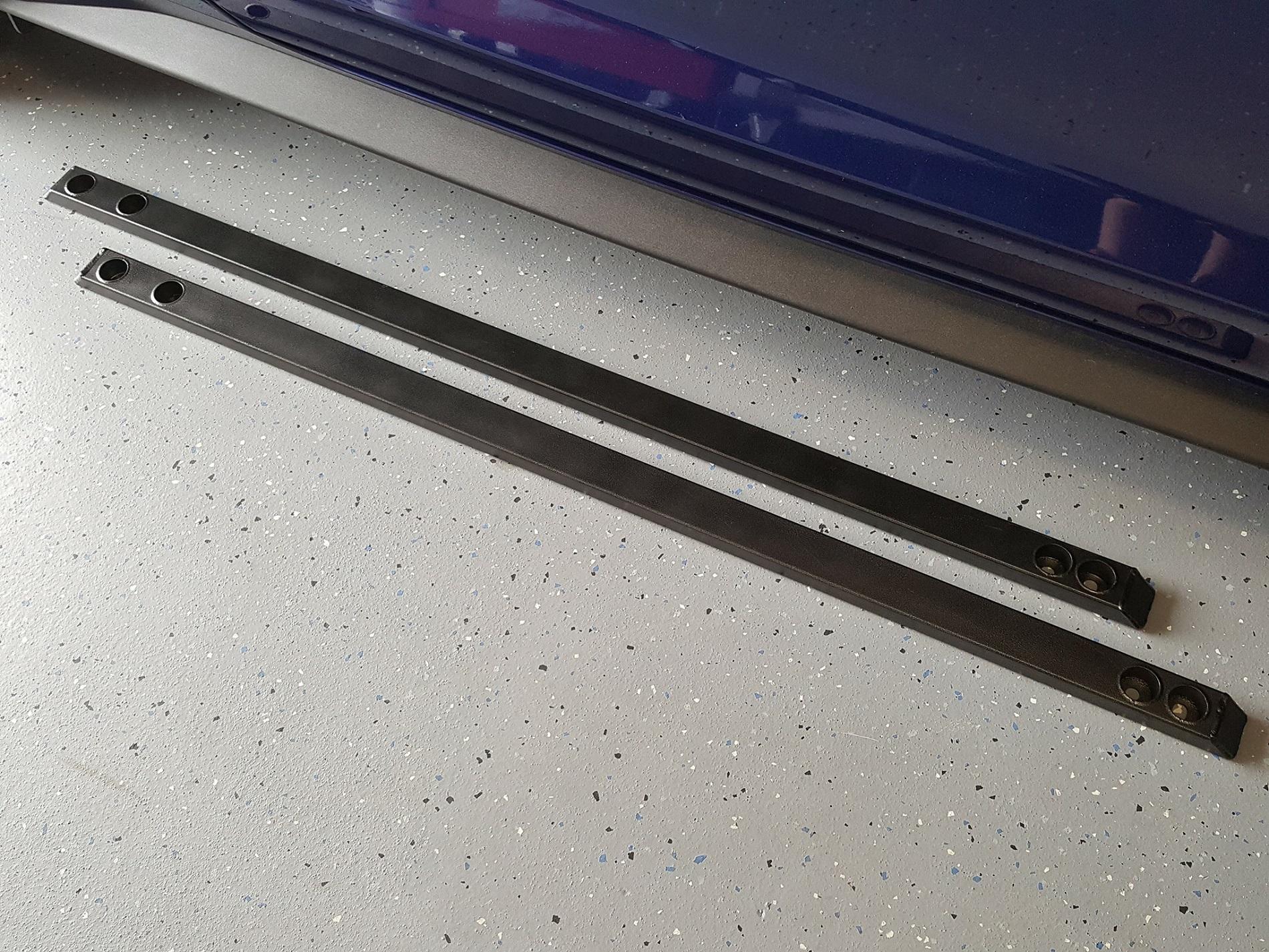

I have the Steeda rails, love them. As one who likes fiddling with his car, oil changes, tire rotations, new bolt-ons, they are indispensable and make getting the car up on stands a cinch. In a perfect world I'd have a lift in my garage.... but I get along fine with these.

I like the thicker BMR (1st gen) because the bottom surface is parallel to the ground. The race car was constantly being jacked up and the SCCA did not allow jacking plates or rails. The pinch seams and the surrounding metal was toast on the first car and I had to be real careful to keep it from happening on the second car. The S550 weights a lot more too. (3700 vs. 2200)

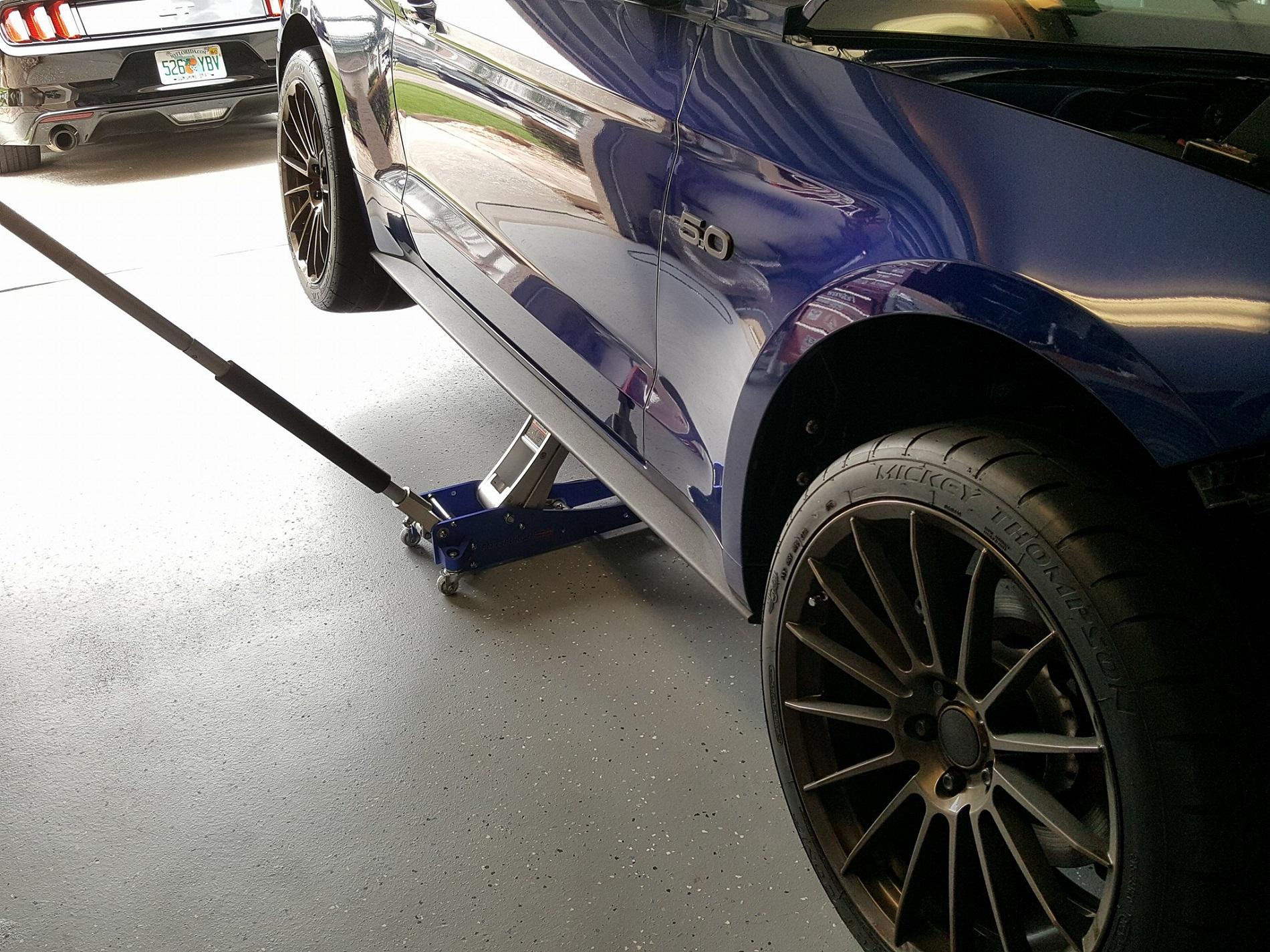

I put jacking rails on my latest S550 and I love having them. I don’t have to worry about tearing up the pinch welds because they can and will bend and having the solid bar steel or aluminum as a jacking and jack stand support point is a nice piece of insurance when you’re wrenching underneath of 3800 pounds in your garage by yourself.
To each their own - but they add value to my vehicle for me. Wish I’d had them on my last S550!
I went with Steeda ones with my convertible after seeing bmr videos showing people having to widen the pre drilled holes to get them to fit on a couple cars online - it surprised me that was a thing. But the other BMR stuff I’ve had had been great - I’ve actually got another lockout kit coming for this car and their diff inserts to try out.
