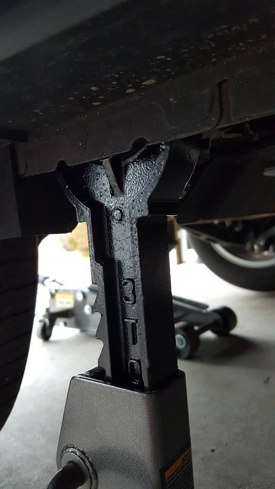

I need to jack the car up on all 4 tires, so I've bought Jack stands but they don't have a notch for the pinch weld. Is it fine to place them on the reinforced pinch weld section anyway? They do have rubber protection boots though.
Could I perhaps place them like this too or is the reinforced section only on the pinch weld?

You're doing it wrong

Rotate the stand 90 degrees.

I have this but it scratches the hell out of the paint on the pinch weld. I switched to just using a normal competition style hockey puck. It can flex and grab the pinch weld without scratching it up. As far as jack stands on the pinch weld you can, I've done it. If you can lift the car from there you can also support it from there as well.

Realistically you can use a jack stand pretty much anywhere on the pinch weld as long as you aren't trying to support the weight of an entire side of the car. Use a cloth or something to not mess up the paint though. The logic being that the weld fits snugly in the little notch in the jackstand. If you look at how the pinch weld is reinforced at the little arrow pointer sections, it carries a decent distance fore and aft of the arrows. As above, if you can lift the car there, you can support it as well. Using the inboard control arm mounts is another good spot.
