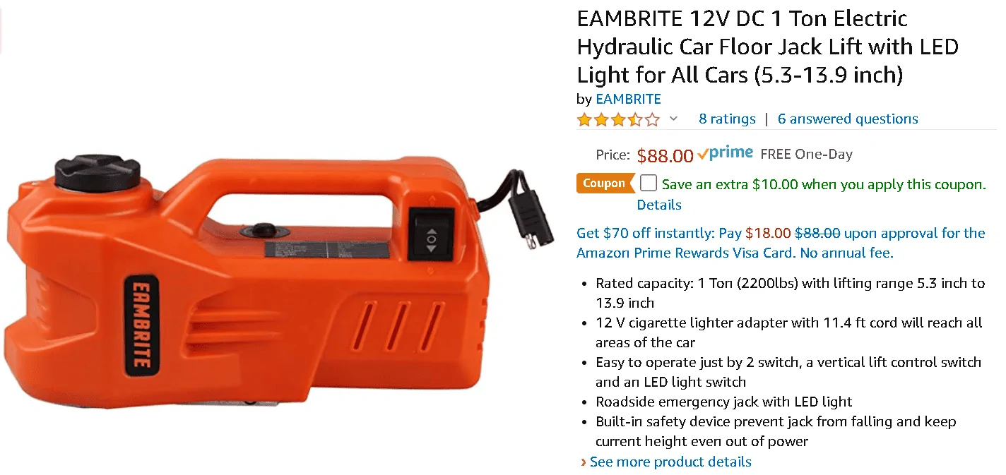

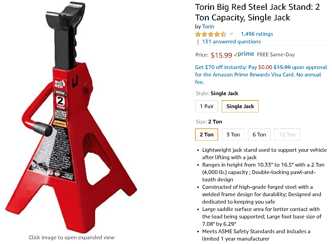

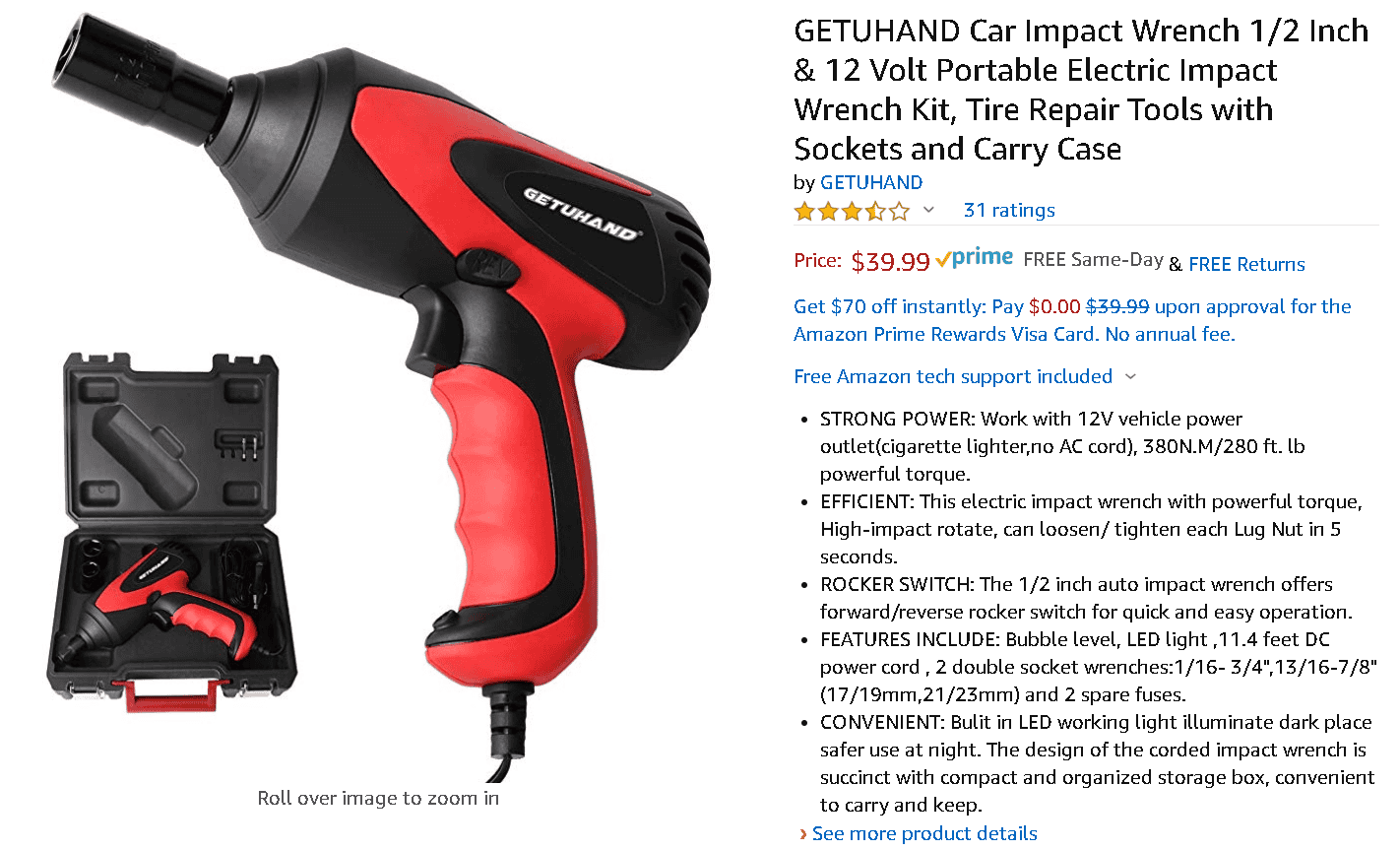

This is literally all you need to jack off in mere minutes. I didn't even break a sweat jacking off all 4 wheels today while doing pads. I wish I discovered these Clutch & Hammer impact guns years ago. Such brilliant design while only requiring your standard 12v socket.
