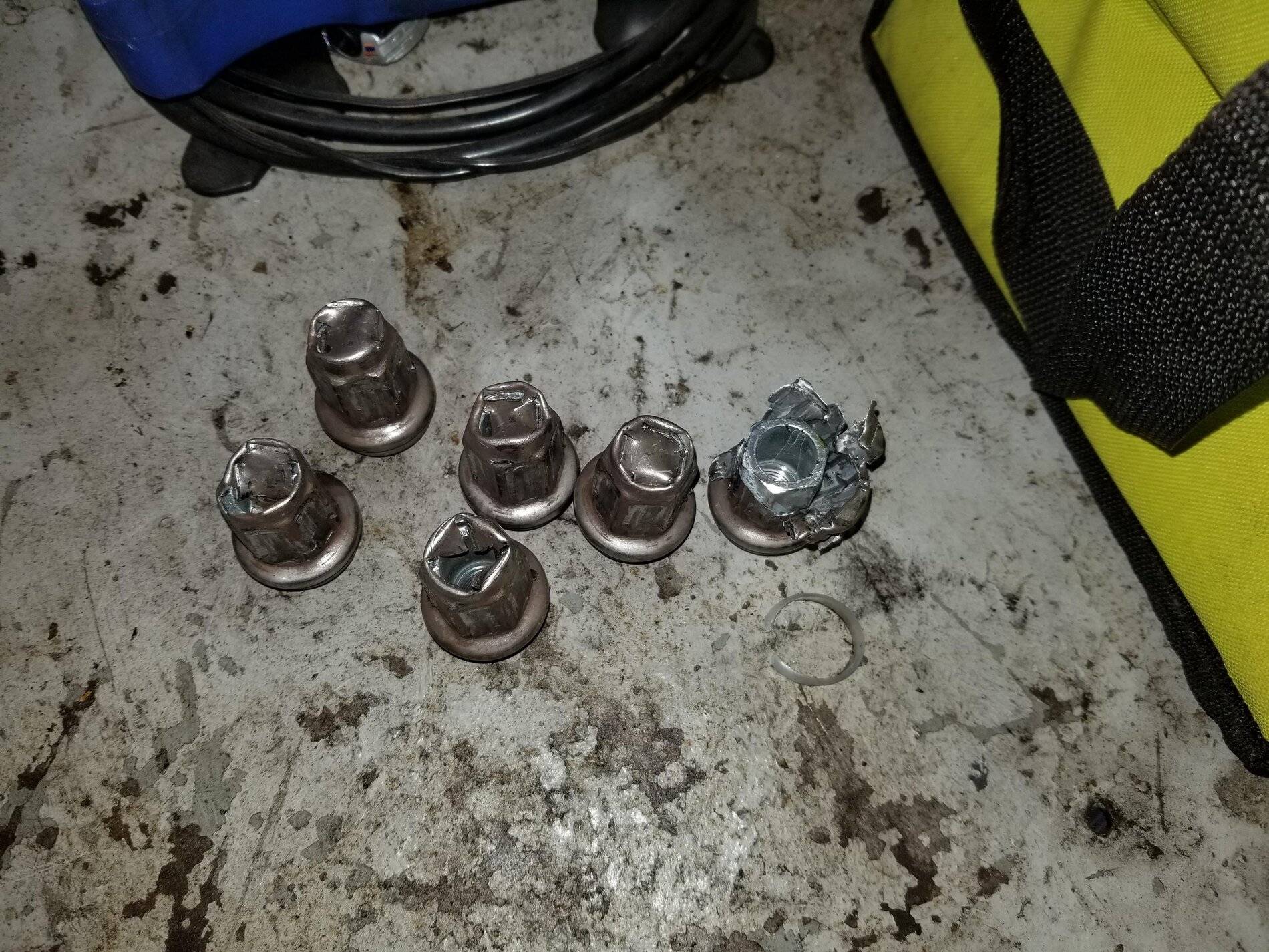

Of course, AFTER having this conversation in my head, I go out to remove the wheel, and... The socket just spins. The socket is stuck... After 30-40 minutes of gently hammering, and vice grips on the stuck deep socket, etc... I finally manage to take the socket off. The lug nut looks completely bulged, and I think the "cap" must have turned over the nut...

It's a super common problem on ford lugnuts. I see it a lot. It is a thin metal 'cover' over an actual metal lugnut - like hardened aluminum foil. Once you are able to chisel that down to the actual lugnut, youll be able to fit something like an 18 or 19mm on it and get it off.
I wish i had better instructions for you.. but it always happens when people overtorque them and flex the outside 'shell' I have 19.5 and 21.5 mm sockets just for this reason.

You can probably get by on stock lugs if you put on and take off by hand, using a good fitting quality socket. However, if you are using an impact wrench, you will not get away with this for long. The recommended torque is 150 ft/lbs so your impact wrench is beating the crap out of these to get them off and to put them on. This is what I have seen loosens the stainless steel outer shell.

I have never seen an official explanation, but the outer shell is stainless steel. So my best guess is that they are there for just appearances, in other words they don't corrode so they will look good for years. And ford doesn't care about what happens with the bare steel lug nut underneath.

The steel lug underneath will eventually cause the cover to swell once it rusts. No bueno if you're driving the vehicle in areas that use road salt in winter.

But i think the problem started because when I did NYS inspection, the dude used impact to get the lig nuts off and then impact (no torx sticks) to put them on. He really went to town on the lug nuts.

I don't know where your at with this but when I had this problem... like 3 years ago or so but anyhow, I believe I just screwed the stuck lugnut attached to the socket back onto stud of the wheel a few spins and then wiggled the socket loose. may have needed a light hammer up, down, left, and right a few time too.
