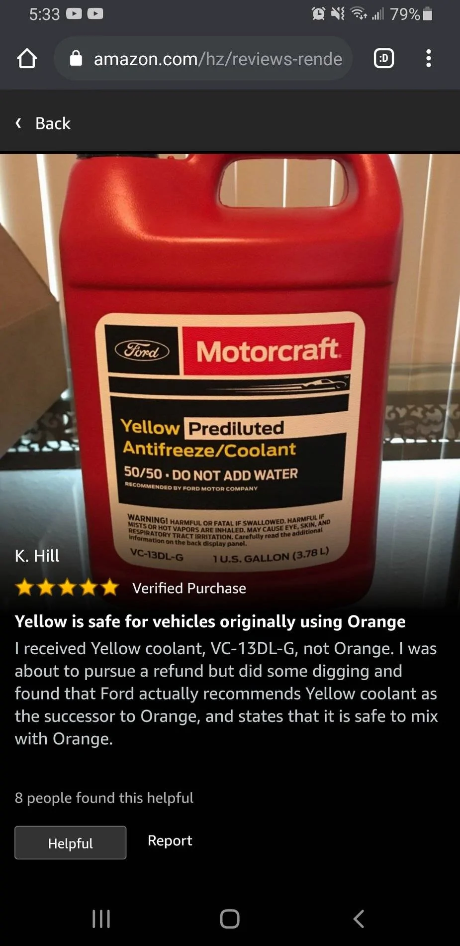

If you order the orange on amazon they will probably send you the yellow since orange was discontinued.

If you look at the reviews theyve been sending yellow instead of orange. I didnt just make up this info...

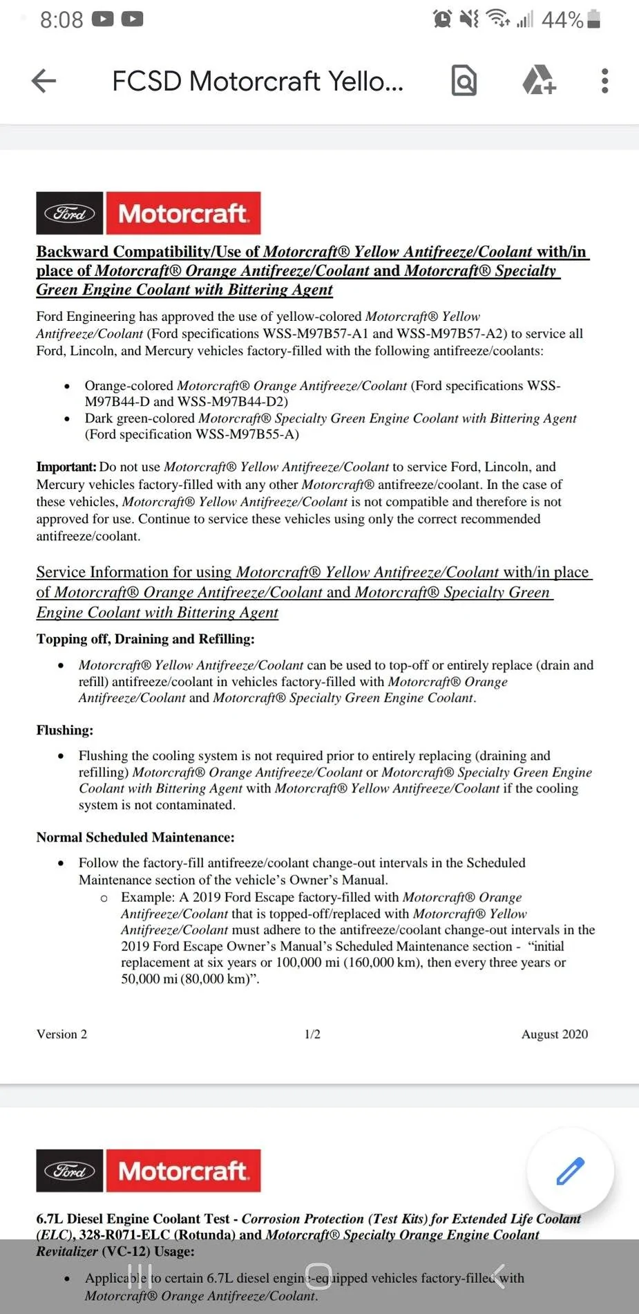

For the folks claiming that it is ok to mix orange and yellow, could you post a statement or other documentation from Ford to back that up?
ORRadtech
Sep 12, 2019
4,090
4,032
Atlanta, Georgia
I agree, I'd like to see something written from Ford rather than hearsay.
I specifically asked one dealer and they said don't, another said they thought it was ok.
My owner's manual specifically says not to mix colors.
Adamone92
Apr 30, 2020
33
1,385
960
California
Adam
2022 Mustang GT PP Premium
The ford TSB said that it can be mixed. Im not going to relook it up again when ive already done it myself and you can do it too. It says when topping up or flushing the system the yellow can be added. I do understand yall wanting to see proof though, its just not more my responsibility to find it than it is yalls.
Adding the yellow to the orange doesnt extend the life of it..itll still need to be changed at the orange interval while its mixed.
Edit..actually i went and found it again. (Hint..cobrajet linked it earlier in this thread...)
Also yes..my dealer also said they dont mix. Dealers are clueless 99% of the time.
http://www.fcsdchemicalsandlubrican...Antifreeze-Coolant Backward Compatability.pdf
