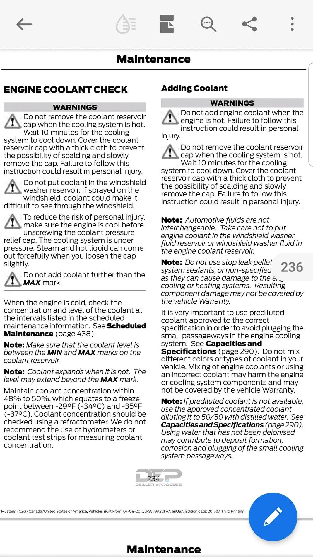

This really doesn't bear all this worry. Just read the owners manual.
To paraphrase it.
Add when cold, fill to between min and max.
When hot fluid level CAN exceed max level.
Here,
