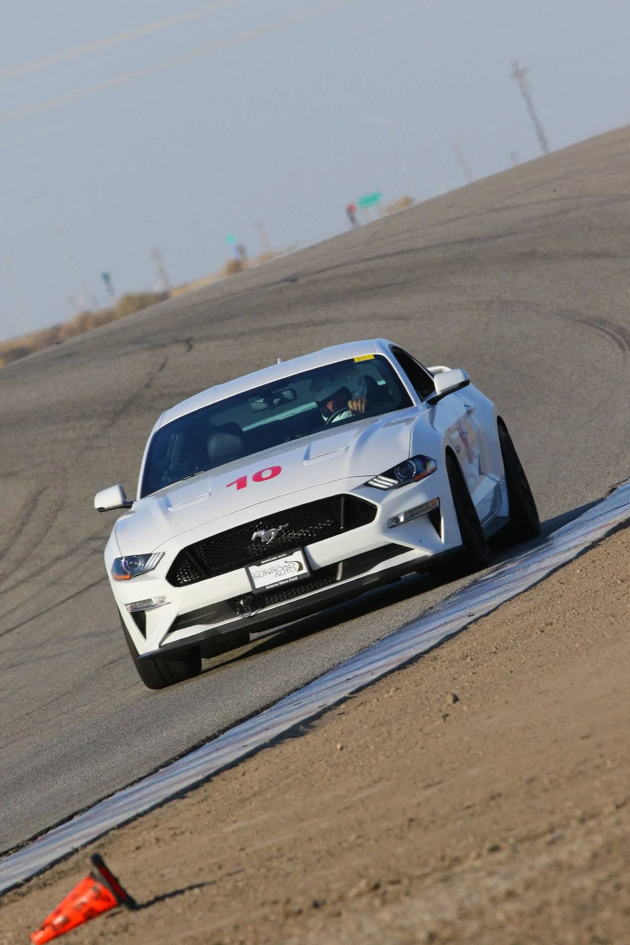

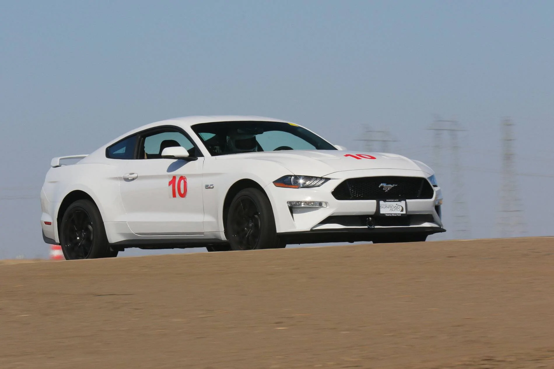

I was in a similar dilemma last January. I wanted a Mustang GT 350, but the local dealers were adding a $15,000 dealer markup on top of the car $67,000 MSRP...too rich for my blood. So I decide on a Mustang GT (Deluxe) with PP2 if I could find it locally (I couldn't), or I'd settle for PP1. That's what I have the 2020 Mustang with PP1 and the 10 speed automatic. Having four modes in the 10 speed, incredible. Around town, normal mode is just fine, at the track I love Sport +, auto shifting, up and down. PP1 is awesome...I'd love to have that sound control on the exhaust...maybe Magneride...but I don't, but I do have a kick ass little car! The 6 piston Brembo calipers do the job, but will get hot...I have some air ducts on order from Vorshlag, 1 mm titanium shims that go between the pad backing and the caliper and a set of Hawk DTC 70 pads on their way. I don't want to have to deal with brake fade on the track.
Feb-27-2021-POC (Sat)-Yellow-Close Ups 155pm-BW3_0316_Feb2721_208PM_CaliPhoto.webp
Feb-27-2021-POC (Sat)-Yellow-Riverside 410pm-BW3_3897_Feb2721_423PM_CaliPhoto.webp
