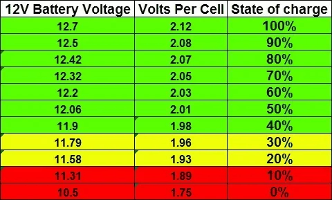

Put the car in accessory mode (don't start the ignition) and if you have voltage output on your dash, you can see:
A somewhat more accurate way to measure battery condition using voltage is to use a DVOM directly on the battery terminals.
After turning the car off turn the headlights on for 15 or 20 seconds to remove the surface charge. Then measure the voltage at the battery terminals. You can use the chart above to get an approximate state of charge.
A hygrometer will also give you a state of charge but if you have a permanently sealed battery that won't help.
Also, you can buy small, hand-held battery testers that are reasonably accurate. I bought mine off Amazon for under $40 and it's been very handy in identifying or eliminating the battery when troubleshooting.
