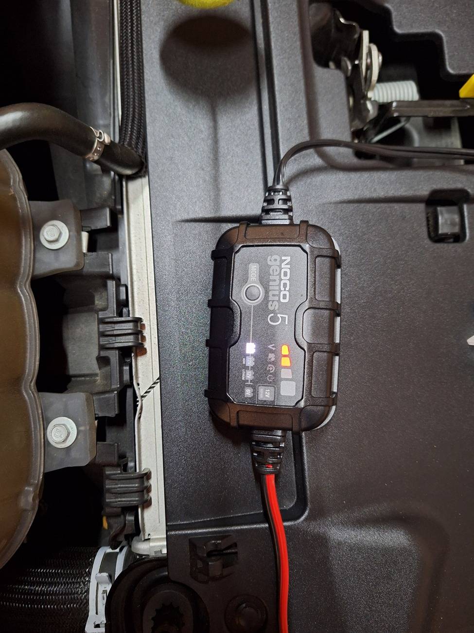

The battery on my still new to me 2019 GT Premium goes dead when parked in the garage, engine not running, with the stereo on, Volume 15ish, for a couple hours. I have never experienced this with a car battery before. I purchased a charger, and leave it on overnight when this happens, and all is good until an extended period with the stereo on and the engine not running.

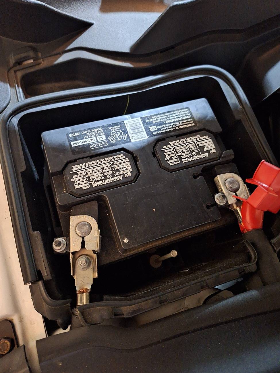

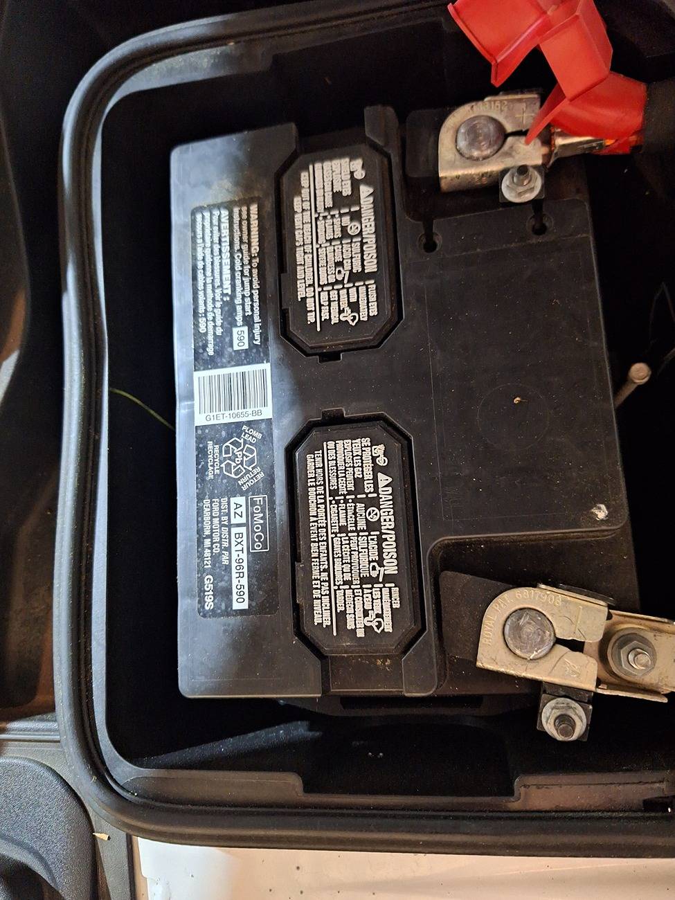

Is this a (old or bad) battery issue or a known issue? Pics of the current battery and charger I purchased are attached.

If that's the original battery, that's probably why. The OE batteries in these cars are notoriously weak and short-lived. Get it tested to be sure, but I'd be willing to bet it's on its last legs. Enough power to start the car, but not enough reserve power to run accessories for much time at all with the engine off.

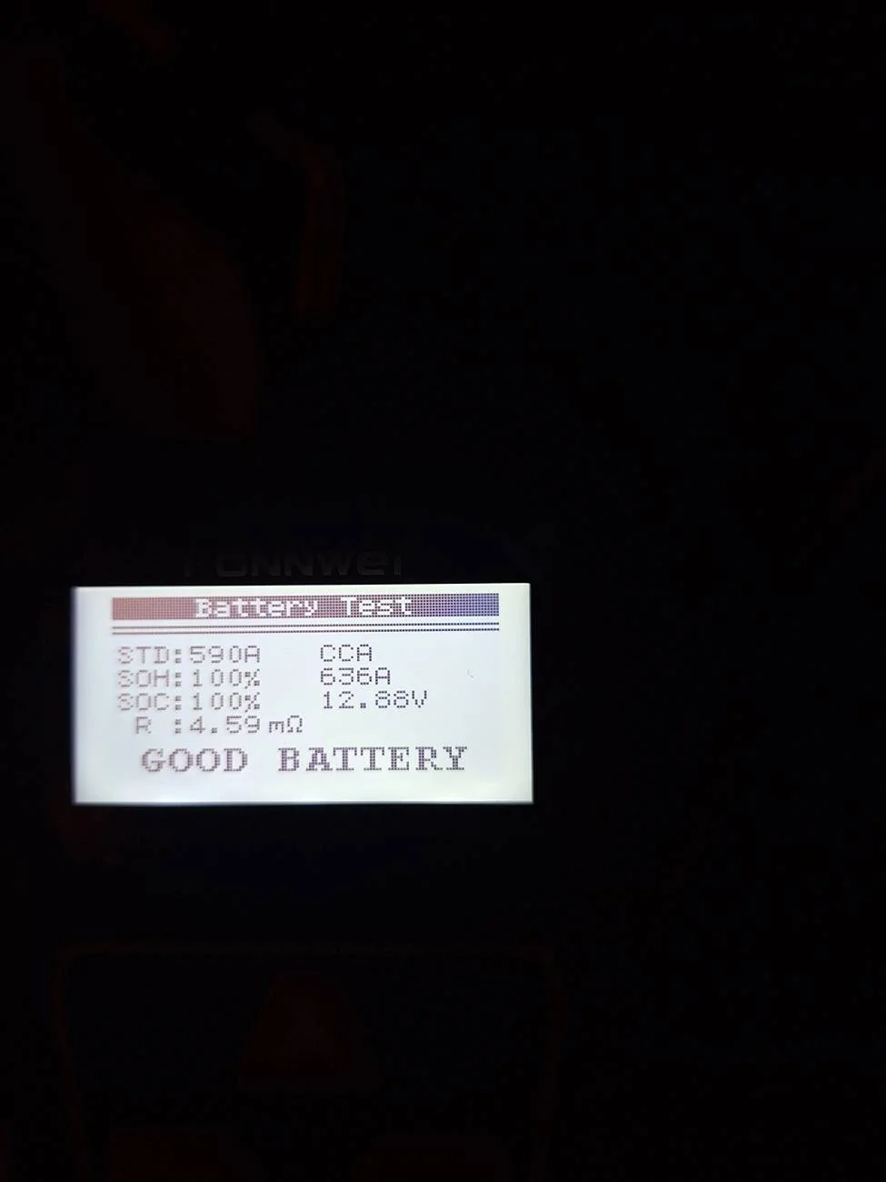

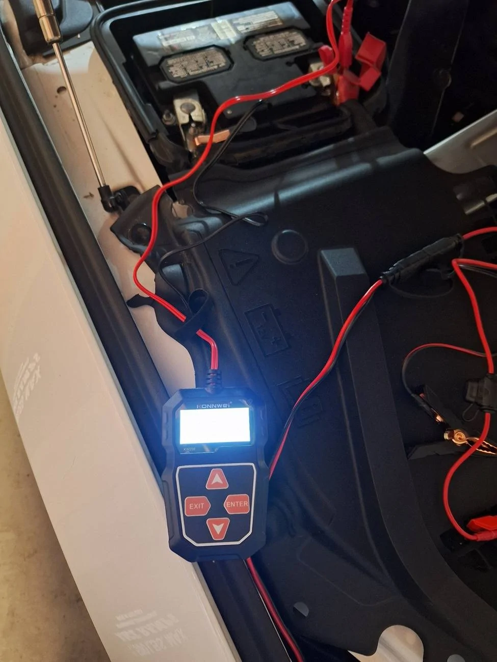

Totally forgot I have a brand new battery tester I bought for the boat. Unplugged the battery charger, removed the clips, hooked up the tester and it shows the battery is good. Is that because there's a full charge on it right now?

Looks like the one I have :) Probably good to go but may test it again in a few weeks.

So since the battery tests good, at least right after a charge, sounds like this is common with all the electronics on this car. That's disappointing, if I were to go somewhere, park, listen to the radio for a couple hours, my battery is going to go dead.

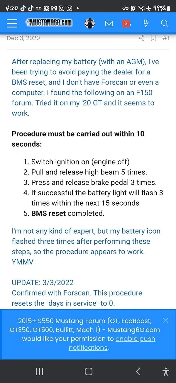

Reset BMS, and if this doesn't work get your battery LOAD tested by two diffrent places
