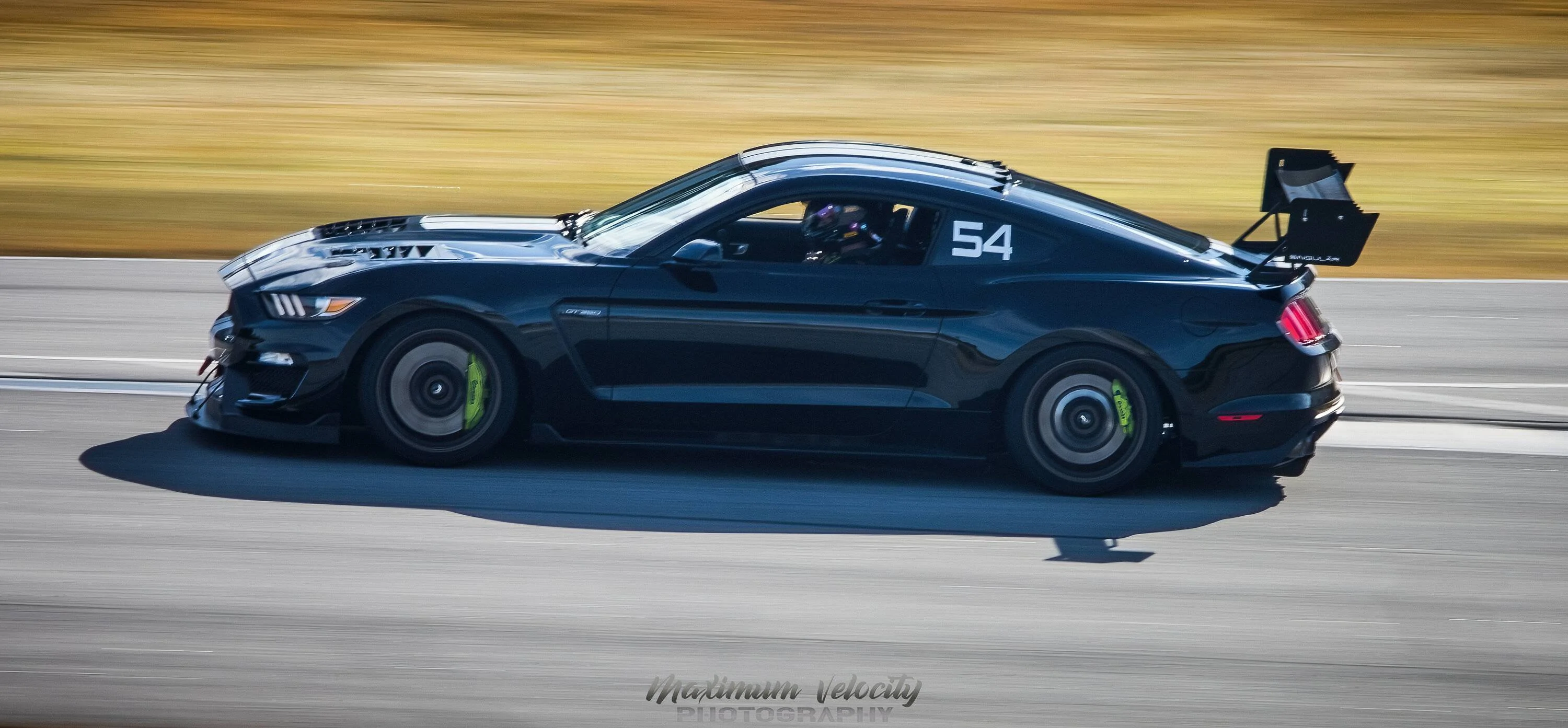

Need some convincing to step up to 325 or stay 305 squared. For the ones who have run both did you notice any substantial benefits? Have all the necessary perquisites to make it fit with no problem.. MCS RR2, OP Mustang studs, spacers, tons of camber.
So far the only cons I see is: limited tire selection and more expensive. But I plan on running exclusively SC3R on them anyways.
My car for reference :like:
