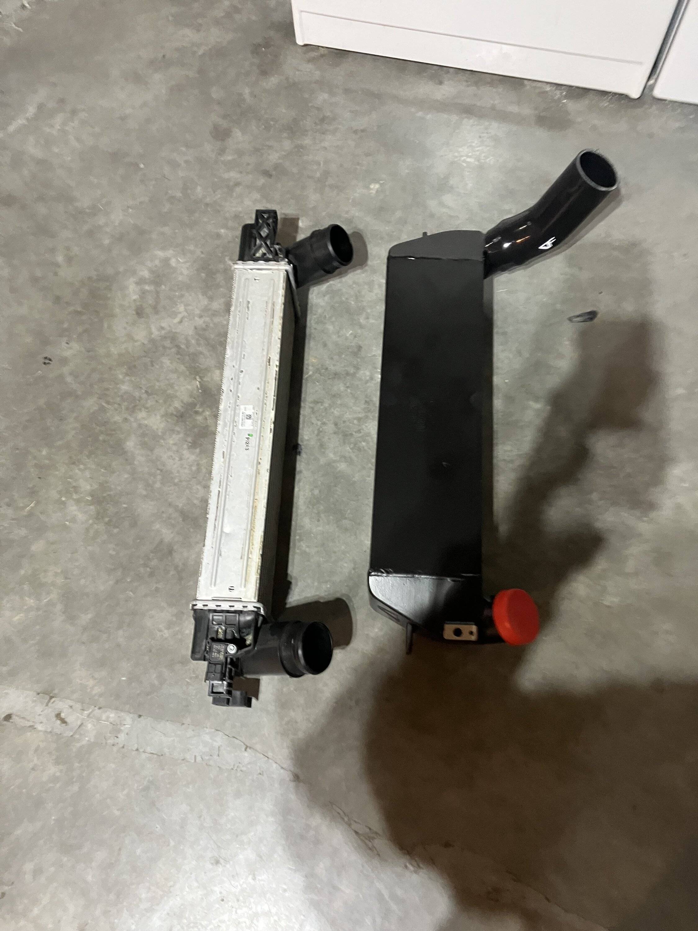

The ICs sit so low in the front that you really only see the top 1/3 of it and have to get to ground level to even see that much of it. I choose black as my preference.
