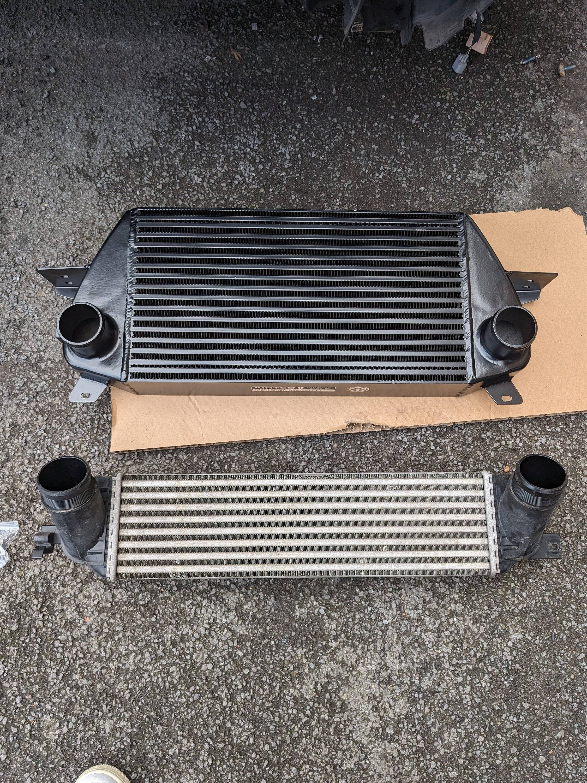

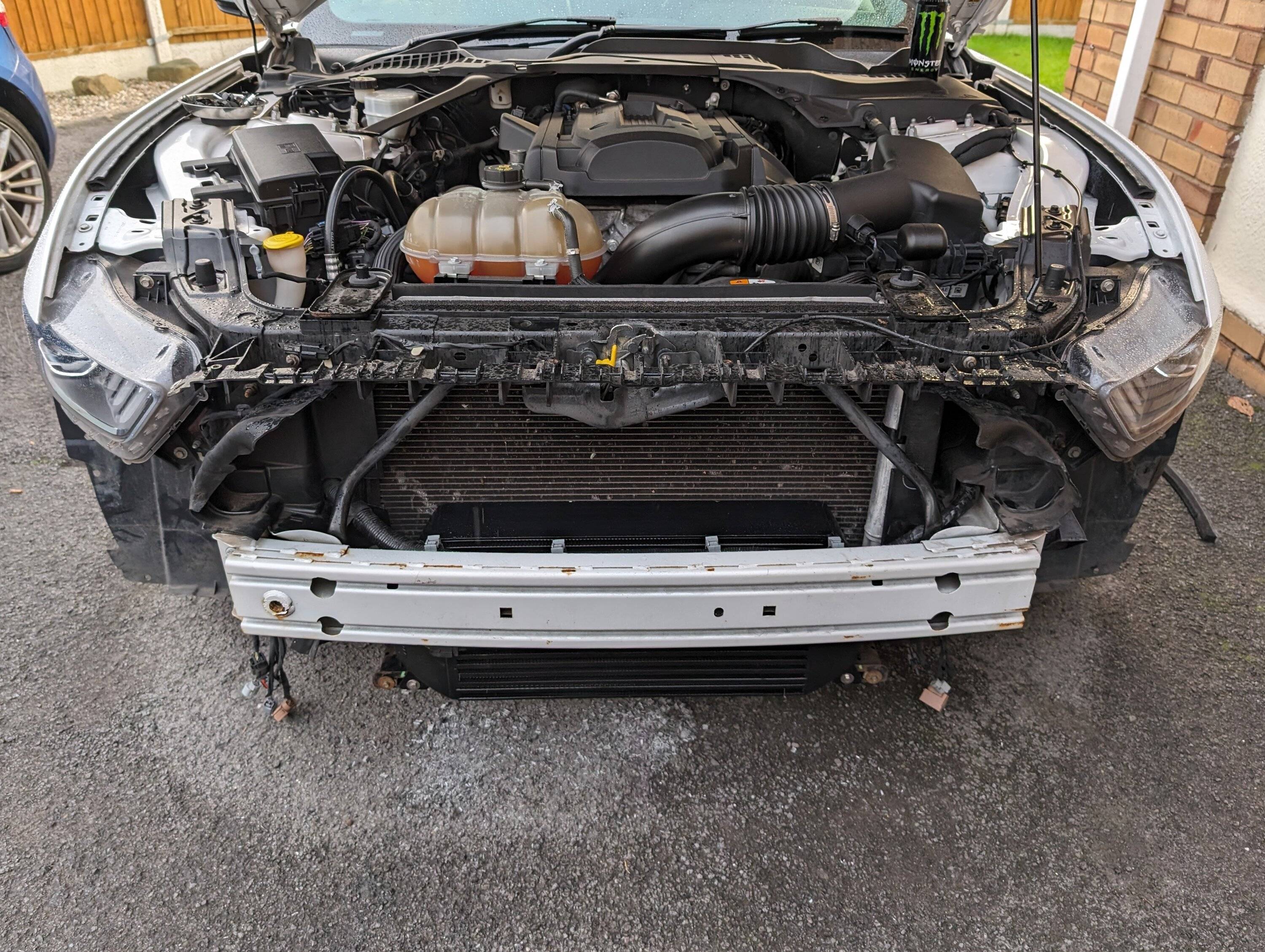

Upgraded mine yesterday, although being in the UK I used a company based here called Airtec. Their design was taller and went Infront of the AC condenser.
Hey @Dannyh1991! This is exactly the IC I'm considering for mine and I haven't found anyone other than yourself who has installed it previously. What's your feedback on it so far? Have you had any power runs since installing it? TIA!
