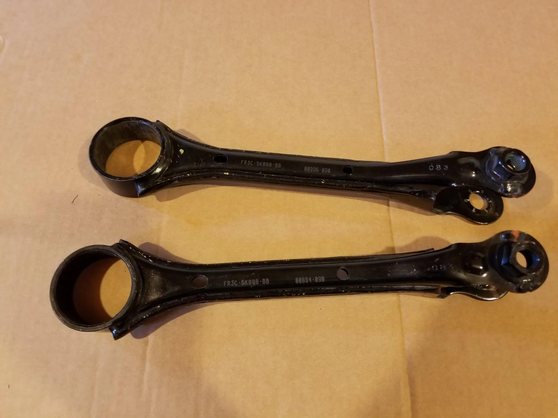

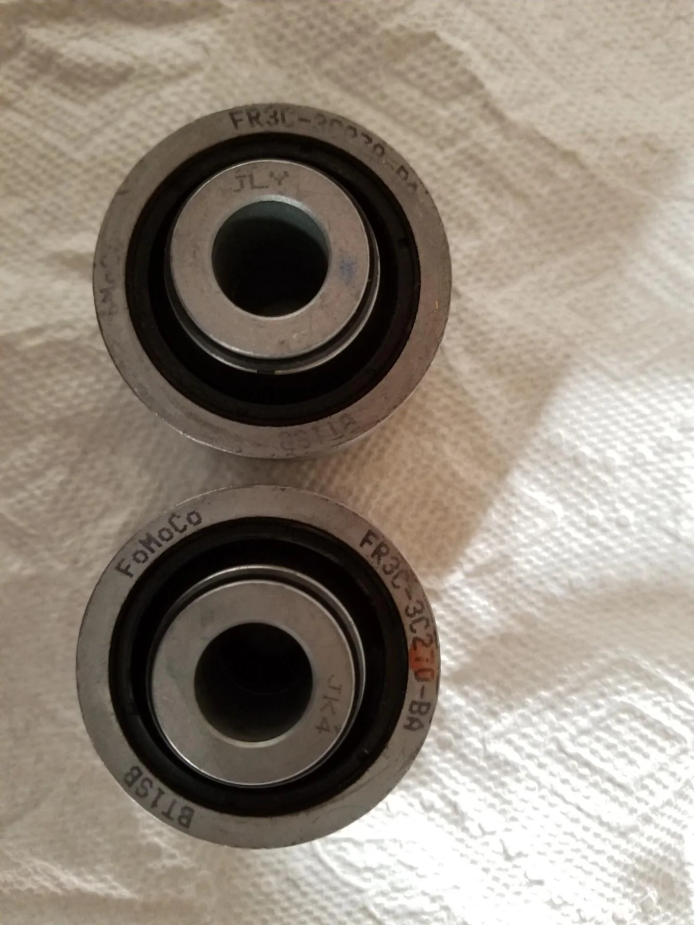

Calling all who have installed this part or had it installed I just have a few questions. I had an extra set of toe links and pressed the bearings out of the link and am going to use these in the knuckle since the bearings are the same bearings/part #'s.
Did you notice any negatives to this such as NVH, clunking or any other undesirable things?
What positives did you notice after these installed?
Is a rear toe re-alignment needed after installing the bearing?
If you had them installed in a shop what was the labour charge?
Any other info/tidbits about these let me know

Zero NVH or clunking after installing mine. Yes I would highly recommend an alignment after and the biggest benefit is limiting rear toe change during hard acceleration. There is also a nice lateral stiffness in hard cornering.

No negatives. Static toe change will be negligible, no alignment needed.
LCA bearing will have a greater impact on performance, however.

Everything as stated above especially about the LCA bearing. You might have to pull the flanges out a bit as the bearing is wider than the sock bushing. Not a big deal.
