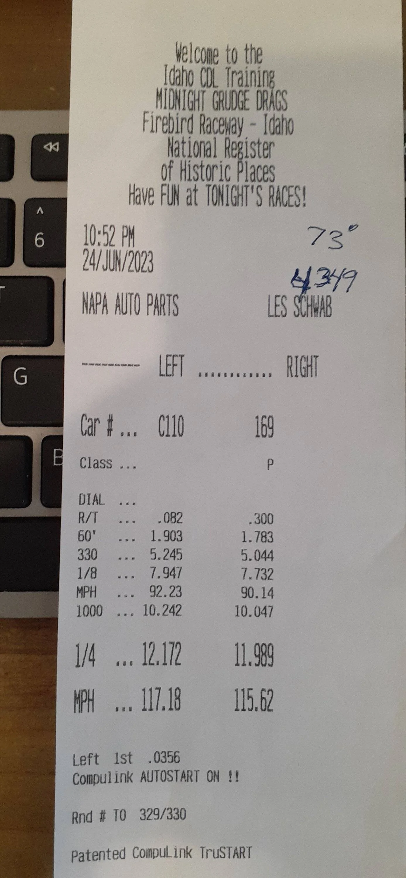

I've been trying to dual-purpose my car between drag and autox, and its time to pick a side. After winning last week's bracket event, I've got a serious bug to take it to the next level of drag racing.

I am launching very soft, maybe 1k max. Shifts 1 to 2 the DRs have no problem, I still am getting some very slight hop and spin from 2-3. I'm also feeling alot of instability at high speeds(not related to the radials). I am consistently seeing 12.2 at 115mph 1.95 60' at 4600 density altitude, and will be up to 5700-6200 the coming months. Again, consistency is priority over ET, but would love to start seeing 11s.

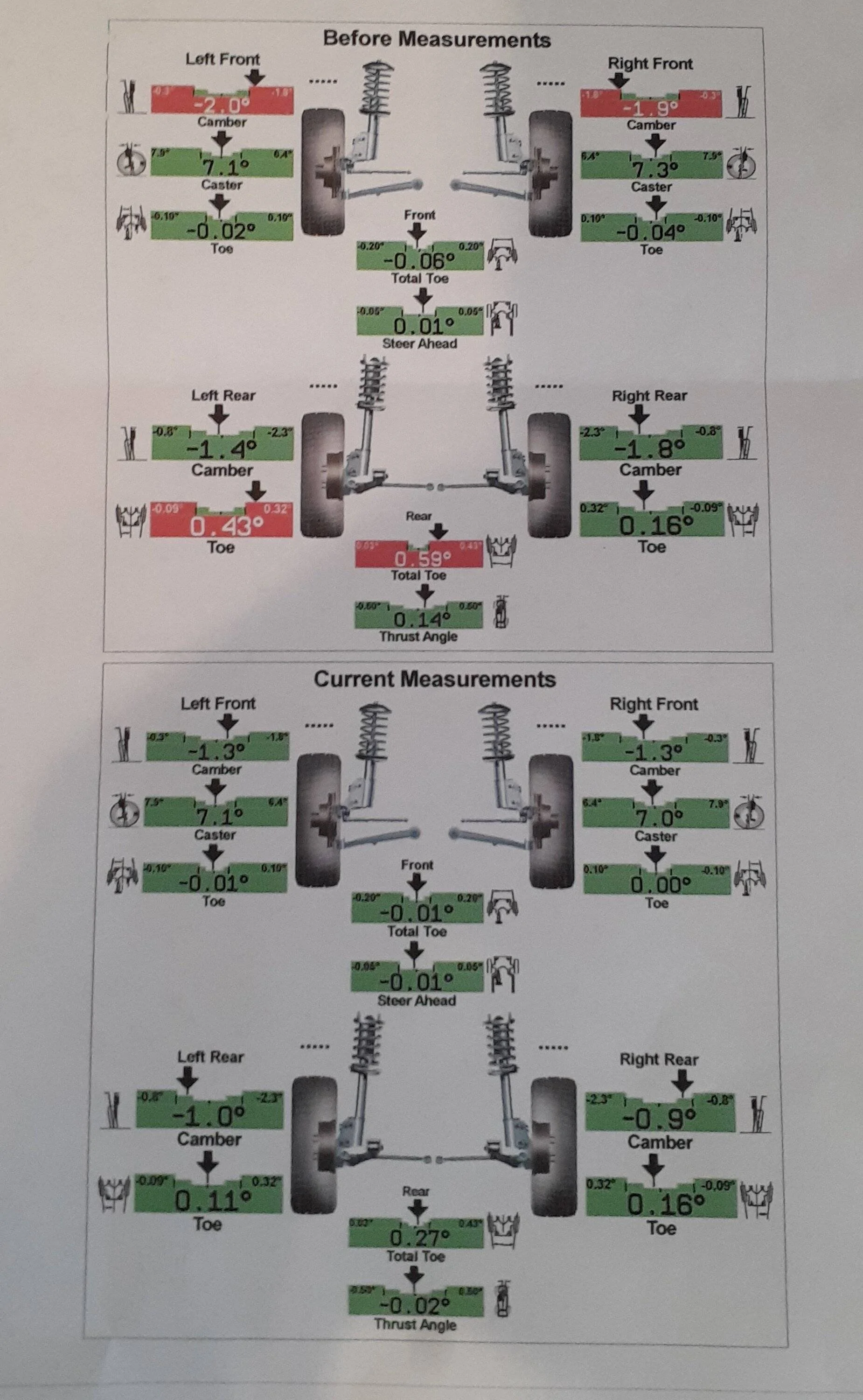

Put the 305R’s at 16.5psi cold…
Get rear camber between -.3 to -.6°
Get a good 2nd gear 5-6 second burnout until you see a little smoke from both sides. Stage it, and footbrake it to 1700-1900rpm. Launch in Drive and leave it. Don’t worry about the suspension unless you get wheelhop. Stock suspension and proper rear camber, and a good footbrake launch will get you 1.65-1.6.9’s all day easy.
You shouldn’t be getting any hop on a 10R80/3.15 combo. Your camber and tire pressure needs to be where I mentioned for max stability and footprint.

Alright well my new setup is in sig, I got a PB last night but not much. I still have more time to shave off with both wheel spin and RPM launch.
I'm still getting spin 1 to 2 shift and wants to kick out to the left, perhaps due to askew alignment or might not be an issue once I get traction figured out.

Next, I have more rear camber than you and I'm running a shorter, narrower tire than you and cutting 1.65-1.68 60' times (stock springs and dampeners) so the traction should be there for you. What is your cold tire pressure set to before you line up in the rear?
As soon as you finish your pass, park in the pits and check your rear tire tread. You should be able to see a contact line towards the outer edge of the tires tread. That will tell you have much of your tire is making contact with the ground. If that line is inside the width of the tread, you need to start with a lower air pressure before burnout.
