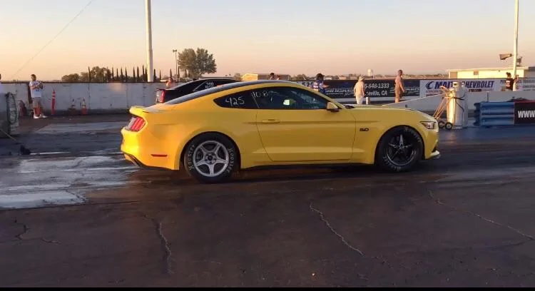

I run 99-04 17x9 10th anniversary wheels (LMR) with 28" hoosiers. Lethal has a good deal on the tires with their discount code (LP2016).
Didn't want to go all out with wheels/tires on this car like I did the 15. Just enough to play now and then. Plus the 10th anni. wheels are pretty close looking to my F14's :)
