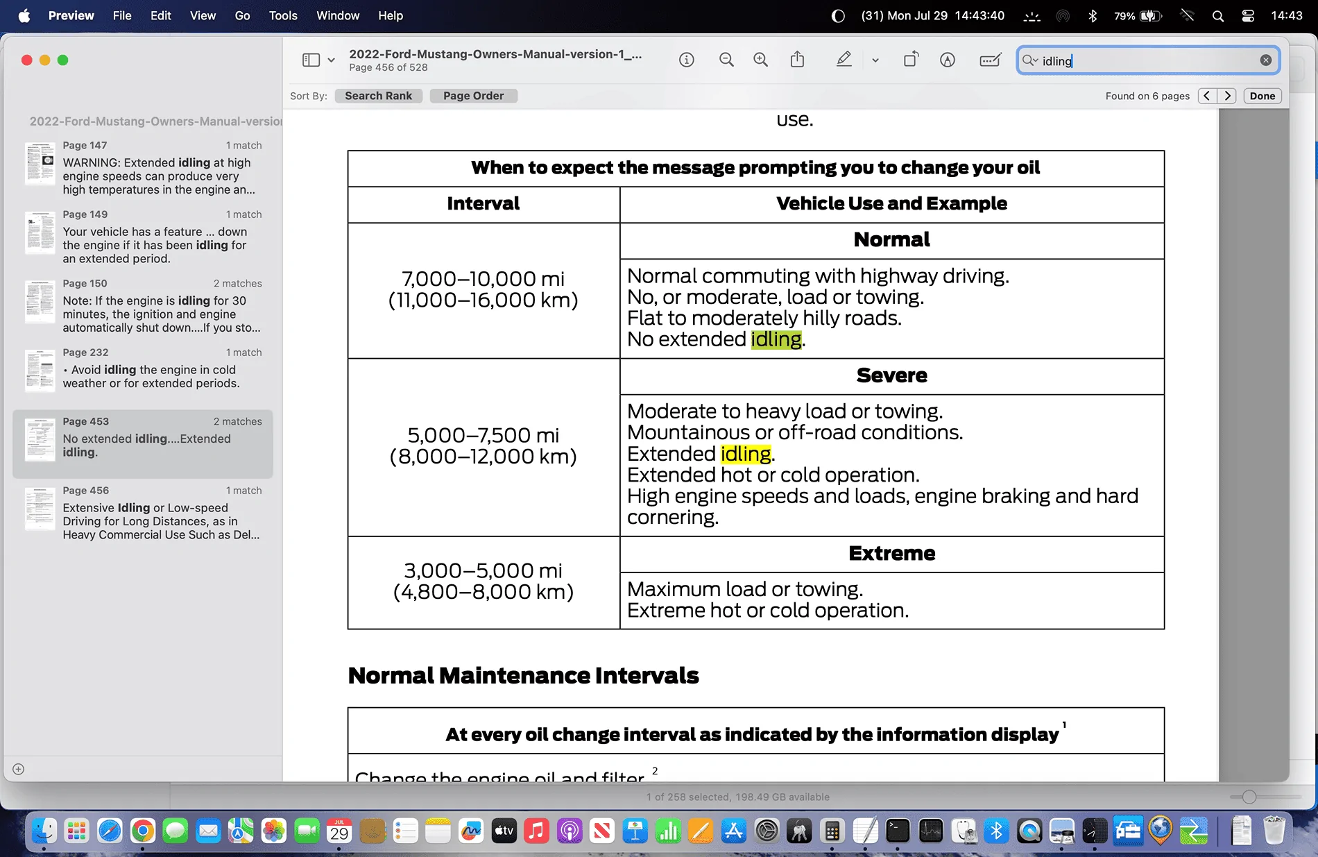

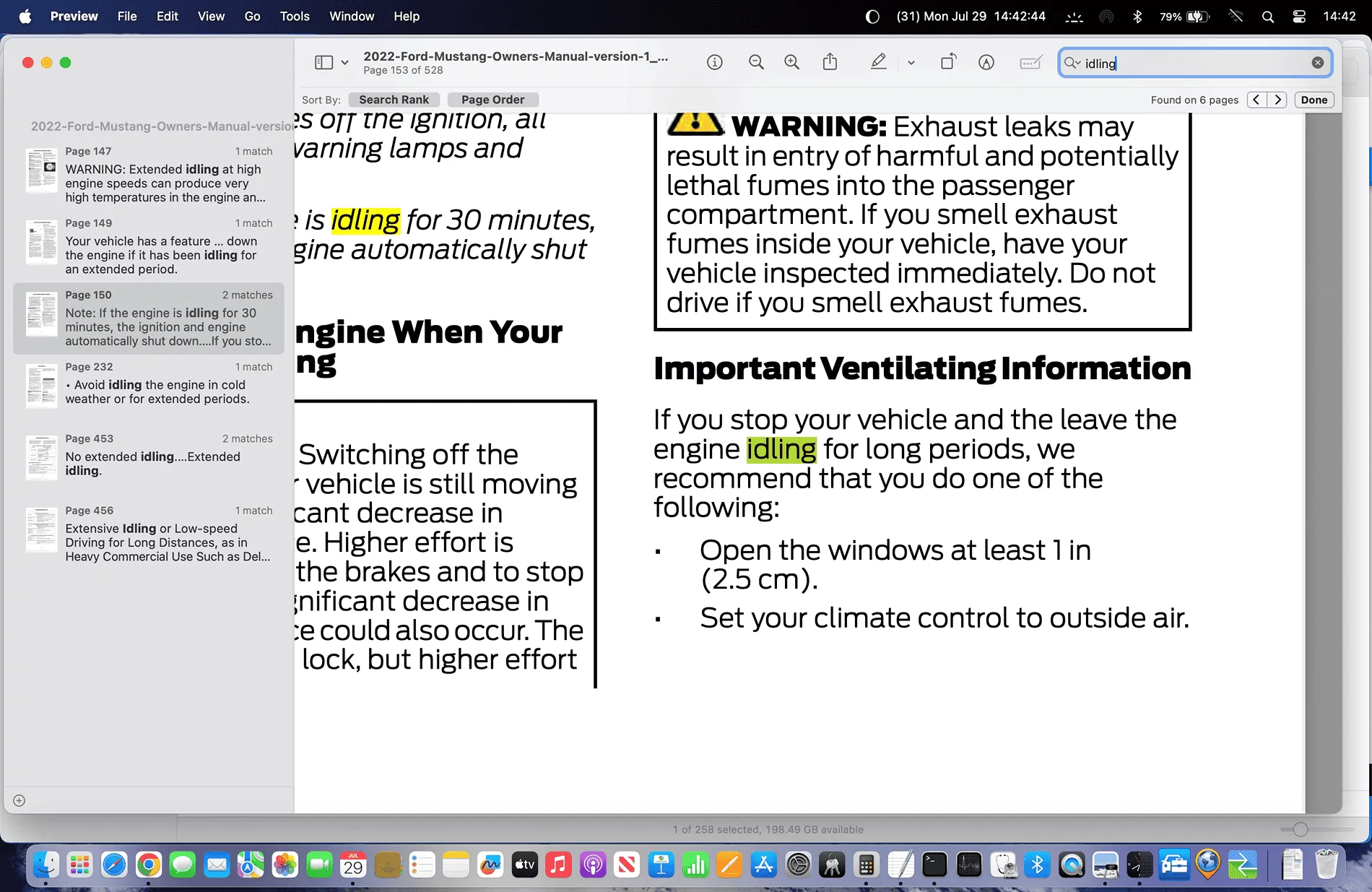

If you had to idle for hours would you guys change your oil or perform other maintenance afterwards?
I googled through the '22 Owners Manual for any specifics. Attached are two excerpts of interest.

^ That's still vague as to what they mean by "extended idling".

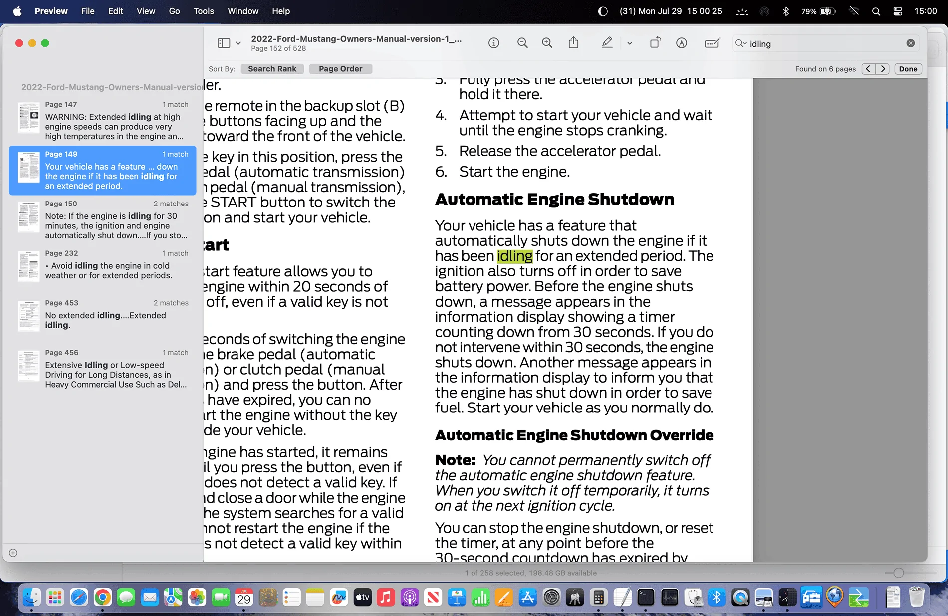

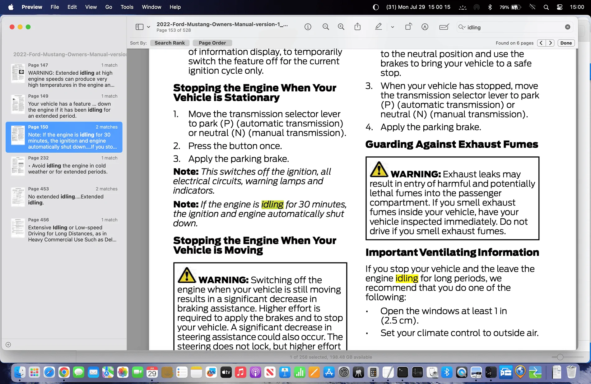

Re-reading other sections, 30 minutes.
The auto-shutdown feature cannot be disabled, but it can be delayed or interrupted.
