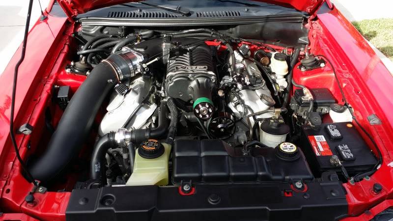

To touch on what I said above, here is one of my favorite cars I have owned. On this Cobra I had, I logged IAT2 religiously, as I was REALLY pushing this thing hard.
The reason I have a hard time with the temps you are mentioning is because of all the work and effort and data I had with this car, and it didn't even see those Ambient vs IAT2 deltas. As you may know, these systems were VERY inefficient compared to the newer stuff.
