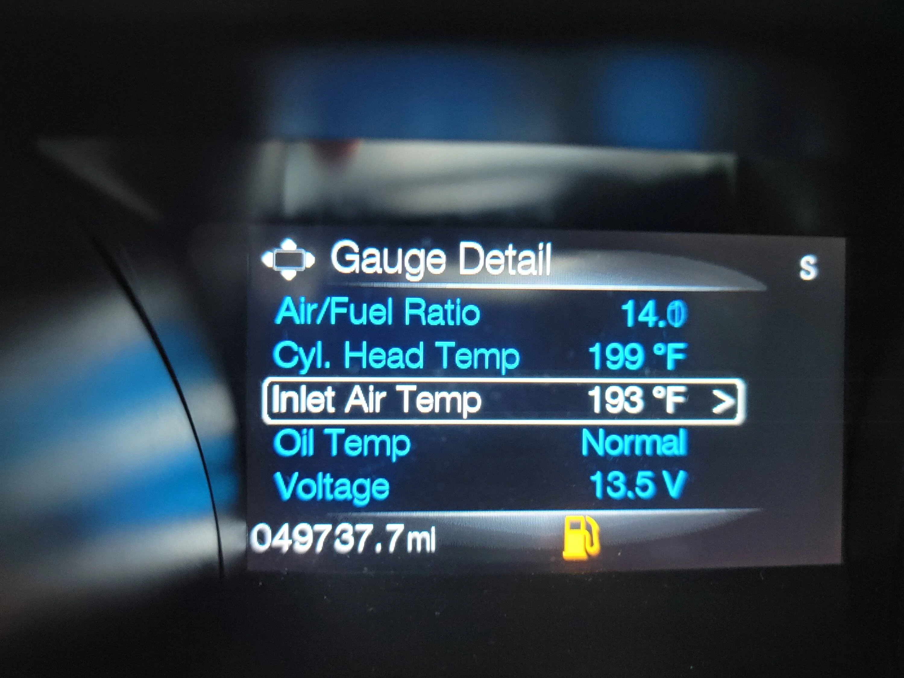

This was on the highway cruising at 80mph. Glad I noticed it immediately and pulled off the next exit.

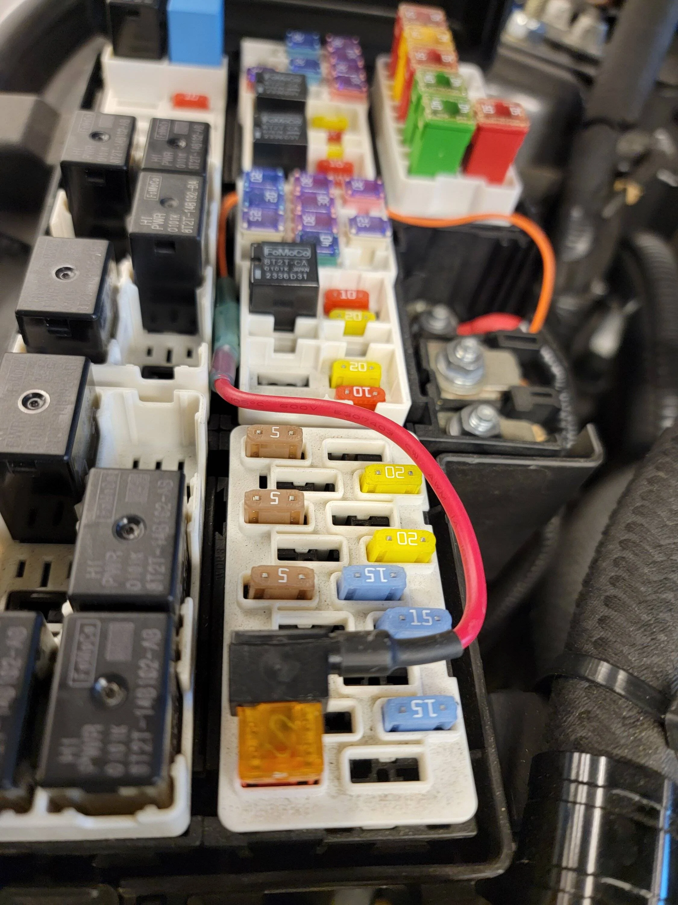

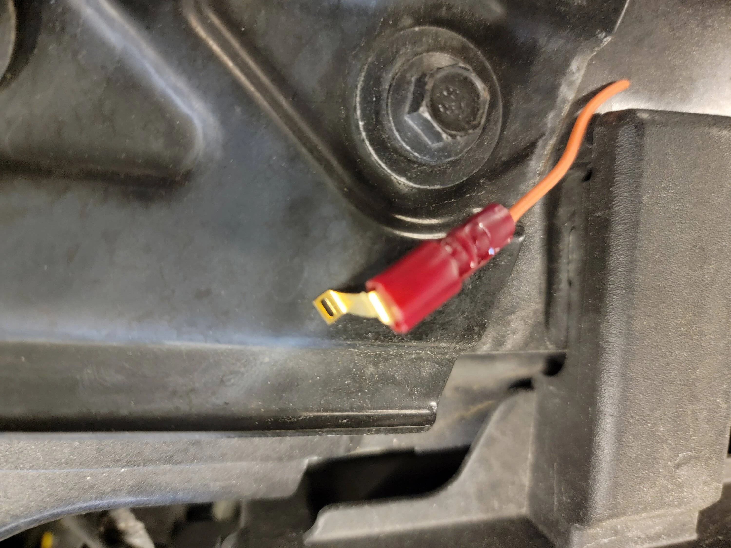

I immediately thought my heat exchanger pump took a $hit. But when I popped open the hood I could hear my VMP heat exchanger fans going on and off at random. I found the 5 amp fuse tap ( comes with the VMP Odin kit) had high resistance b/c the spade (not sure what to call it) has slowly opened up over time casuing a loose connection on 1 of the 5 Amp fuse legs

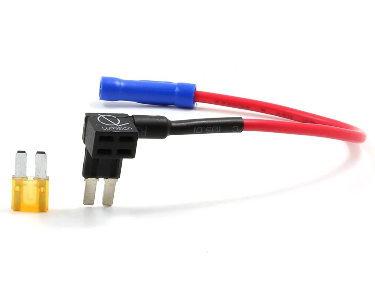

So it was an easy fix thankfully and I added 1 of those "add a circuit" fuse taps and now my fans and pump are working again. I highly recommend anyone with VMP Odin set up to do the same.

Does the Odin kit tap in somewhere that allows you to use IAT1 to monitor post blower temps? I have to watch IAT2 for post blower and the dash IAT temps for pre-blower.
Just wondering, but yeah, those temps are toasty for sure.

My mistake, this is not IAT1 but true IAT2 Temps inside the blower
