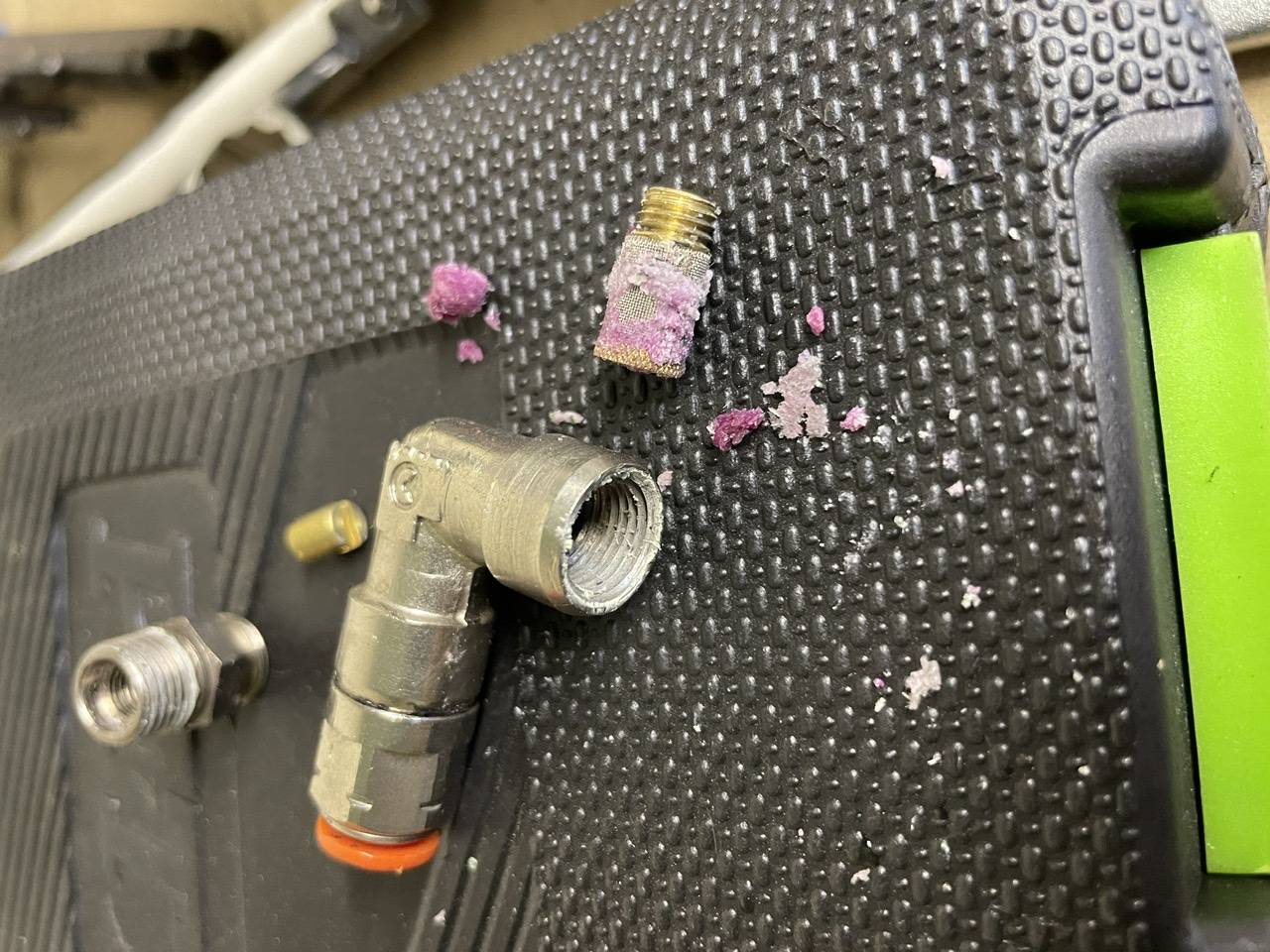

Also, I really like meth. But watch out when you run the colored stuff it can clog your nozzles. Was wondering why mine wasn't spraying...
What’s the colored stuff? Boost juice?
yea, the residue from the dye or whatever
only takes a few minutes to pull your jets and hit them with some carb cleaner, no big deal just something to keep in mind
That can cost you an engine right there.
