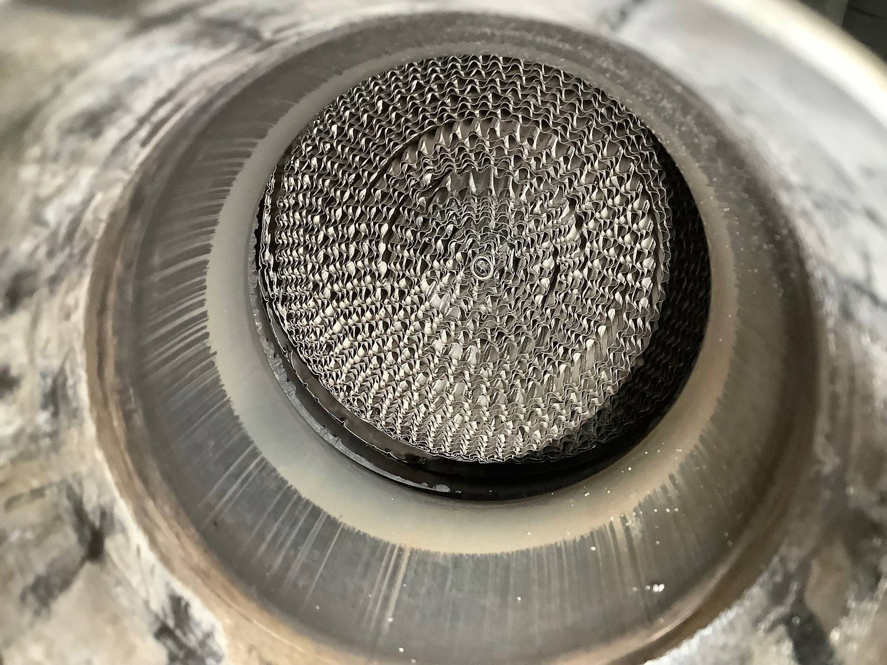

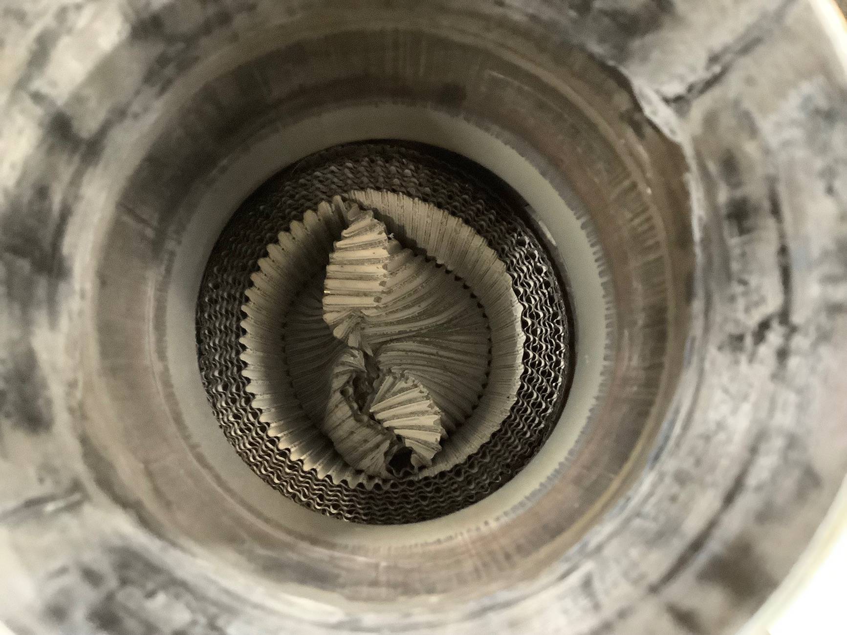

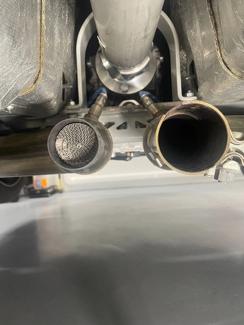

Blown cats is a real thing. It happened to me with catted LTHs and E85. My power adder of choice was nitrous. Here’s the result of that failure (sound clip included).
I was planning on using green cats if I have to go headers. I’ll need to do some research on that one. I’d prefer to not go catless if possible, but if that’s needed, then so be it.
I believe there are some very expensive cats on the market that cost something like $4K-$5K. I forget what the brand is, but they’re out there. FYI, at the time of my failure, I want to say I had about 7K miles on my car.
I think factory GT cats are at risk too when boosted. Maybe consider sourcing some GT500 cats. If they hold up on the 500, they may work fine for you with boost.
