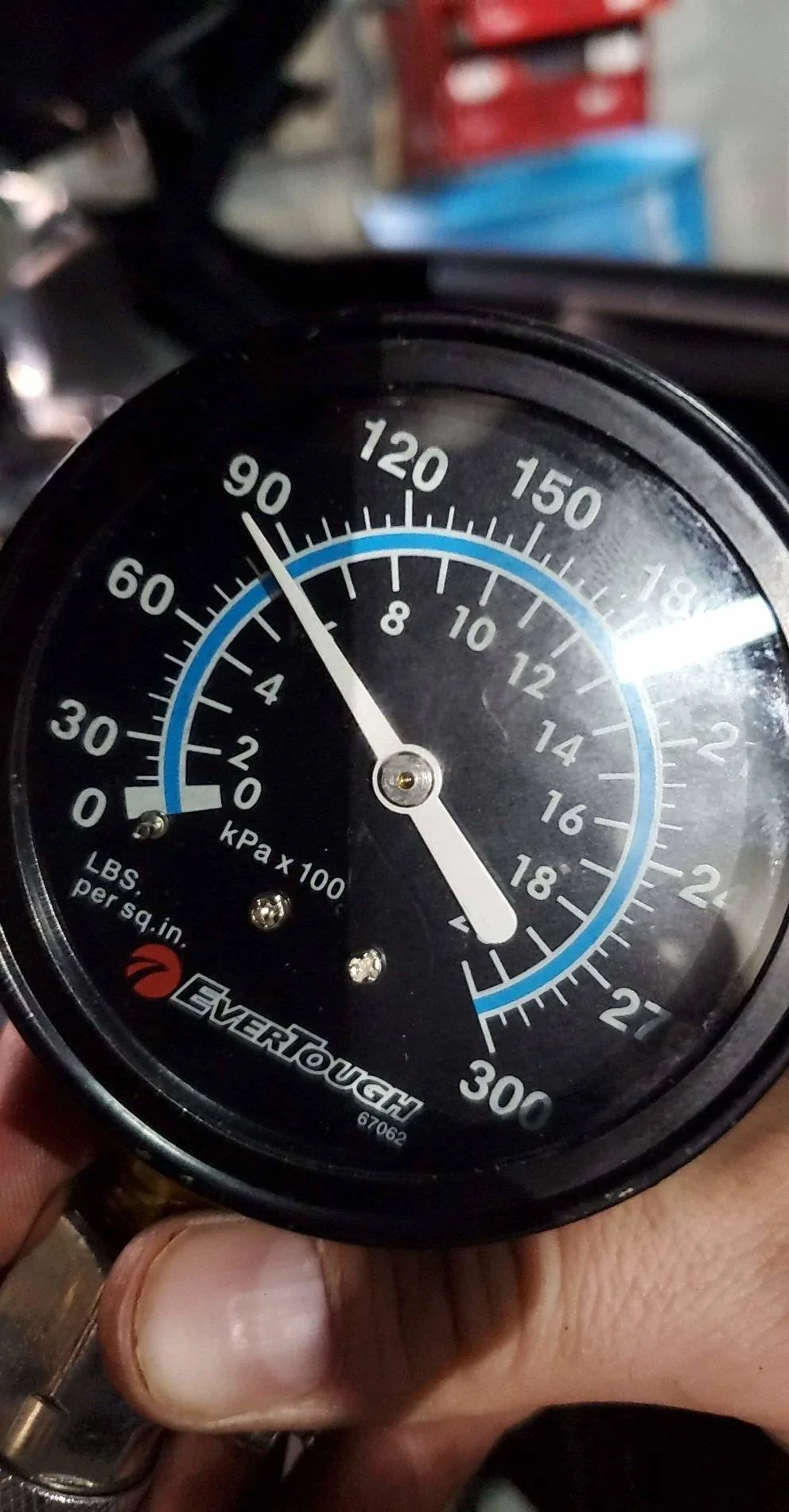

Update is she gone. RIP.
Just finished the test. #7 toast. 85 psi.
Bitter sweet. Happened right in prime car season.
I guess its time for a built short block, fuel and all the boost. ‍♂

At least get the head off and check #7 for damage to the wall, and the head. It may not be a total loss.
