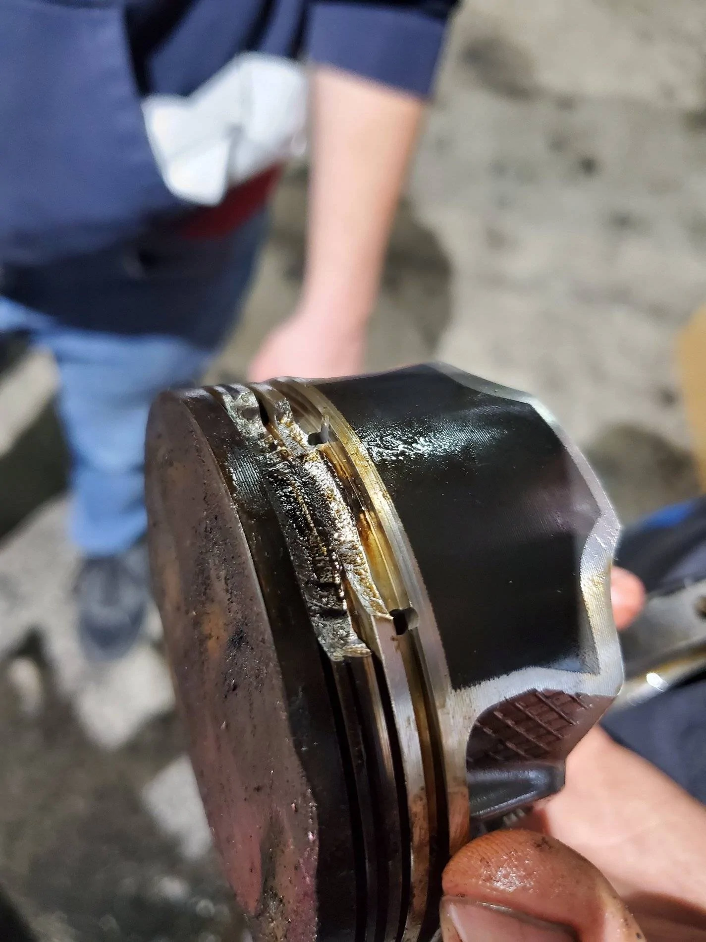

put in a cylinder head cooling mod. It will keep 7/8 from getting hot. The water doesn’t flow around 7/8 very well so the water gets hotter and hotter Until boom. you’ll never know there’s an issue because the cylinder head temperature sensor is on the other cylinder head
Nope not corrected. The blocks have the same basic design Flaw all of the cooling system enters and exists the engine through the front of the engine, Nothing in the back. As the coolant flows up through the block and out the heads it is coming in from the front and out from the front.Please explain.
Got a write up on it?
I thought this was corrected on Gen 2s. I know it was an issue on Gen 1s.

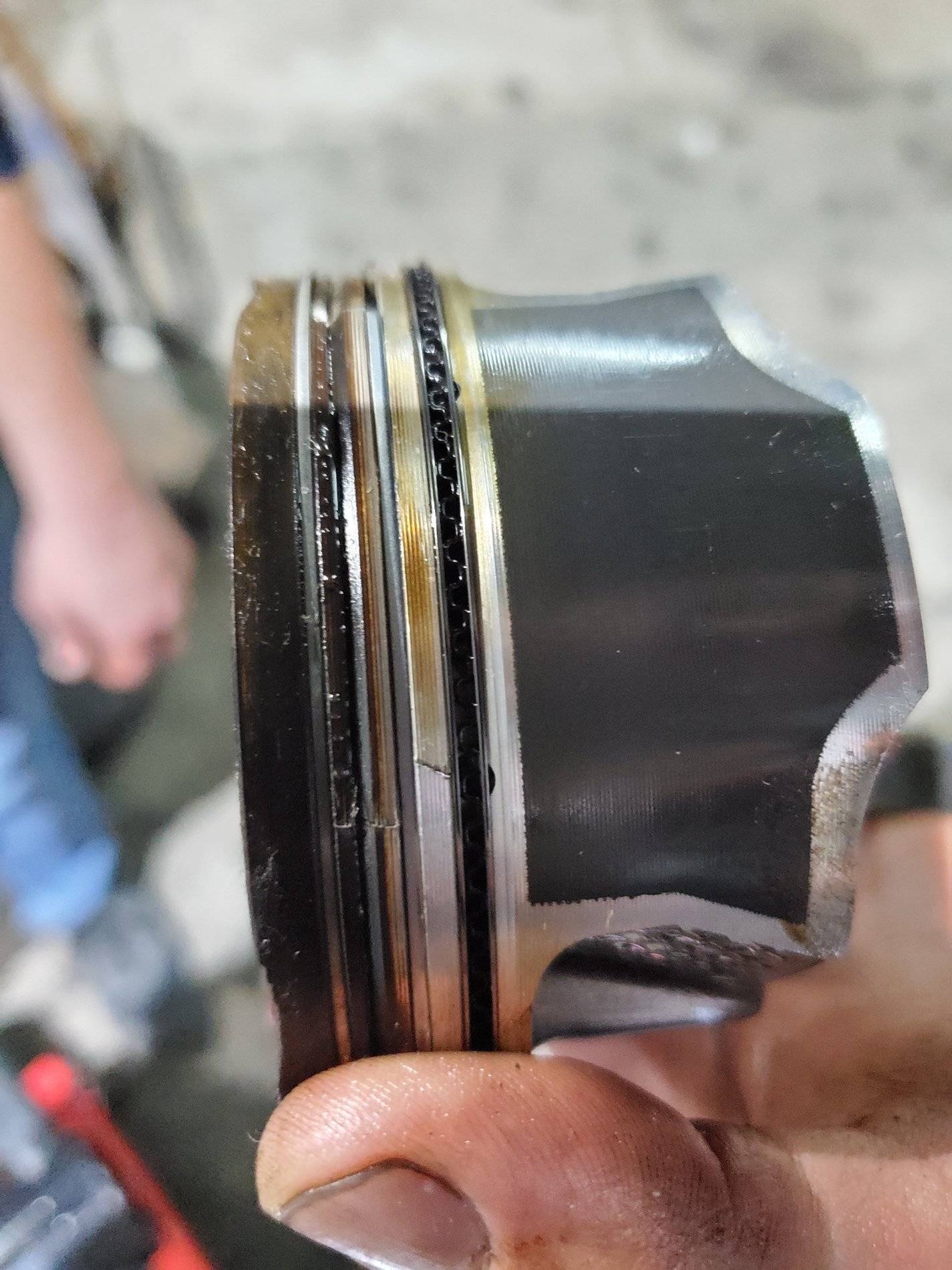

Heat. The rings expand all the way until the ring end gap disappears and the ends touch and push out against the cylinder walls and break the pistonWhat was the reason for failure?
He’s probably pushing high hp on his car then.Heat. The rings expand all the way until the ring end gap disappears and the ends touch and push out against the cylinder walls and break the piston
Heat from what?Heat. The rings expand all the way until the ring end gap disappears and the ends touch and push out against the cylinder walls and break the piston
Combustion. Coyote has a problem removing heat from 7/8 because of water flow. It normally happens when you do a lick/hit/pull/race then turn around and do another back to backHeat from what?
