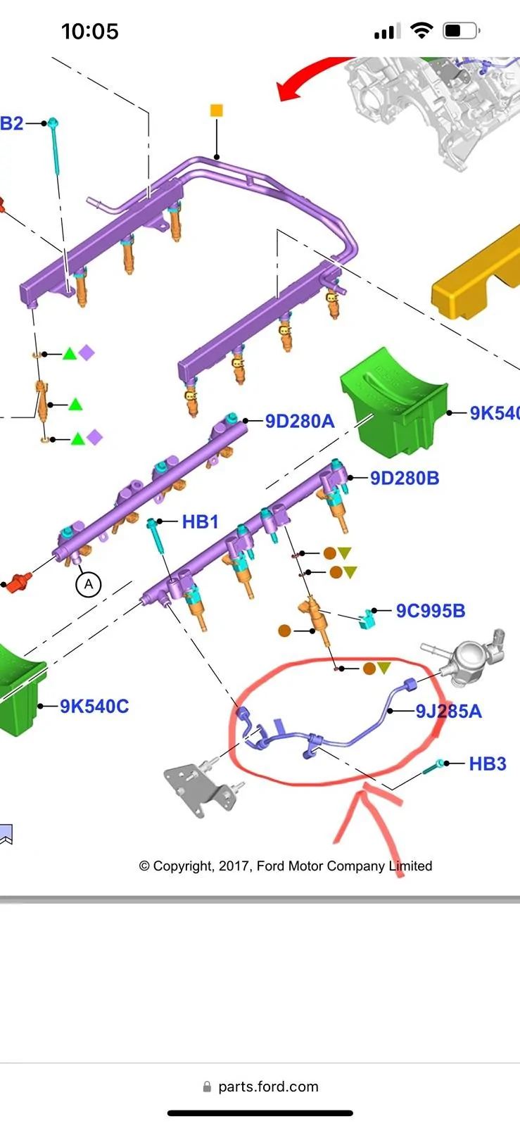

Yeah that is absolutely right. The line I’m looking at is $19 so it would be foolish of me to ignore it. Not sure if this is the same line you were lookin at replacing but here is the pic

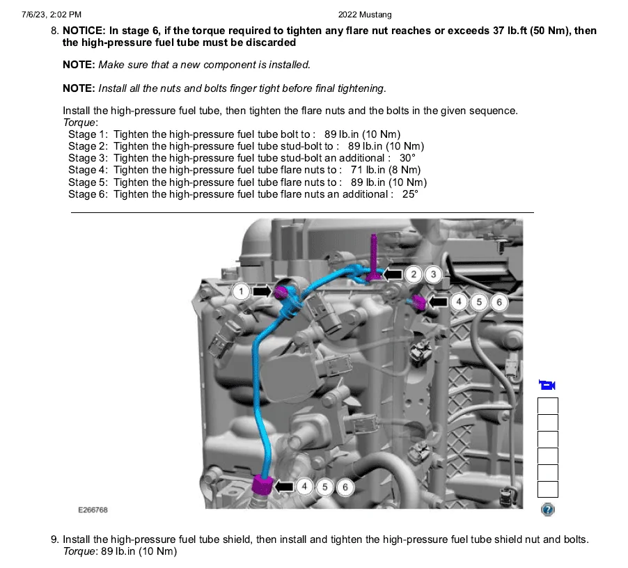

Has anyone reused the high psi fuel line on a gen 3 or did you have to replace it per ford ?
I re-used it. no leaks. My car only had maybe 2000 miles on it when I removed the valve covers to do the crank sprocket/OPG's. less is more when torquing these lines down. Use this 👇torque sequence when re-installing it. For sure, if you damage the flare on either end (even a little scratch) replace it.
