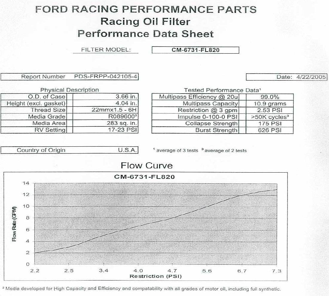

ill use this to explain why i suggested it to stoli and answer your question.
The amsoil eao filters are very nice but ive never found any performance testing of how their filters flow (frpp delta p test pictured below) and at what psi they go into bypass. The ford racing 820 is your best choice followed by the fram ultra xg2. As far as the purolator id use the One over the boss. Ive seen some meh construction once cut open. In regards to Ones ive seen more tearing with media on used cut open for visual inspection. Typically this is on 10k or more plus oil changes. Since its been happening i cant in good conscious tell anyone to use Purolator. The tearing has happened on other filters they make as well.
The the frpp filter has its bypass located at the base by the threads. Which is how all ford OE filters are and is important. The filters designed this way goes into bypass, the bypassing oil is diverted before the filter element. On most aftermarket filters the bypass is in the bottom of the filter and the oil flows over/across the dirty side of the filter element before it is diverted. This may cause previously filtered dirt and debris that has built up to be pulled off the filter element and flowed into the oil passages of the motor.
From what i know amsoil is designed with the bypass at the top, not the base. I also have found zero flow testing, bypass psi or its psi burst strength. So if you're to get a filter like that with its bypass located opposite of OE get the fram ultra xg2 is flows damn near what ford racing filter is, is readily available at walmart (10 dollars), cheaper and you pay no shipping. It doesnt have as high of a bypass or burst strength its the only other filter id use other than maybe an M1 extended performance or OEM 820 filter
I at least know of all the xg2 specs and is also a 15k filter like EAO's. If you must use an Amsoil filter use Eao11. 820 filter styles flow more than the fl500 style. The ford racing can be used for 15k changes but itd cut it open after the first filter to make sure it held up well. Ive never done it. My mustangs dont see more than 3500 a year.

I want to break one more thing down. Some may wonder why not just use the OEM 820 filter?
A big thing it has over the standard 820 filter is that it has a much higher bypass rating. I dont know about everyone here but id rather filter my oil and the vast majority of the time. I can go 1/2 or 3/4 throttle and not have to give up being able to still filter the oil unlike the standard pressure 820 and still supply the oil flow required. Cars at cold start, filters goes into bypass as well, not with the Frpp though. Another strong reason for the frpp oil filter is its burst strength for those doing any racing.
An fl820s filter is not a high mileage filter. I wouldnt trust it not to tear. I wouldnt trust it not to tear after one year of being soaked in oil even if driven less than 5k a year with amsoil.
For those that dont care about any of the following stick with the fl820s. A filter living well over half its life in bypass in a performance orientated car thats driven that way. Those that dont care about burst strength. Those that dont care about any of the prior and dont go oil changes longer then 5k every 6 months
