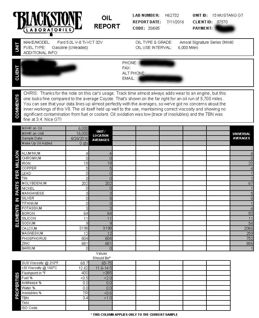

This is with ~200 miles of track time at Circuit of the Americas being the first mileage on the sample, and the rest is daily driving here in Texas. I know some folks have been waiting for a sample of the new 0W40 SS. I ran this car pretty hard at COTA, probably about as hard as you can run this car considering how fast and hard that track is on cars. I think 0w40 was perfectly up to the task according to the results.
Thanks for sharing, I agree with you that COTA is probably one of the toughest tracks I have run on, my oil temp is just off the yellow most of the time at this track.
Good to know the oil is good, what oil was it? I'm using Quaker State 5w-30 for track days
