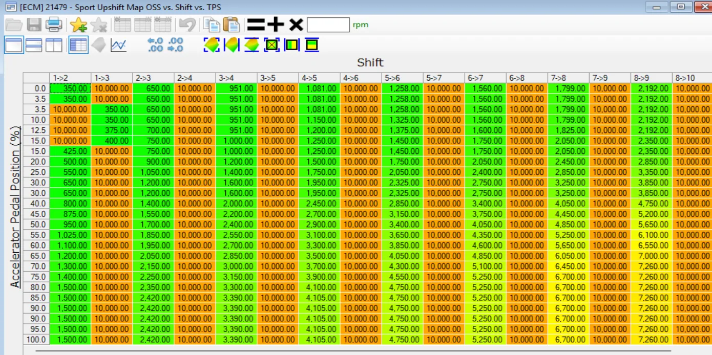

> In sport mode, skip shift is generally disabled if you leave the stock impossible values in the skip shift columns. 1->3 can be fully disabled by swapping the "10,000" values in 1->2 to the 2->3 columns and moving the 1->3 values back over. You can do the same for the other modes (like drive "base"). This is a screenshot of hpt but you can convert values over to pcmtec if you decide to go with it and don't know where to look. https://hpttotec.com/
*This is someone else's file and I don't think skip shift is ever enabled on sport mode stock but I may be wrong? Hopefully it's still helpful.

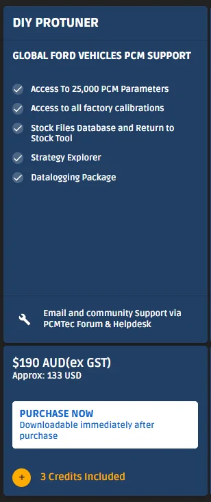

So if I wanted to go with PCMTEC, is this all I need to purchase?

I'm still confused as to what software I need to purchase for PCMTEC. Is it the thousand dollar version if I want to tune my transmission also?
No, the typical user only needs the ~$200 version to access engine and transmission. The transmission isn’t separate.
