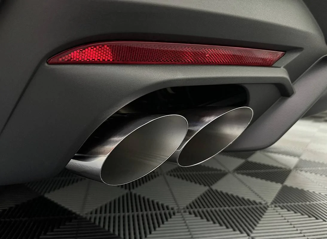

Ok guys, let’s talk about exhaust tips! I find this area of car care often gets forgotten. As in a guy or girl will spend plenty of time cleaning and shining the paint, making the wheels and tires perfect, and even making the engine bay clean enough to eat off……………..and often no one sees the engine bay. Yet all of this gets let down by a set of sooty, carbon-stained exhaust tips. It’s like furnishing you home with top notch appliances and comfortable furniture but then forgetting to paint the walls.
All this might sound super-anal, and I suppose it is when you think about it…………….see what I did there? But guess what, keeping your exhaust tips looking great is actually super simple and super easy.

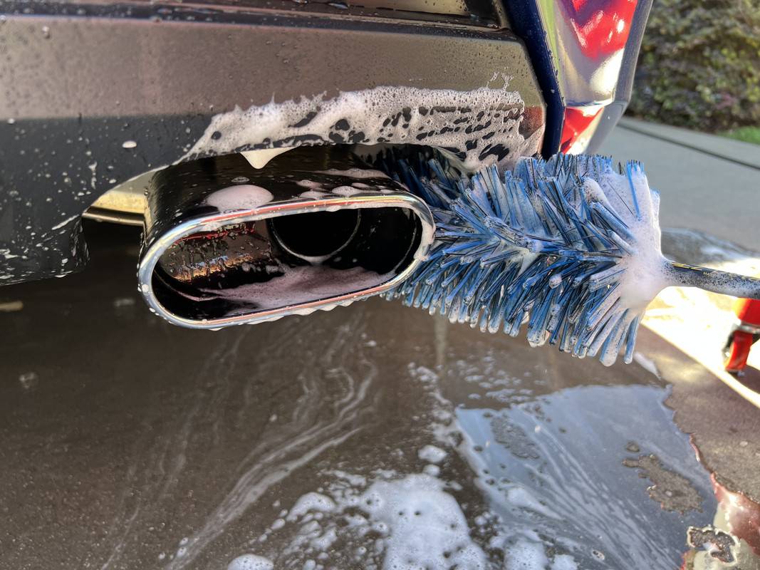

Exhaust Tip Cleaning –
Like anything detailing or cleaning related, a little and often instead of a lot, less often is the key here. Regular cleaning will prevent carbon from building up and baking into the finish of the tips. But if they have been let go, I have you covered with that as well……………..

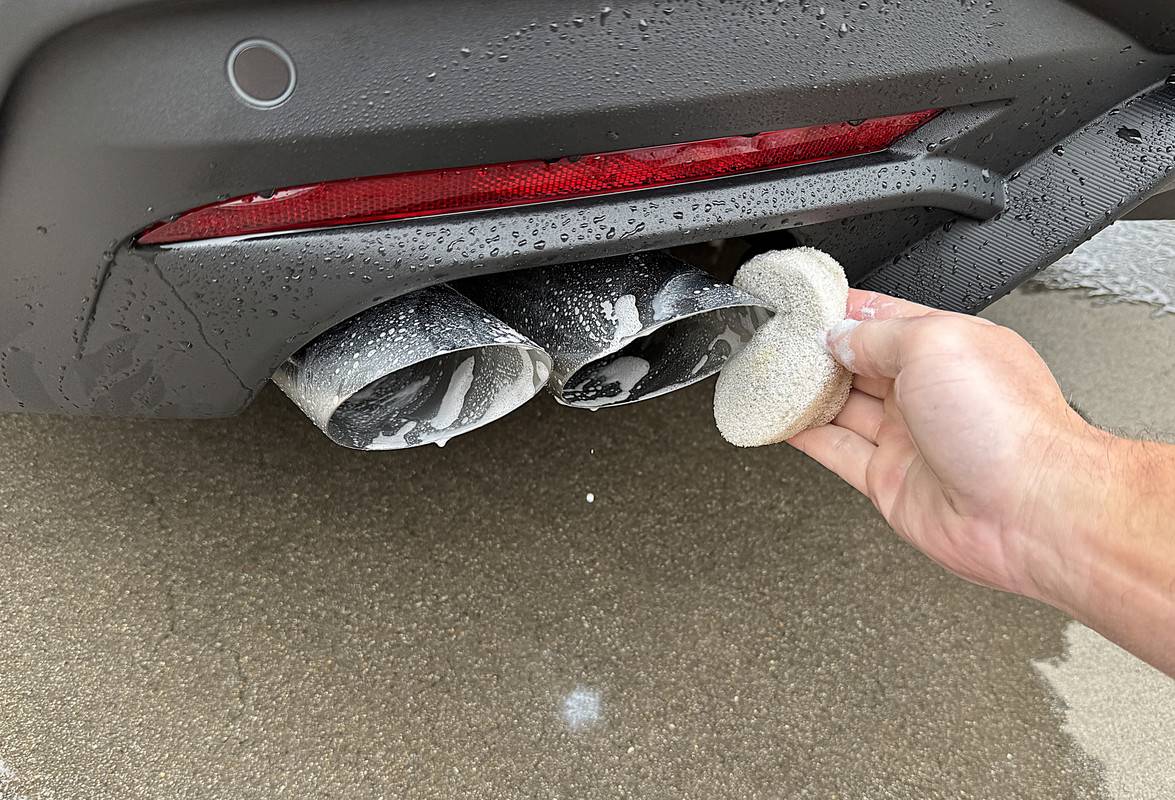

Maintenance Cleaning – Adding exhaust tips into your normal wheel cleaning routine only adds an extra 30 seconds to the process. In this case, I simply use a wheel brush or mitt with soapy water, but occasionally a little wheel cleaner can also be used. Rinse first, agitate, rinse.
Restorative Cleaning – In this instance, you will need to use wheel cleaners to break through the carbon. For heavily soiled tips, I start by applying a wheel cleaner, allow it to soak, then agitate with your brush or wash mitt. From here, you may need to go back in for second hit. Either an iron remover type or alkaline wheel cleaner can be used. If you have carbon stains, I’ve found Stoner’s Tarminator to be extremely effective at removing this, just apply to a towel and rub till the stain disappears.

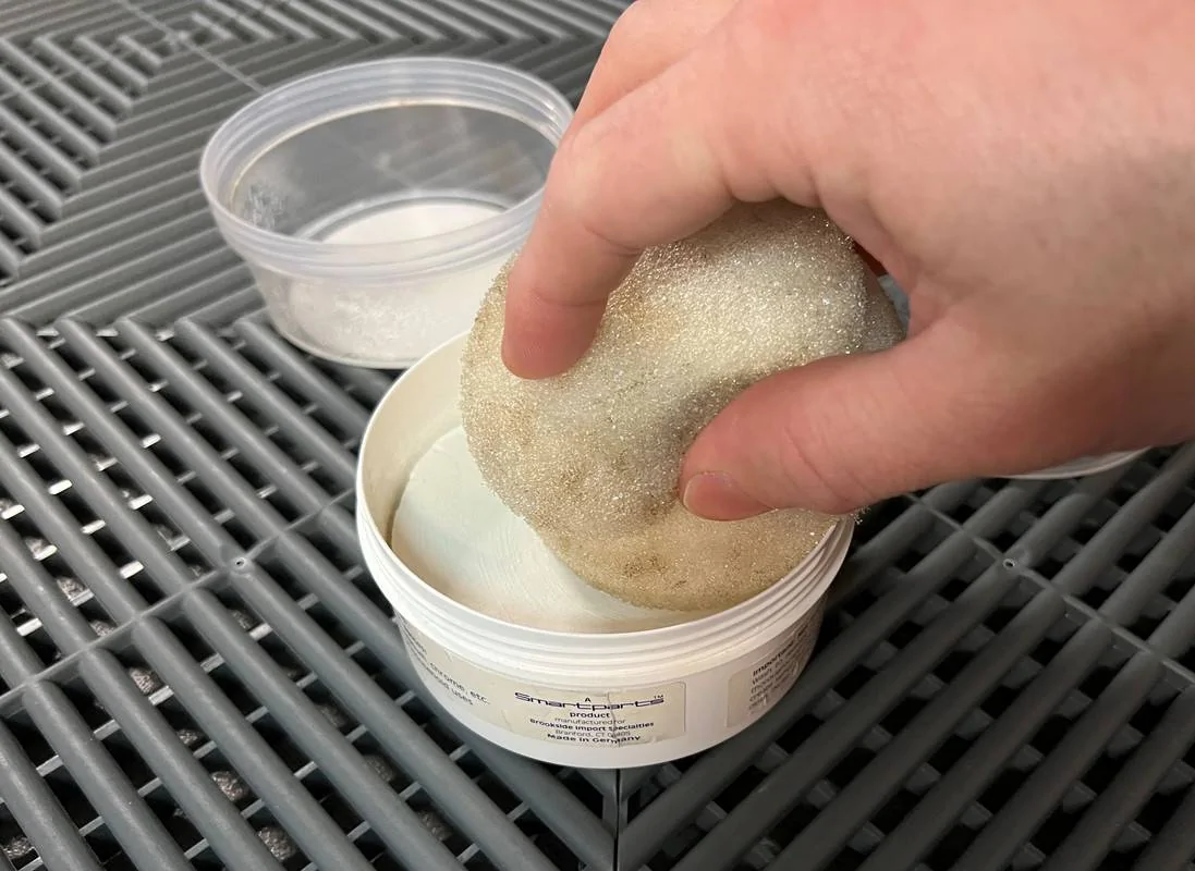

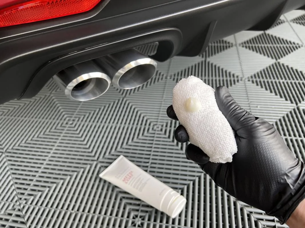

PS21 Polishing Soap – You could integrate this product into either of the two methods above and is something EVERY car guy or girl should have in their detailing arsenal. PS21 is an amazing maintenance polish for exhaust tips and other chrome surfaces, killing two birds with one stone. It’s a combined soap and polishing abrasive that you use to clean and polish in one step. Simply wet the supplied sponge, lather up the sponge with product, then scrub the exhaust tip. From here, simply rinse clean. Done.

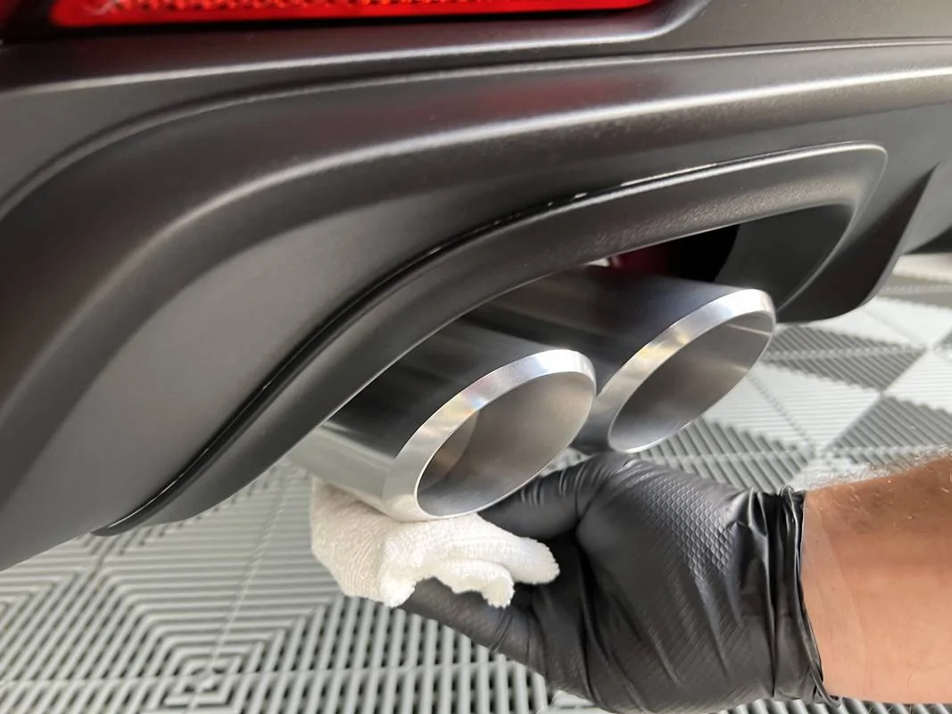

If you maintain your exhaust tips, you will unlikely ever need the following. I’d say most reading here would never need to do this unless you buy a used car that hasn’t been maintained. Restoring the finish can be extremely time consuming, and sometimes you may only achieve an improvement rather than perfection.

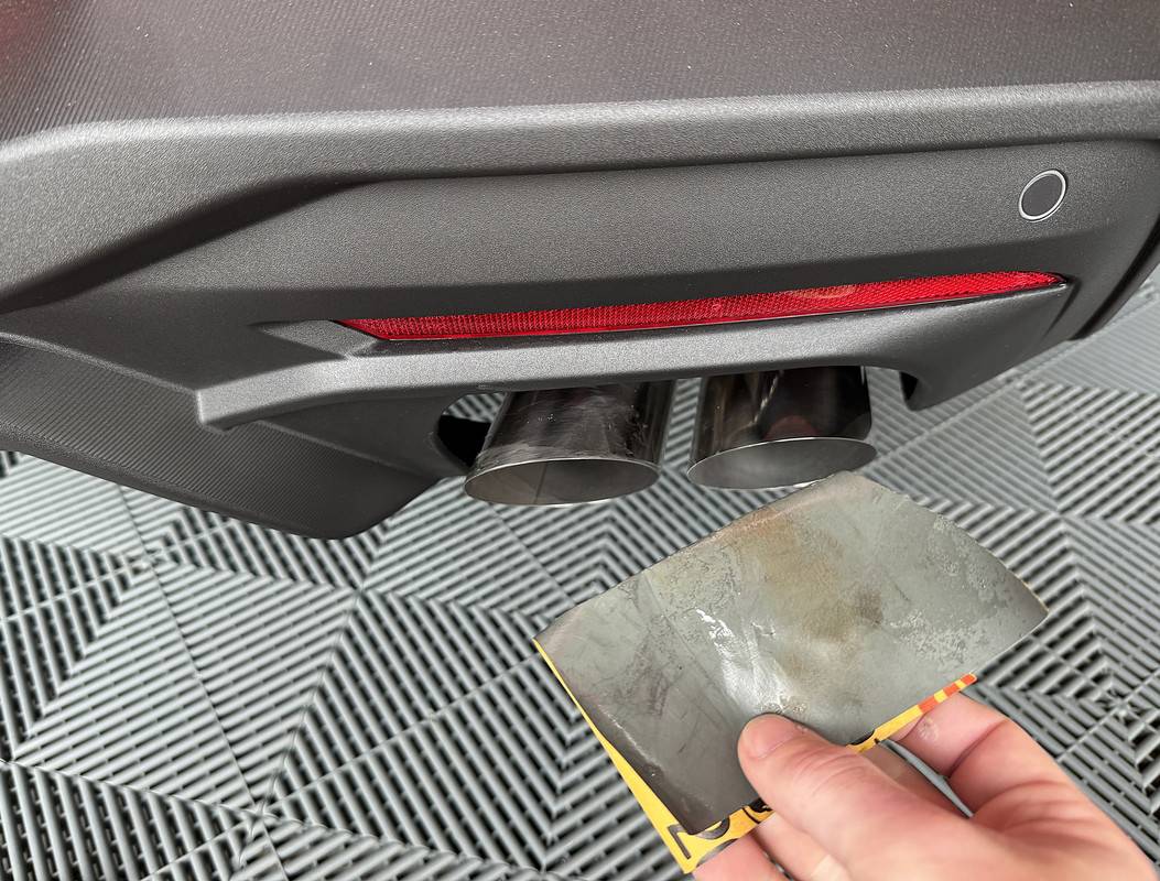

In detailing, the classic “start with the least aggressive method first” applies here too. So, start by cleaning as outlined above. I would also use P21S, this is a mild abrasive that could give you the result without resorting to more aggression. From here, you may need something like Tarminator or Koch Chemie Eulex to remove carbon stains and tar deposits.
If needed, from here you would progress to heavy metal polish such as Autosol or the classic Mother’s Mag & Aluminum polish. I’d team that with a towel or one even of those polishing cone drill attachments. If this doesn’t get you in the ballpark, you would then be progressing to steel wool or wet sanding, then followed by polishing to refine the finish.

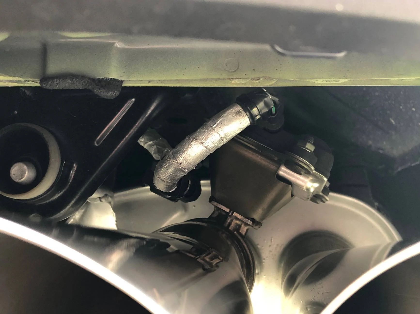

EXPORT Mustang's- These vehicles are sprayed with a black paint as underbody protection. This is applied without much care or attention and results in plenty of overspray. My new car was delivered with this stuff on visible sections of the exhaust tips. I found Koch Chemie Eulex removed this overspray, but any solvent should do it. Just make sure you rinse afterwards.

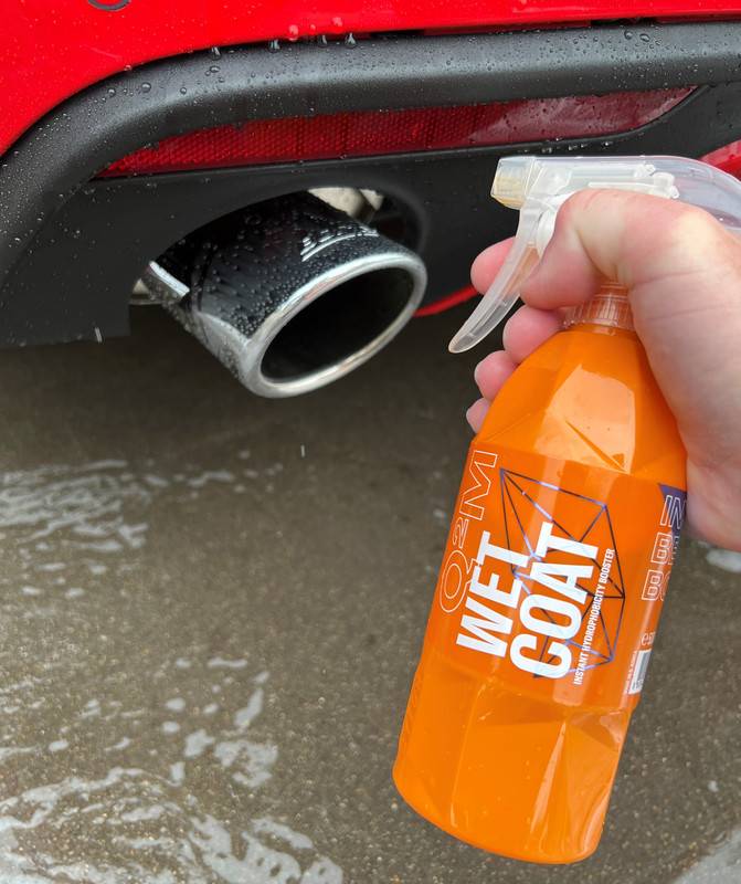

Gyeon Wet Coat / Capro Hydr02 – This will be the easiest solution here in that its water distributed and activated. Simply spray onto freshly cleaned and still wet exhaust tips, then rinse immediately with water. Done. This can also be used on wheels and will give you 4 – 6 weeks durability.
CARPRO HydrO2 Lite 500ml (17oz) Ready to Use Formula!
Gyeon Q2M WetCoat – Car Supplies Warehouse

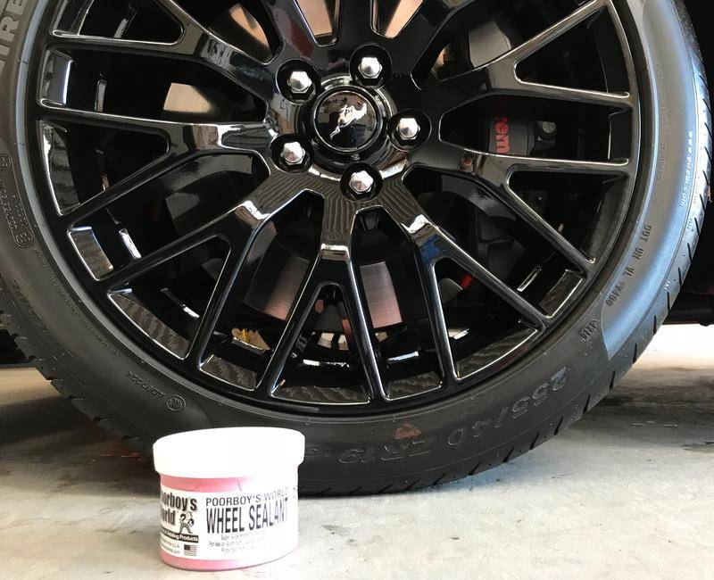

Poorboys Wheel Sealant / Mckee’s 37 Ceramic Wheel Sealant – This is like Metal Coat, but with reduced longevity, expect 3 – 6 months. Can be used on all exhaust tip finishes.

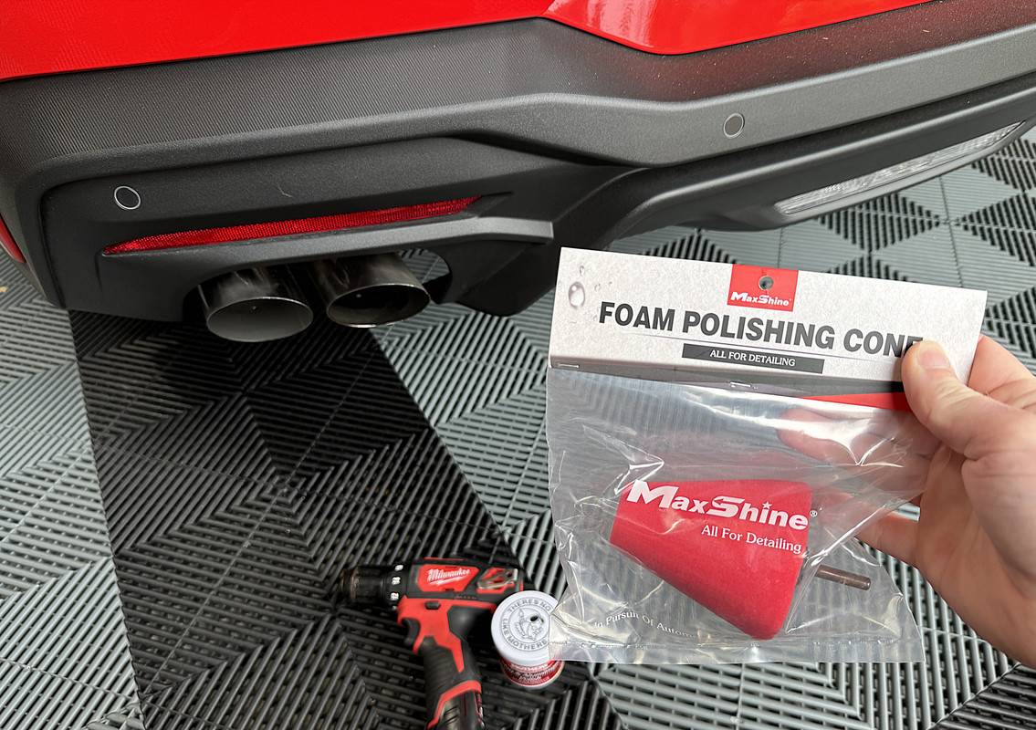

- Polishing Cones can be messy and probably best left for the inner surface rather than splattering polish around the body work.

- Wheel cleaning brushes like the EZ-Detail are your fried here, which are able to conform to the often space restricted areas around exhaust tips.

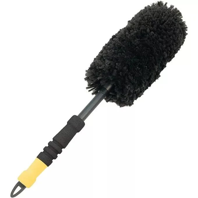

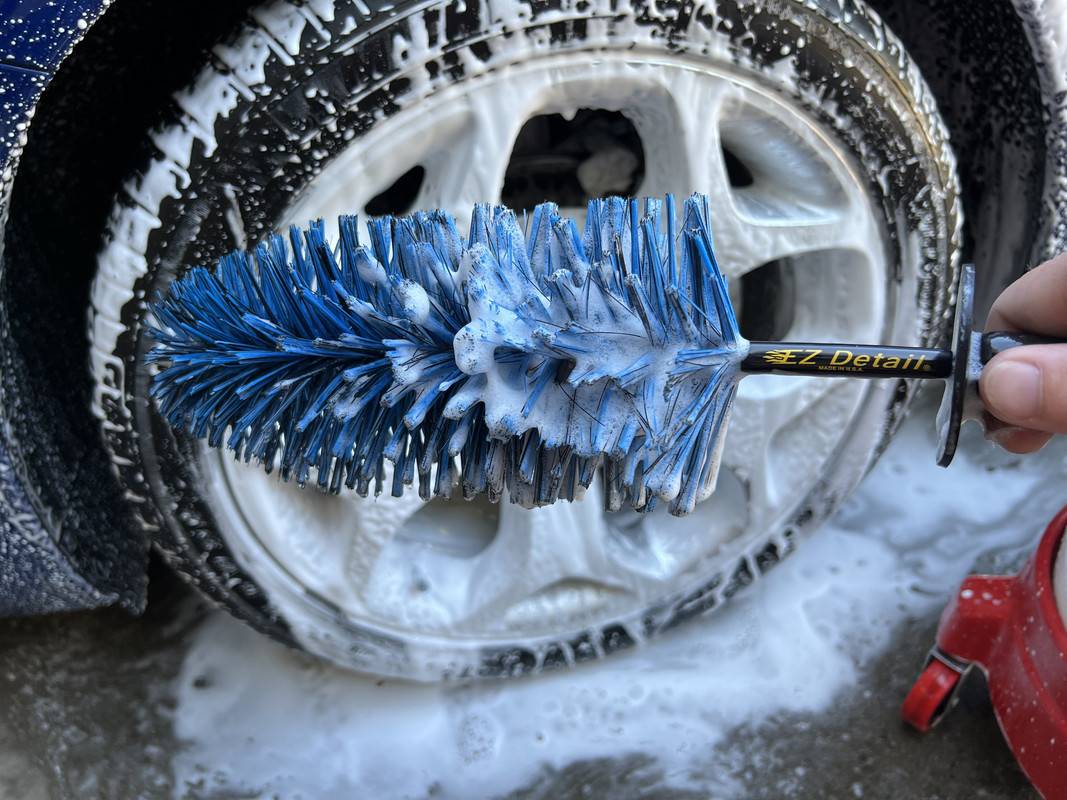

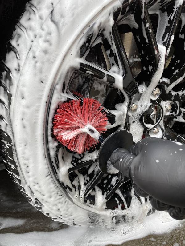

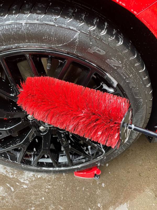

Hey @DFB5.0 is that BigEZ detail brush safe for wheels etc too without scratching? I need a brush like that but cant imagine it not scratching metal surfaces

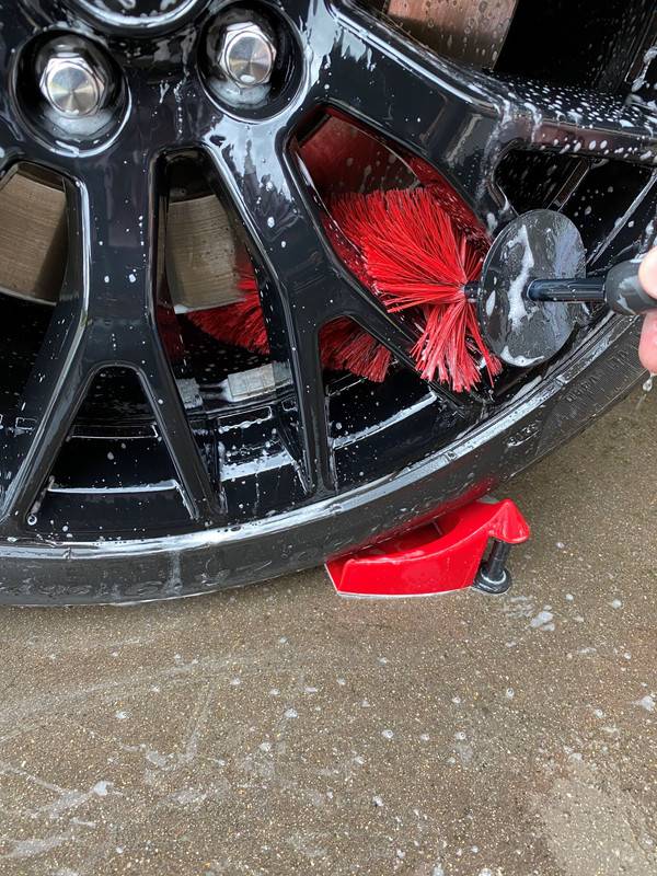

Yes, the EZ-Detail brush was originally designed for wheels. These brushes are softer than they look, but not as soft as a microfiber or wool equivalent.
The thing is, they are essential for when the brake caliper and/or rotor doesn't provide enough clearance for a microfiber or wool barrel cleaning brush. I've also found they help clean the back of the spokes on the return stroke.
You may notice this firmer bristle on gloss black wheels, but not on other finishes. I used these brushes on my S550's Performance Pack wheels and never had a problem.
Personally, I would rather clean wheels than ones covered with baked-on brake dust, which ultimately etches into and destroys the finish over time.
I would recommend not cheaping out by going for the generic branded versions, which are often red in color. The ones shown above are from Maxshine and didn't last very long, so while they were cheaper to buy, they needed replacement in short order. The blue EZ-Detail brushes shown below I have had in heavy rotation for nearly 4-years, and they still look brand new.

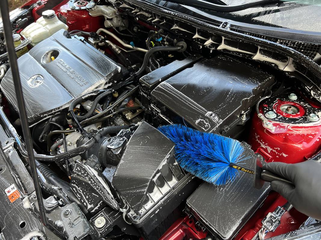

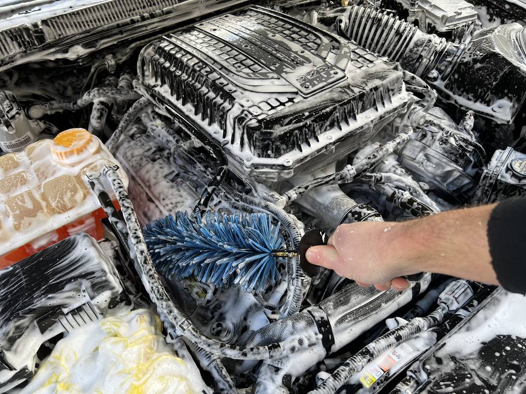

Great for engine bay cleaning too........................
Also, don't bother with the small version, they are no more slender than the large, and in most cases, you need the extra length to extend to the back of the barrel on a Mustang with wide wheels.

I have some griots microfiber ones (similar to wheel woolie) which are pretty good but I might add some of these bristled ones as well. Thanks fellas.

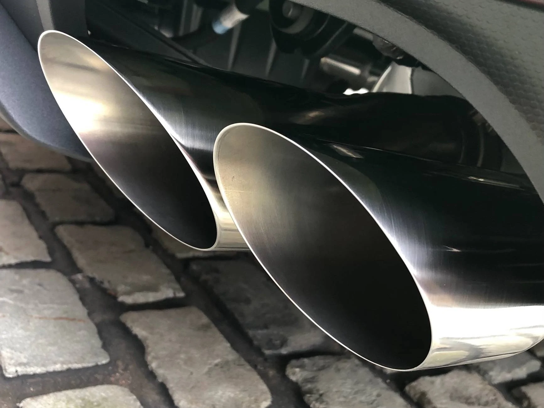

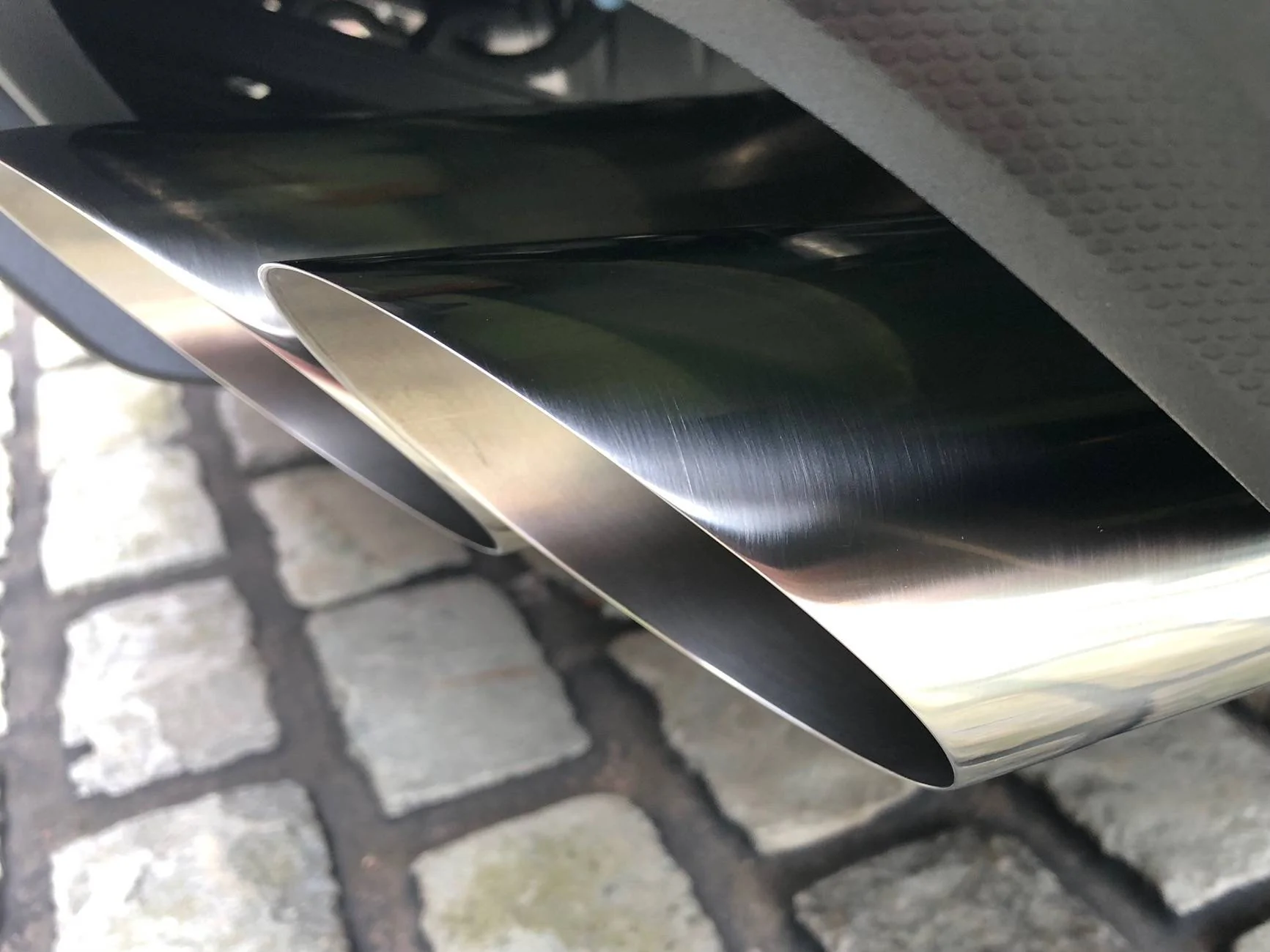

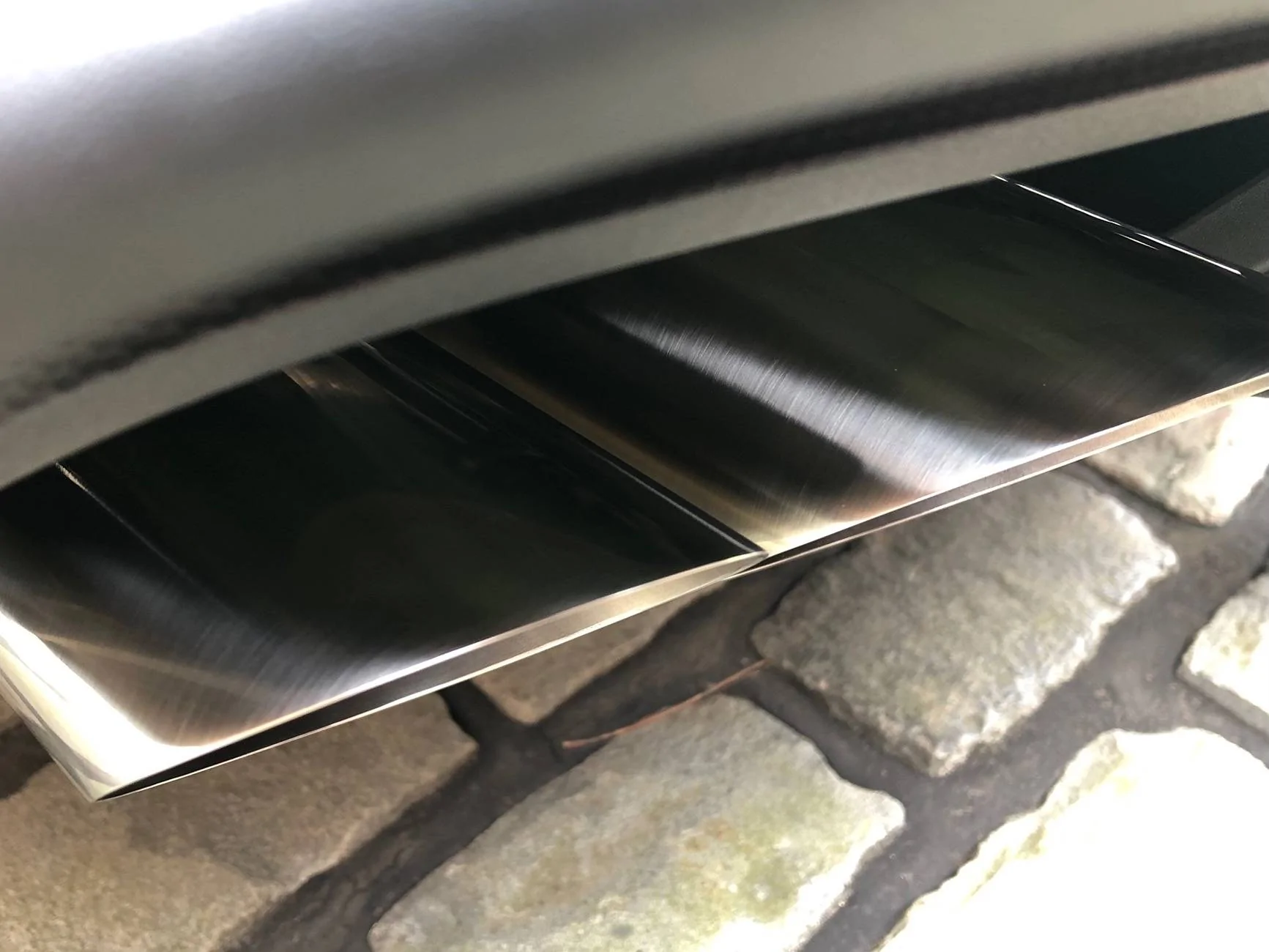

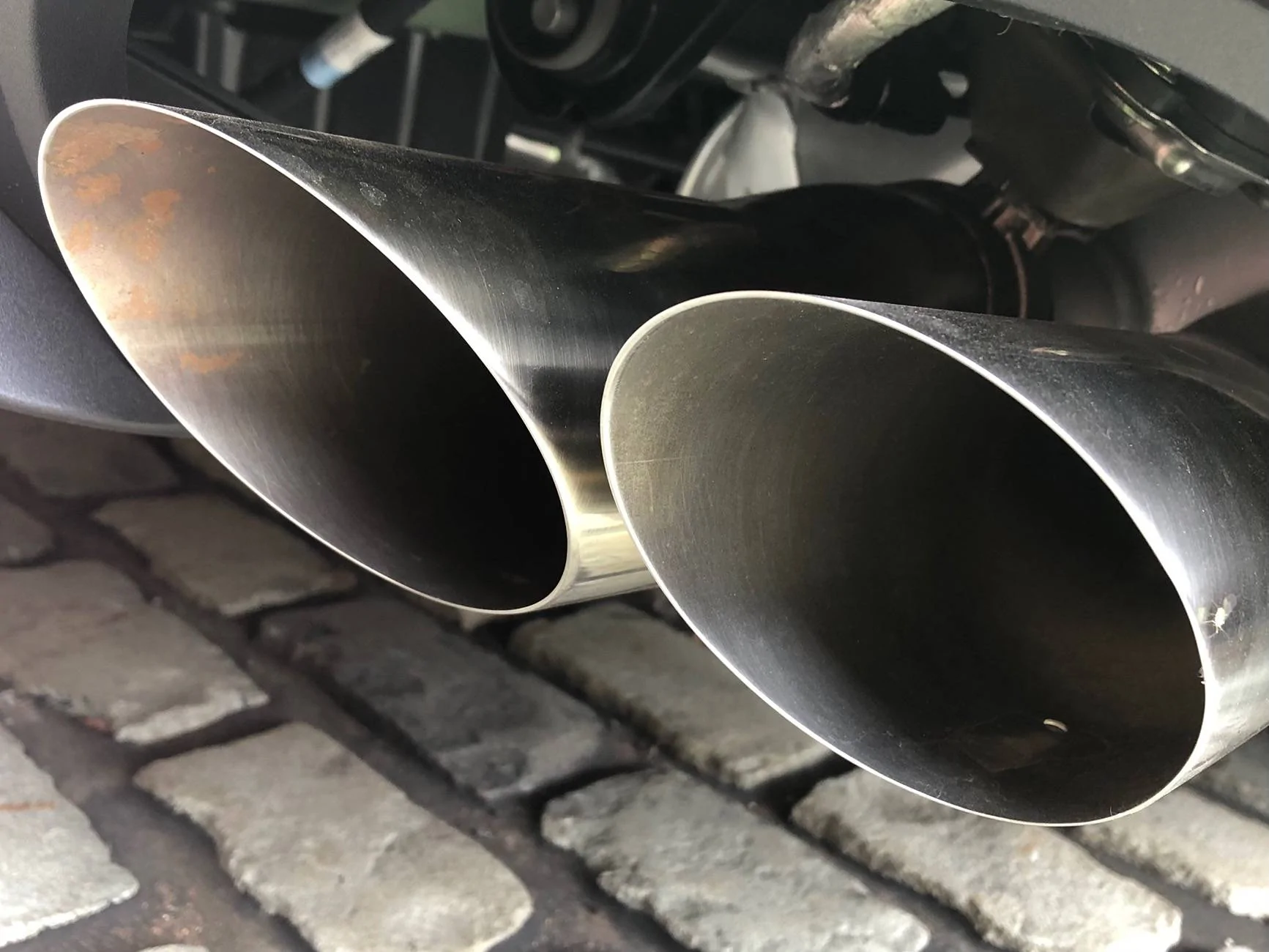

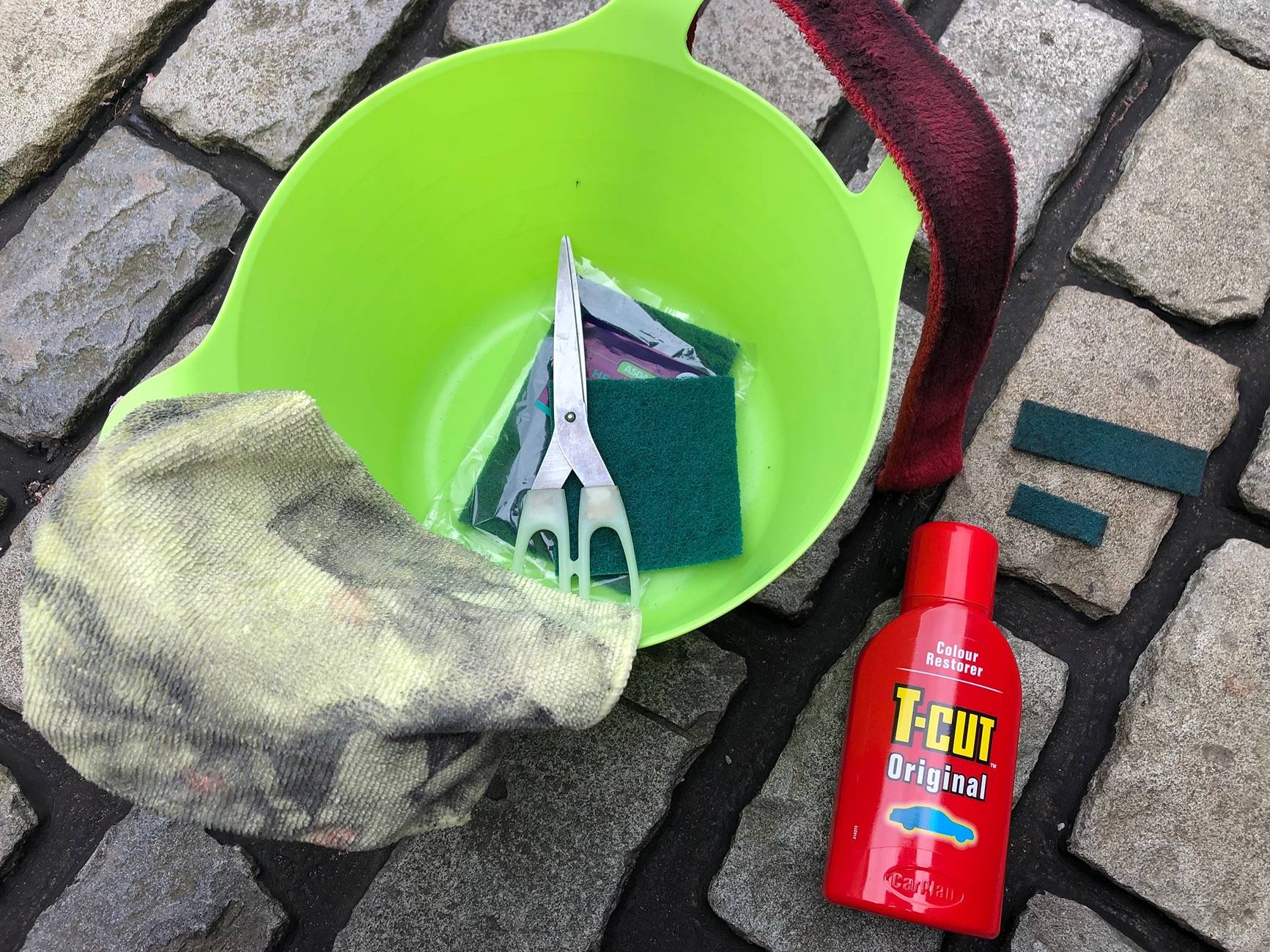

Did mine today, 10 mins with cheap (U.K.) supermarket products :
The only bits of pan scrubber I actually used, were the two small bits on the cobble.
T-Cut stinks, but it’s really effective on exhaust crap.
They weren’t bad this time, just a clean up for the summer season (note internal rust).
Before :
After :
The finish left by the combination of product, scrubber, and method :
Whilst I was around that area, it’s easy to see why the right side AE harness is a weak point :
Left :
Right :
Not a fan of those types of brushes. While effective, they also tend to shoot product and dirt all over the place as the bristles flick free of whatever your scrubbing.
For barrel duties I’m using the Autofiber Barrel Blade which has a microfiber sheath.
It works great on my EcoBoost vert and the wife’s van but it can’t get between the GT500’s front calipers. In fact, nothing can, there’s less than 1/4” gap between them and the wheel barrels. I have to wash what I can, move the car, and then finish the job.
Early on, I noticed the splatter. But for some reason, it doesn't seem to happen now.
Second post of yours I've commented on today - and the second one I agree with :like:

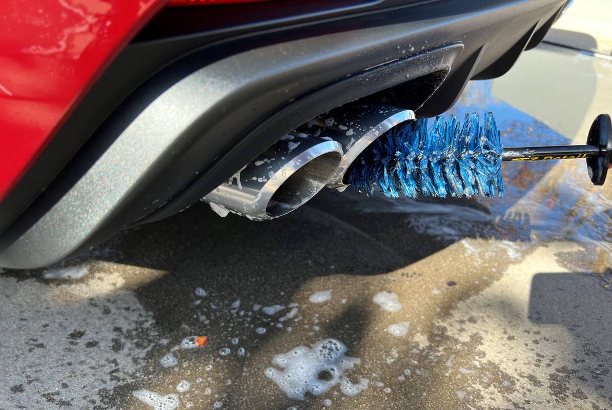

I'm currently using the smaller Megs brush (I like them, they last really well, and they looked after me on one which was well above and beyond any reasonable expectation of warranty).
I just put a small paracord lanyard on them so I can hang them to dry.
I use the same brush type up and around the tailpipes, and the mufflers.
I 'really' like the look of that brush you posted a link too :sunglasses:
