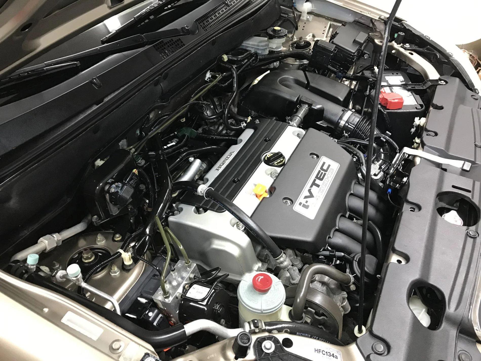

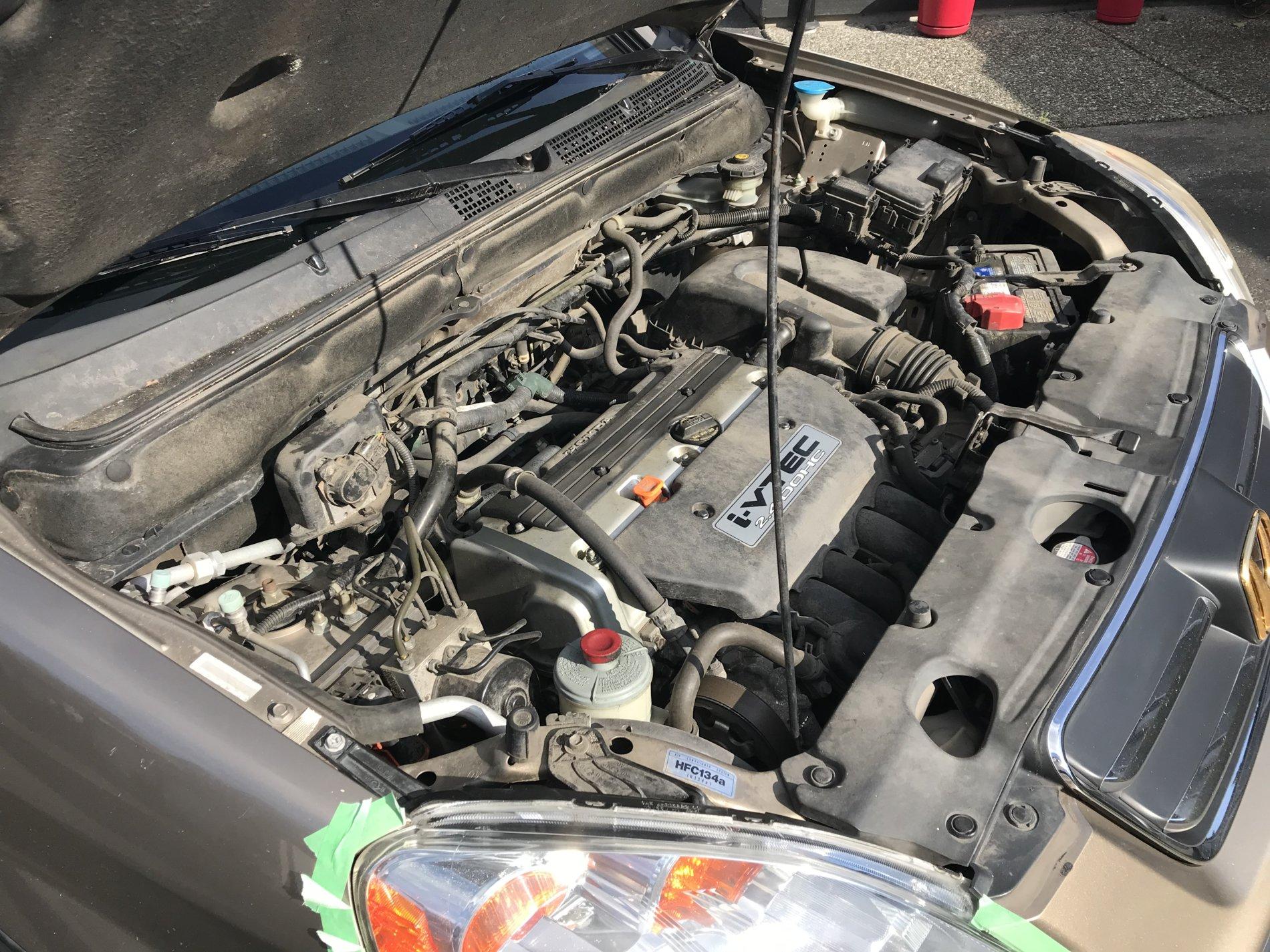

Engine....before/after... product and steam cleaned... guys....everything is possible!!...this I went to a shop for....$45 !!! Good deal!!

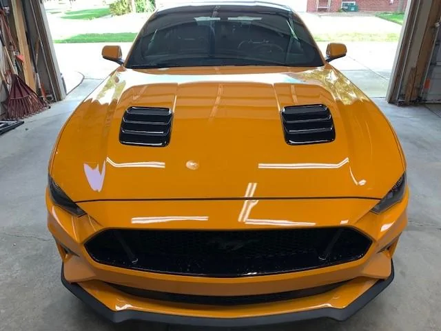

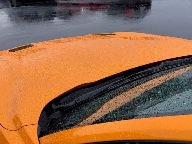

It wasn't that bad. For my Mustang (brand new), the paint was in fantastic shape. It didn't ship via rail, and felt so slick I didn't even feel the need to clay bar it. I washed it thoroughly twice, dried it. Then I wiped it down completely with gtechniq's Panel Wipe (which they recommend before using Crystal Serum Light - iso alcohol likely would have done as good a job). Then it took me a couple hours to apply. I followed the directions and what I learned from lots of videos, and did about a 2'x2' area at a time, then buffed it off with two different soft towels before moving on.

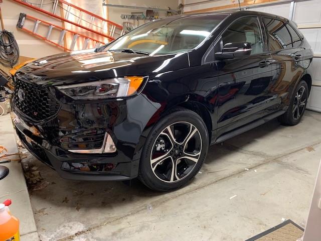

My wife's car took longer, not only because it has more sheet metal, but because it had sat on the lot a long time before she bought it. I had to clay the entire vehicle first, and buff a few spots out. Same deal after that, washed it thoroughly, dried, Panel Wipe, then a few hours to apply the coating.
Results on the Mustang:

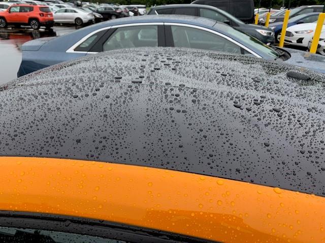

After some rain at work one day:

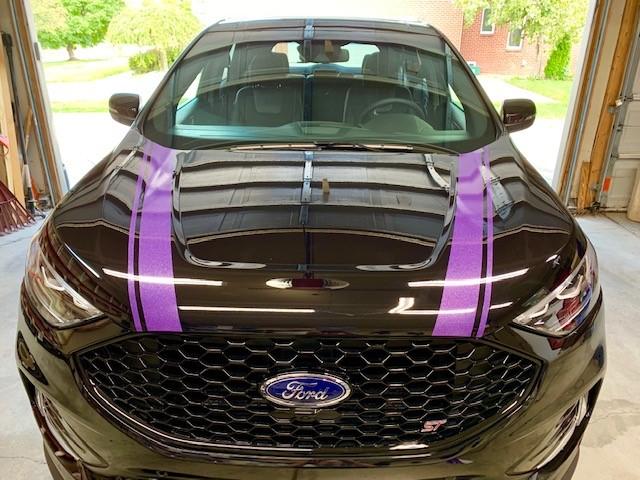

And the wife's car:
This is after I put some hood stripes on for her - yes, that's a sparkly purple. :) But you can see the gloss of the coating.
So total cost to me was $80 for the coating (it was enough to do both cars), and a few hours per car. This is consumer grade, so I don't expect 5+ years of service - I think they claim 3-5 years, so I'm expecting more like 2-3 given our salty Michigan winters. But if I have to apply it every 2-3 years, I'm happy with that.
