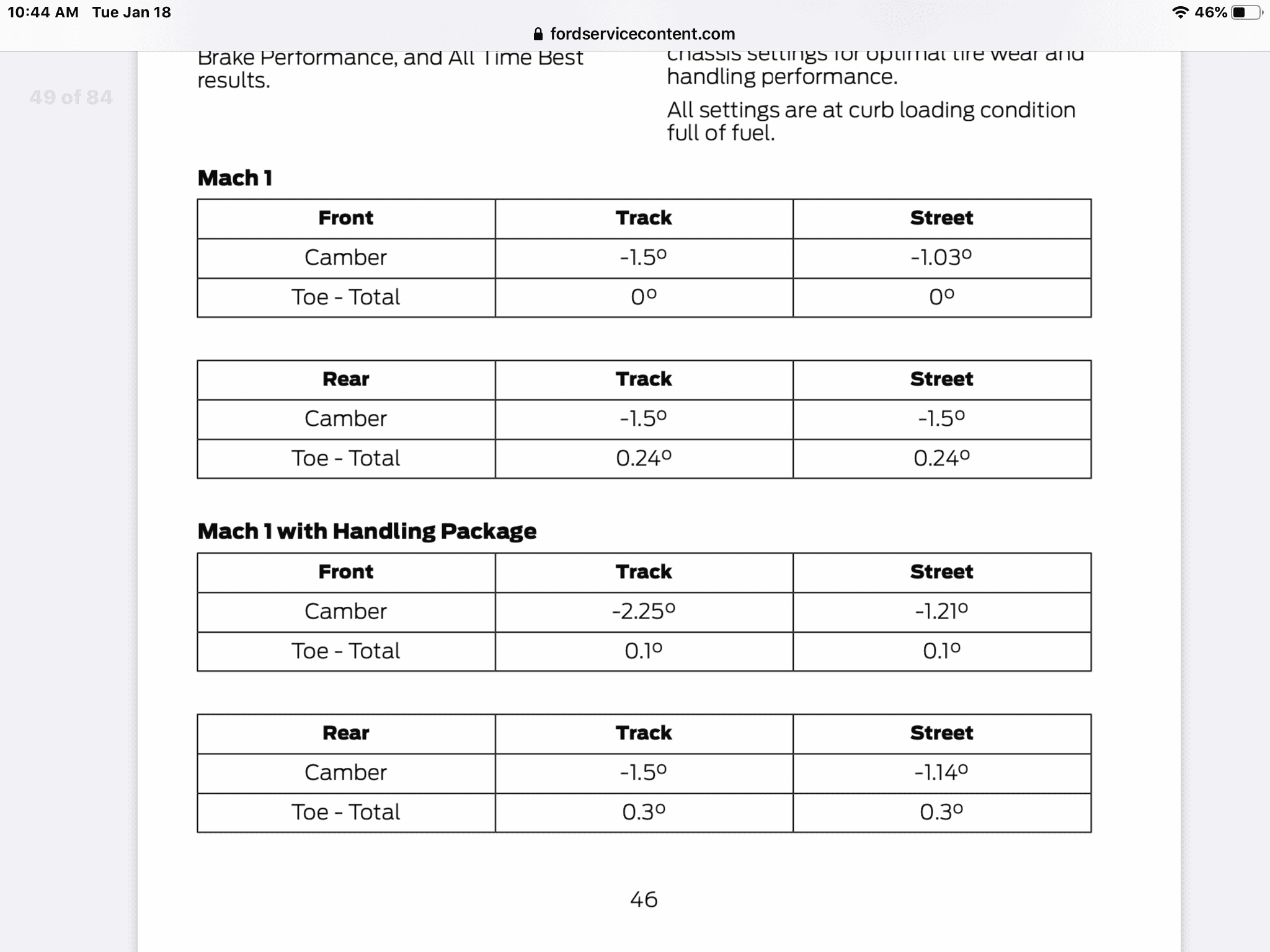

2.5 is fine on the street. 0 front toe and very slight toe in on the rear and you should be just fine.
Galvez1978
Mar 14, 2022
96
119
Spain
Mach1 2021- KTM Xbow RR - 991GT3- G500- Alpine A110R
This is what ford put in the manual, I would call it a guide
One question, in Europe we don't hace handling package, and i want to fit it in my Mach1, are necessary the front adjustable strut mounts? Or works ok with the original?
