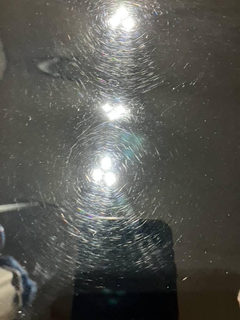

I bought a 23 GT in Shadow Black last fall and the paint is in tough shape with a lot of heavy swirl marks all over the car. I have a Porter Cable 7424 polisher and am trying to determine how aggressive I can be while keeping in mind I haven't had to do this type of work for awhile. Is there enough there to accommodate a two stage process or should I stick to some sort of single stage process.

Best thing to do is measure it. I have a paint thickness guage. Has come in handy quite a few times. And they aren't very expensive. Good rule of thumb is the door jambs only usually have 1 coat of clear so it is typically thinner there. So measure the jambs, then all over the car to get a base idea how much clear you have to work with...

Yep, do yourself a favor and get one of the gizmos to measure the thickness but keep in mind, the number you get represents the thickness of ALL the paint coats, not JUST the clear.
As bad as that clear coat is OP, you may not get all of the swirls but you'll get the vast majority of them. Start on an area that isn't super important like behind one of the rear fenders that also indicates the most paint and as you learn the polishing technique with a Dual Action polisher, take your time and work on say a 15" square area.
Do a couple passes, see what the results are visually, and then re-measure the paint thickness. If you're using a medium or fine pad and medium to fine compound, what you'll find is that you haven't removed very much clear at all..a few microns. It doesn't take a great amount of paint to produce gloss and the key is simply not to go to far.

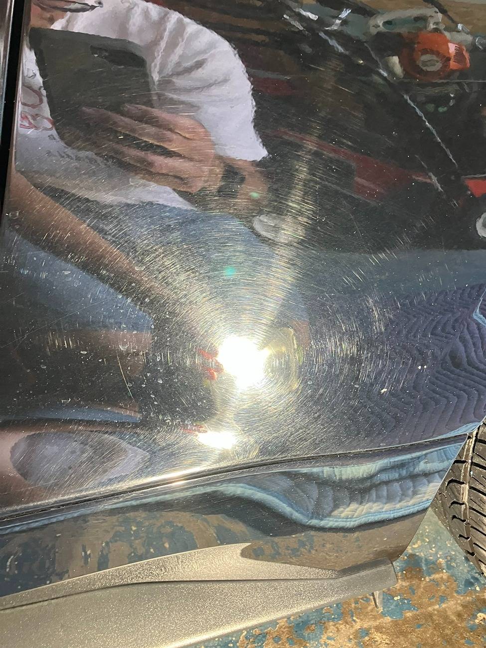

Somehow the stars aligned and I was able to take a couple of days to dedicate working on the swirl marks
1. Prewash with Carpro Lift. From what I understand, this will help remove any previous waxes/polishes
2. Wash with Carpro Reset.
I was pretty impressed with how clean the car was. I never really thought about what I used for soap but that has changed.
I had a friend who had some Meguiars products ( #2 and #9) which he let me have so started with those for compounds since they were free.
I did take a thickness meter around before doing anything and everything was pretty much the same around the car except the door jambs which were a bit less.
After testing on a spot on the lower quarter behind the driver's door, I came up with the following method.
1. Lake Country orange pad using Meguiars #2
2. LC white pad using Meguiars #9
3. LC black pad using Carpro Reflect.
Using the paint meter afterwards did not show much appreciable change in the finish thickness; at least as far as I can tell.

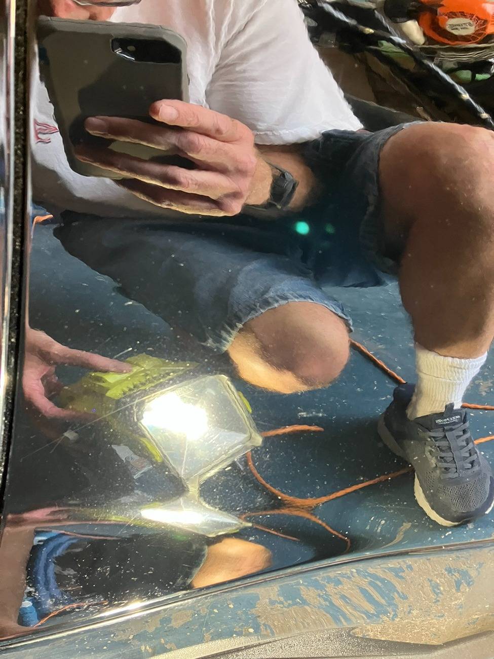

Test spot before:
Test Spot afterwards:
Is it perfect? Nope. The after picture probably make it look a little better than it actually is. But it is improved significantly enough that I can live with it for now.
