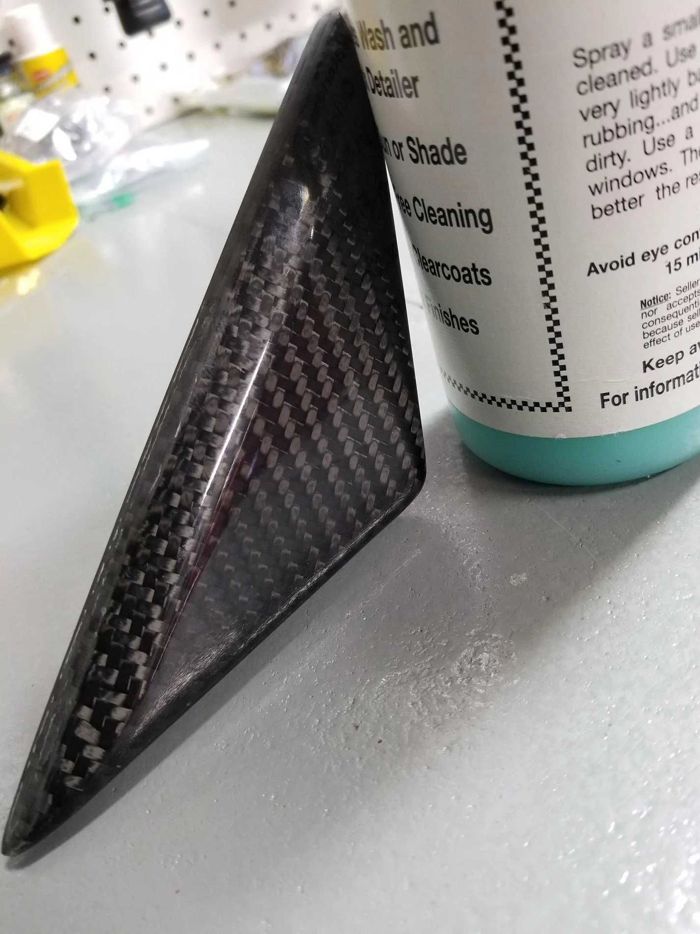

I have a carbon fiber mirror triangle that I purchased used from here in the classifieds that had some scuffing on the leading edge.
I've sanded the entire leading edge down to the bare carbon and now I want to clear coat over top of it and possibly the whole triangle.
Can someone walk me through this process? To include the type of cc to use (enamel, acrylic lacquer, or something else) if I need to sand/prep the rest of the piece prior to clear coating and how many layers and how to prep between layers and finally what to do for the buffing process.
Pics for reference.....
Good to use??

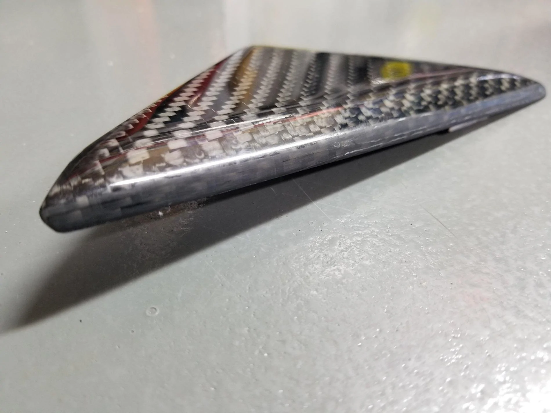

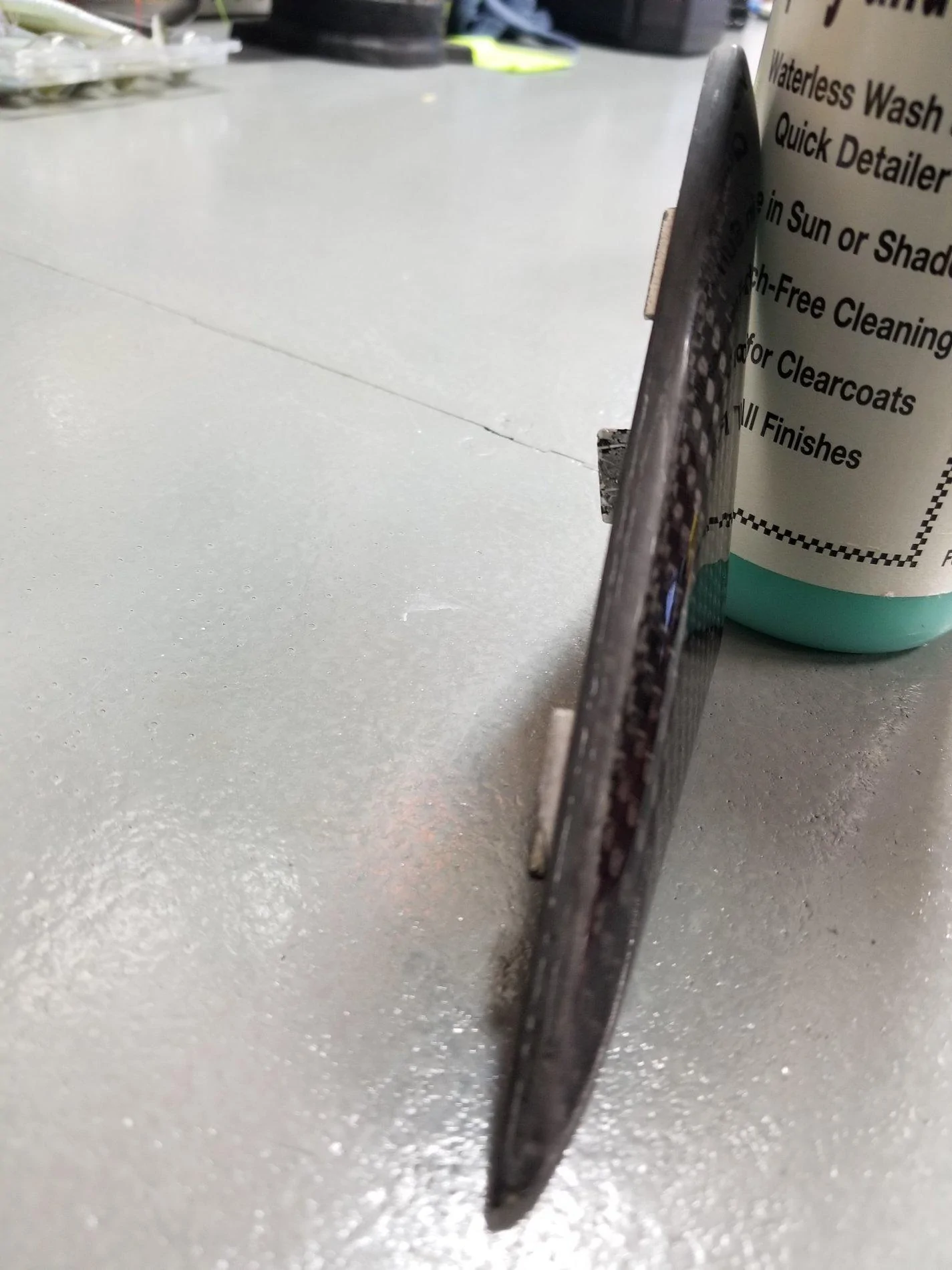

This is the actual piece after my sanding with some 400...
