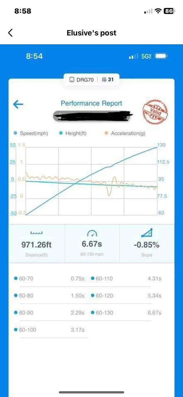

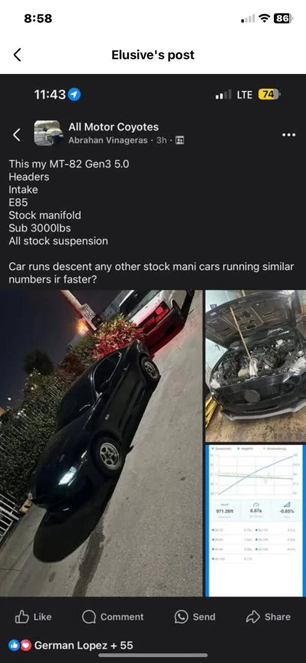

So spoke the gentleman who runs this car and he claims no CF or fiberglass parts.
But it is fully gutted. No dash, no center console, if you can take it off its off. So I guess you could say this has been answered. You can get to 3k without spending money on CF or FG. He’s an FBO / E car running mid 6’s

Why gut a newer car if it's not a track only car
And why try to go fast with an MT-82?
Does he have a weight ticket/slip?

He probably does but won't share it.
Either way, times are believable if it truly is at that weight.
It isn't his daily, it makes sense there - just a grudge car.
