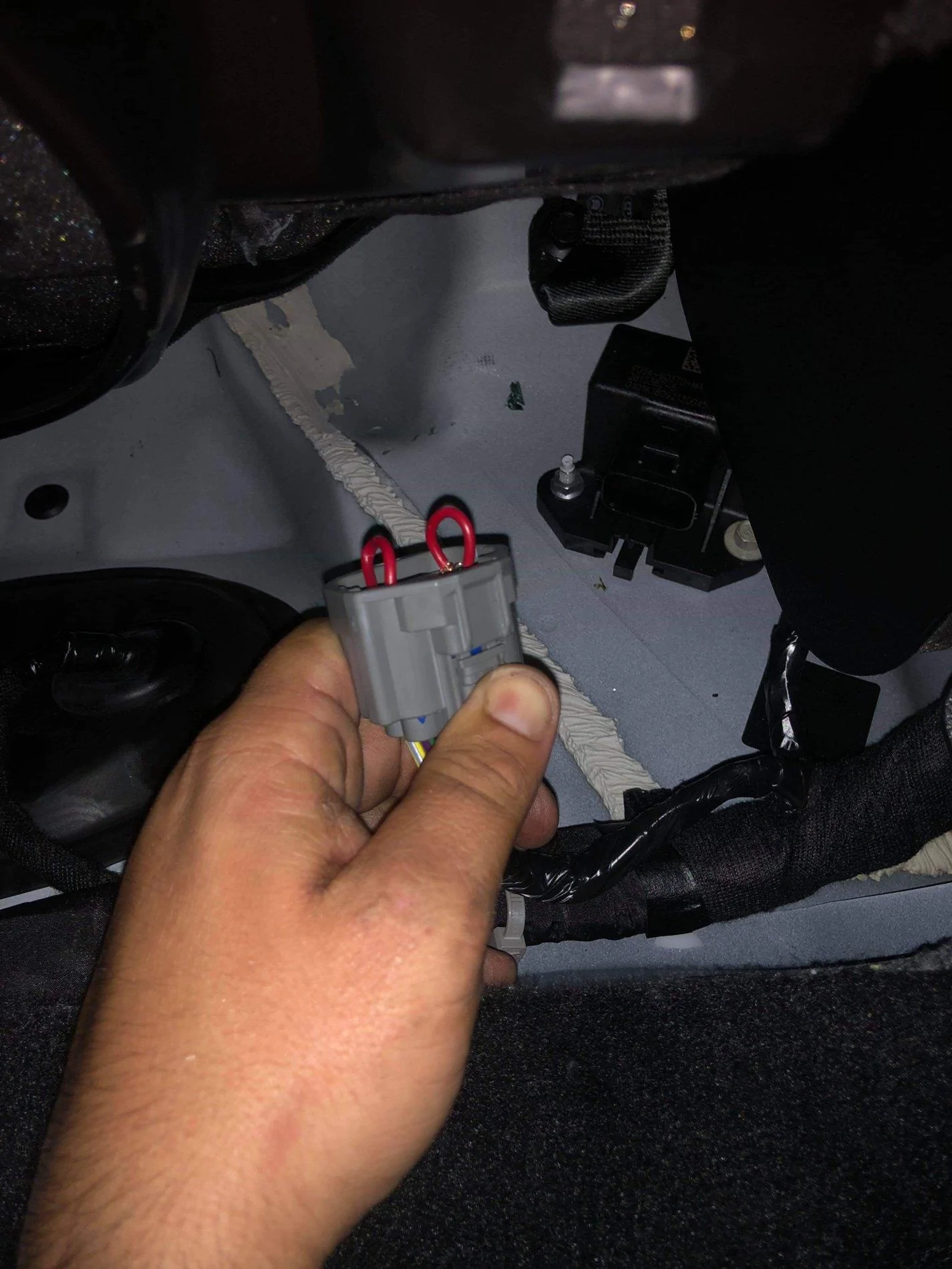

Pull the plug at the FPDM.
Press start button to remove pressure from the lines.
Remove fuel line at either the pump or fuel rail, whatever’s easier for you.
Place a bridge into the two outermost connections as shown in pic.
Press start button again and fuel will flow.

Thanks,that what I was looking for.I will but 2014 Shelby gt 500 fuel filter and about six foot of fuel hose and pump fuel from the fuel rail.
