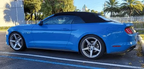

We have several convertibles & staff to support your build in our stable! Both our stout in the handling department.
Shoot me an email at tim @ steeda if we can help answer any questions & get your build headed in the right direction!
Rodney - one of our veteran sales professionals has the following:

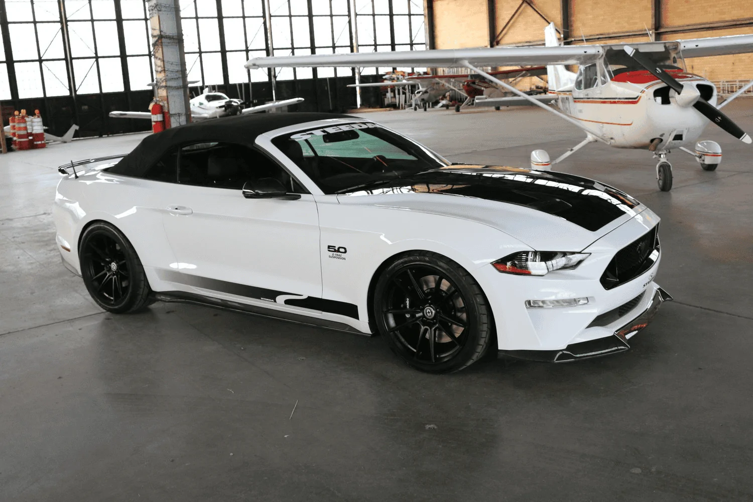

& I have the White Carbon Edition:
