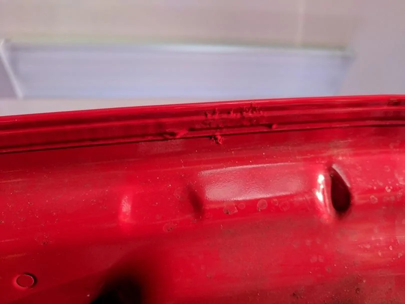

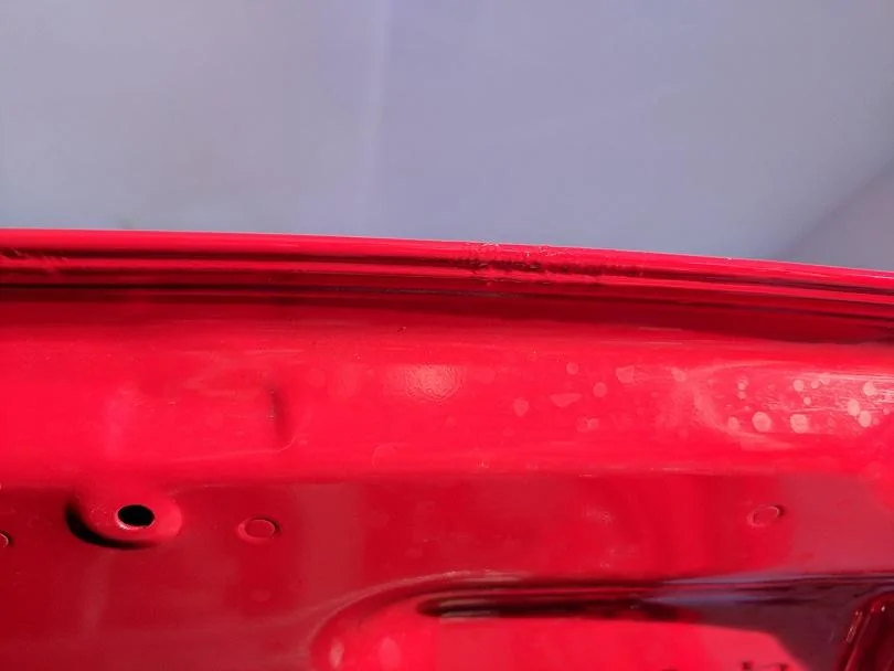

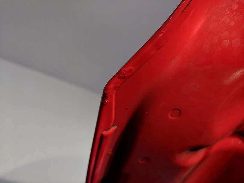

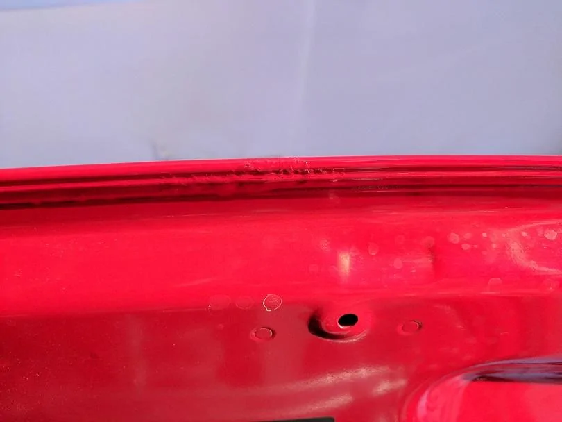

Add one more to the hood cancer club. Car is a 2016, built W/O 21-SEP-2015, delivered W/O 12-OCT-2015, spent all its time in South Carolina and Florida. Car is garaged, and hood always kept waxed/sealed. I noticed the cancer when I was ceramic coating the car on Saturday.
I'm taking the car to Greenway Ford in Orlando tomorrow morning to start the process to get a new hood. It would be nice if they would let me swap out the stock hood for a Trufiber A72 or Cervini's Stalker hood, but c'est la vie. I'm going in with TSB 17-0062 ready to go if they try to propose repainting the stock hood.
