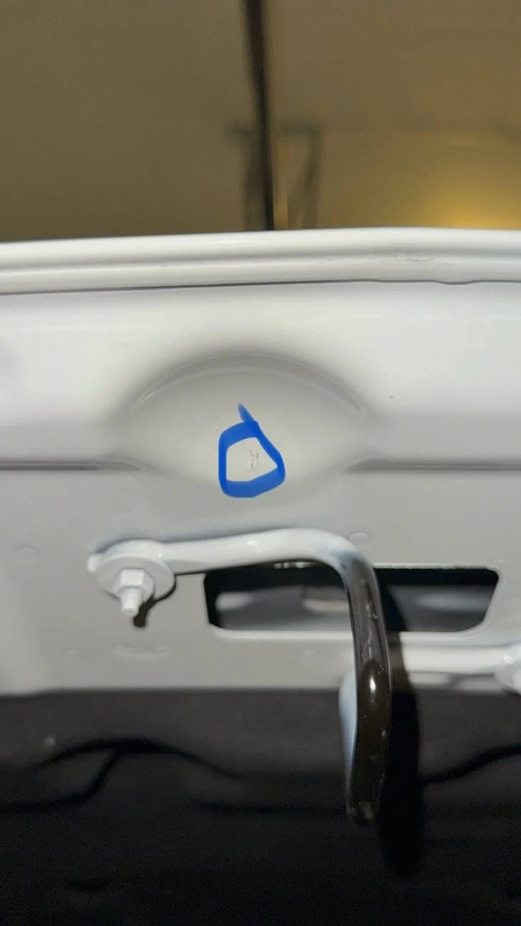

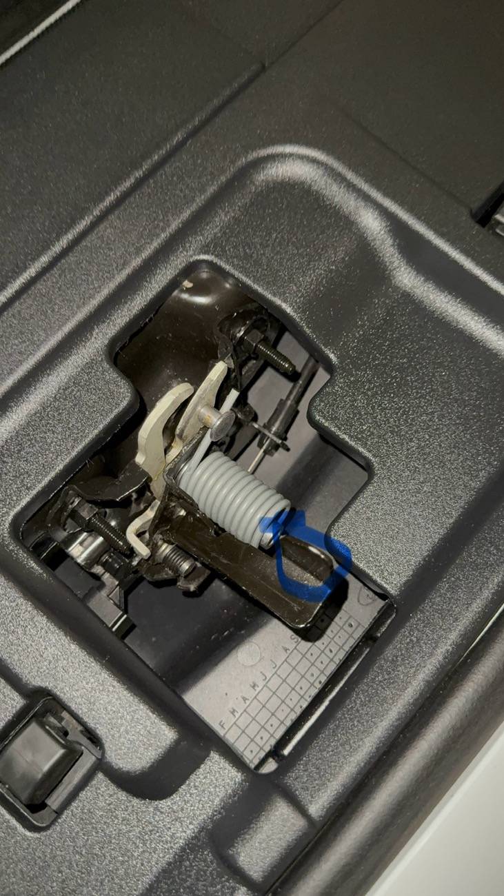

Hey guys, I need to adjust my hood a bit. I noticed it was hitting the latch in the center here, and confirmed it after touching up the paint, and it scuffing it.
I’ve read a few threads about this being an issue, is this thread linked below accurate on how to adjust it? Or should I just mess with the latch right away? I can tell it sits too low.
Thanks.

Adjust it in tiny increments. If the hood is resting on the left and right hood stops the hood center is being dragged down you might be able to get it right straight away. If you start raising the center catch and the hood lifts off the stops while latched it might take some manipulation of the panel. Doesn't seem like you need much adjustment to get what want.

I would leave the left and right bumps stops alone the hight looks good. If the center latch is too low and its pulling the center down after the side bump stops makes contact it will give you the gap you're experiencing. I would loosen the latch and raise it so little you barely think you moved it. Torque it back down and try it there. The center only should raise ,not the sides. If the whole thing goes up evenly across left to right and is off the bump stops it's going to take a little more aggressive approach to match the contour of the header panel. If you saw how the guys forcefully adjust some of theses at the factory you would cringe. This is when I tell the customer to come back later. Lol

Tried the bump stops first and still had the same issue, so I went and got a 1/4 ratchet and socket set to adjust this tomorrow. I aligned the bump stops to the height of a quarter back to where they were after messing around with them.

Another option would be to place a washer or two under the striker on the hood to lower that towards the latch assembly. If you get I believe 6mm washers they are tight to the diameter of the studs and will probably not be noticeable once installed. This option might be quicker and easier than adjusting the latch. The latch can be tricky at times. Loosen too much and it moves all over the place, not enough you get no adjustment. Getting the nuts loosened just right is a trial and error if you haven't done this before. Good Luck!

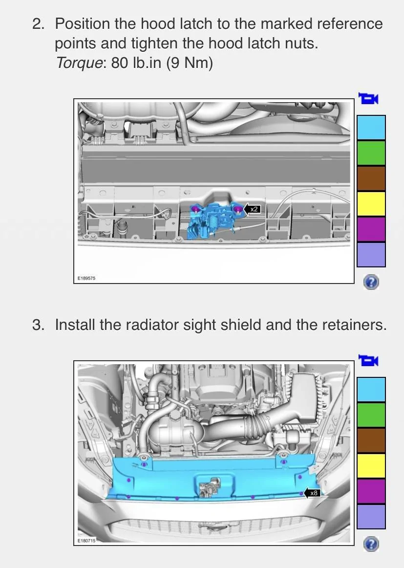

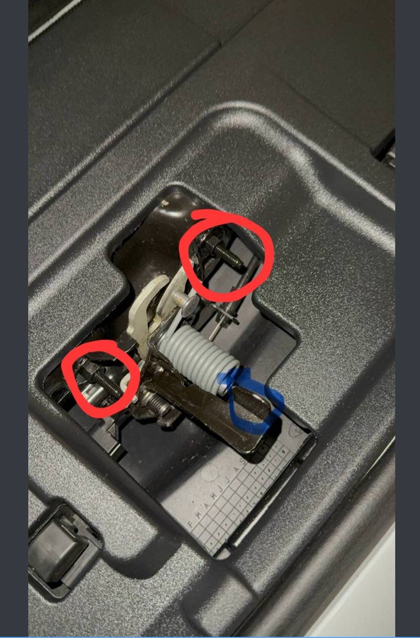

IF you have adjusted the latch to where you are satisfied with the hood I would torque them to specs. If you are still adjusting the latch I would recommend back the nuts off no more than 1/2 turn and see if the latch can be moved slightlly for adjustment. If not then I generally go in 1/4 turn increments until I tap the latch and get it to move slightly in the direction I need. Then I hand tighten the nuts snuggly and test the fit of the hood. Rinse and repeat until you are satisfied with the fitment of the hood, then tighten the nuts to specs.
Small adjustments on the latch are preferred otherwise you can quickly and easily get way out of whack and start all over again. Hope that answered your question.

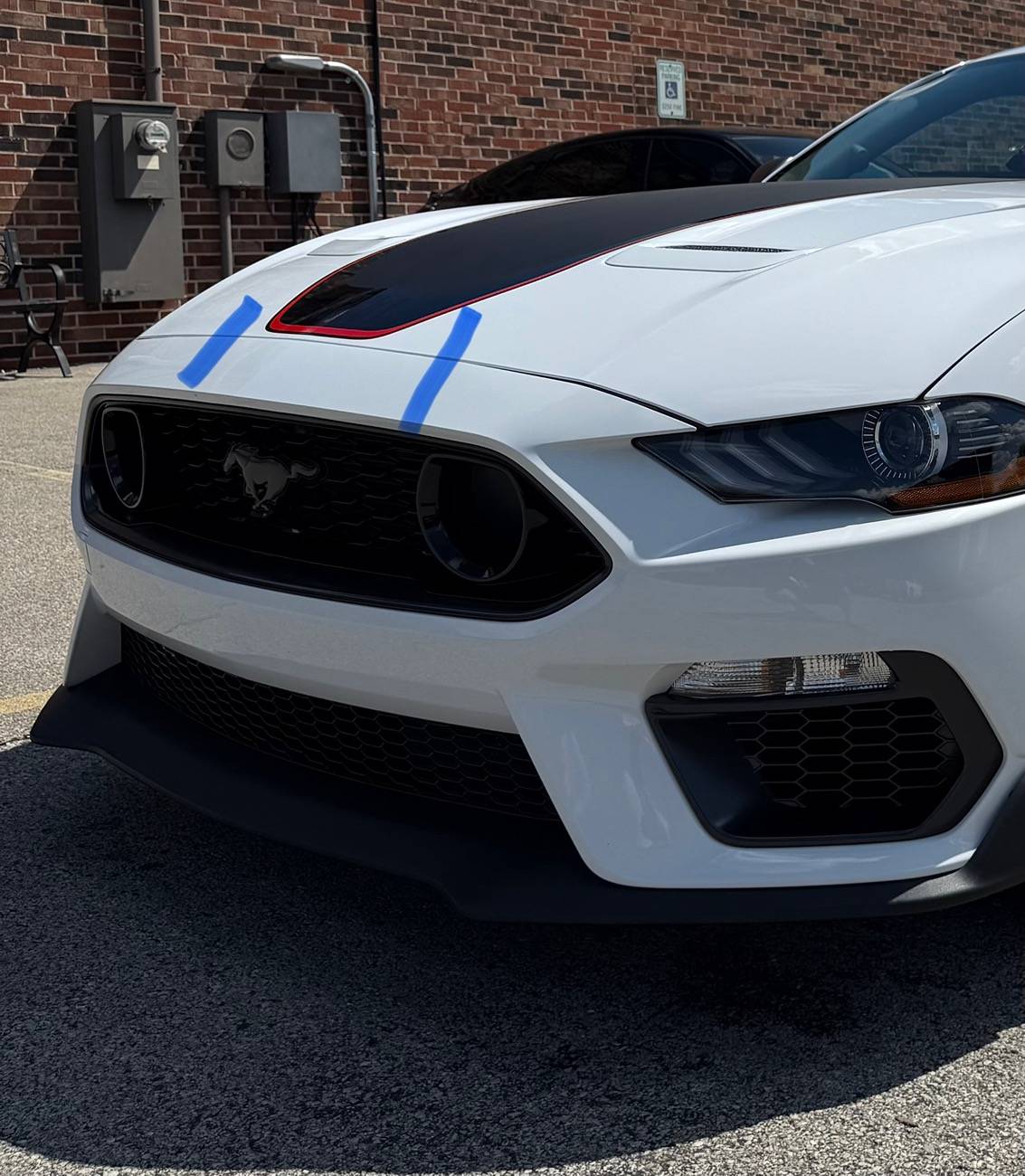

Yes that about answers my question, so essentially back off the nuts as little as possible to get movement of the latch and then back to hand tight, test fit it closed, then torque to spec once satisfied. Is there anything I should be measuring to know it’s correct? Just when the bumper and hood sort of slope the same way? As marked by the blue lines. If that makes sense.
Also do you recommend removing the radiator cover or leaving it?
ORRadtech
Sep 12, 2019
4,135
4,083
Atlanta, Georgia
Torque is only 80 inch pounds. That's like 6.5 foot pounds. That's not a lot. You'll probably over tighten it by hand if you're not careful.
I’m going to pickup a 1/4in torque wrench tomorrow to be sure!

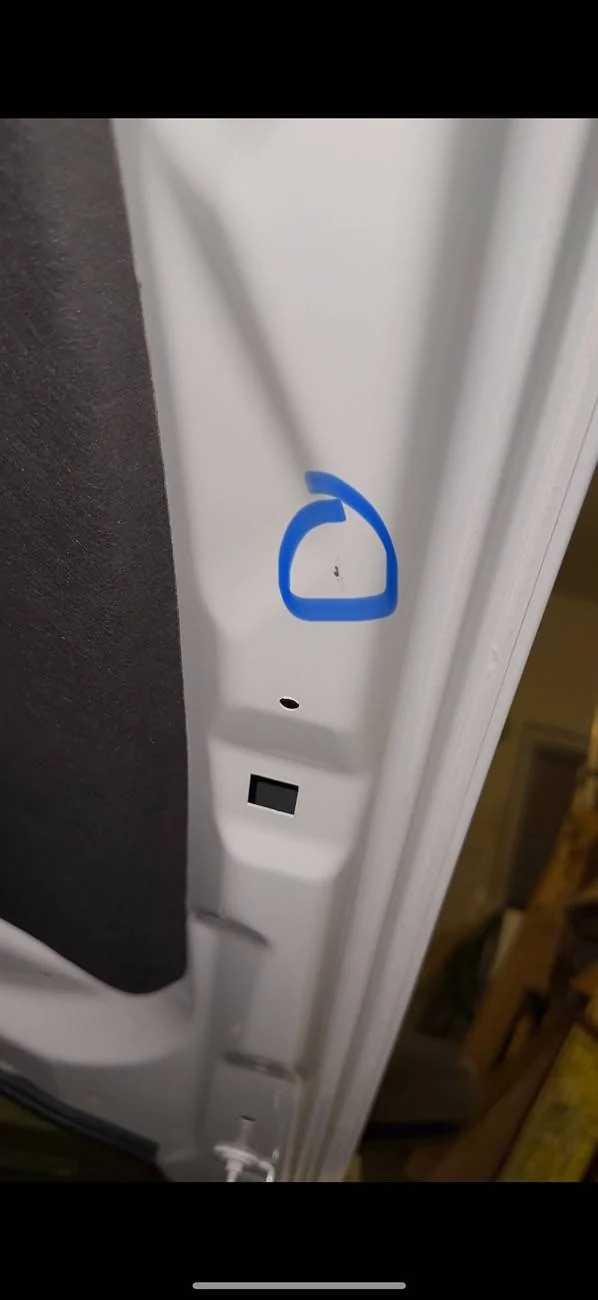

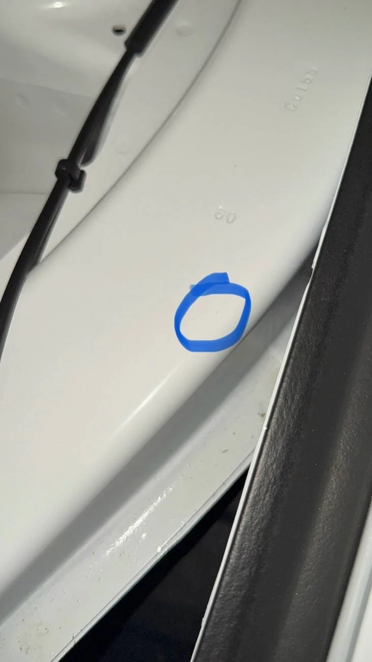

Also noticed it’s hitting slightly here on both sides :/ I know this has more to do with the bump stops, but hoping that adjusting the latch will help sort this out too. I just don’t know how to know if it’s still hitting or not, maybe shaving cream.
Cobra Jet
Feb 12, 2015
771
17,612
20,073
Go to your local dept store, craft store, dollar store, and go to toys section; get silly putty and use it as a marking reference…
