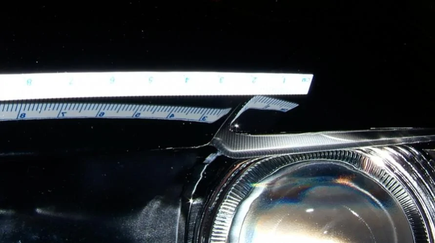

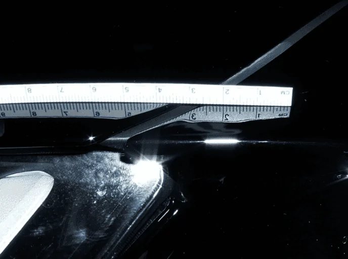

Can you post a photo?
Here's a photo of the LH (driver's) side and RH (passenger's) side. You can see from the reflection of the small ruler in the paint that the LH fender sits up quite a bit from the hood's surface. On the RH side, the hood and fender corner fit nice and flush.
I tried carefully bending the LH fender's front end downward, but it would just spring back. As others have mentioned, if I raise the bump stop on the LH side of the hood, it's just going to make the whole hood stick up above the fender line all the way back to the door.
I think the problem is some of the driver side fenders don't get shaped exactly right at the front tip/corner, and this is what happens when the panels are aligned. The rest of the hood aligns pretty well every where else besides at the front end corner of the LH fender.
