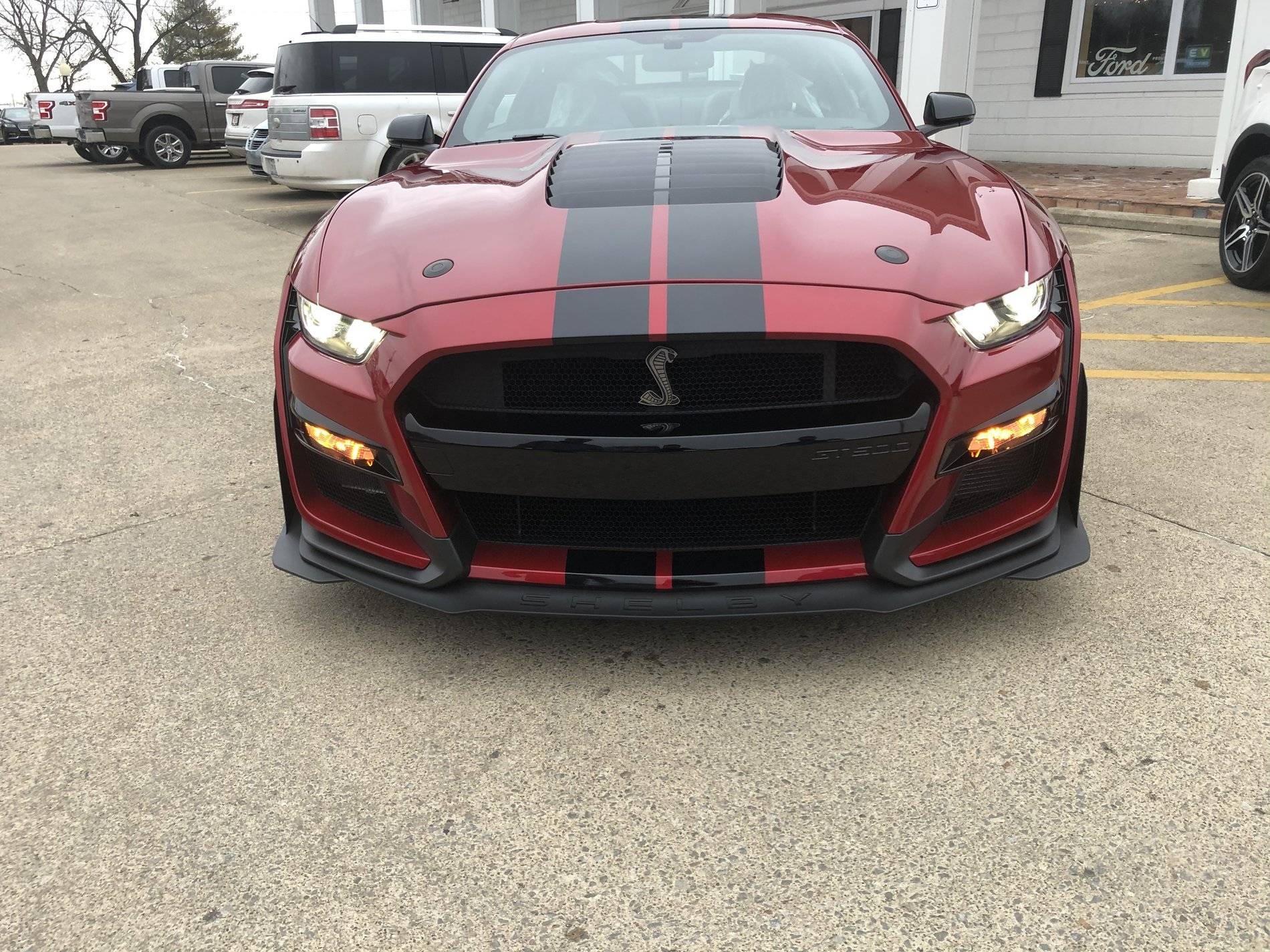

Jamie take a look at this pic and curious if yours is like this if your look at the headlight above it where the hood and fender line is you can see my right side has more gap. Now it’s really starting to bug me with the gap.

I had his. No need to take it in. The actual latching mechanism is sitting too low. Loosen the 2 bolts and move up. Try again. U meay have to repeat this to get it just right, but much faster than taking to a dealer

I think you are talking about the gap spacing between the hood and fender, which is common. Open the hood and loosen the top fender bolts and push the fender towards the hood to close the gap.
Steve is 100% right on how to adjust the hood latch, I suggested taking it in for your peace of mind, and not knowing how much you tinker. Looking at mine, the hood closes tighter, and the fender/hood gaps are perfect.
