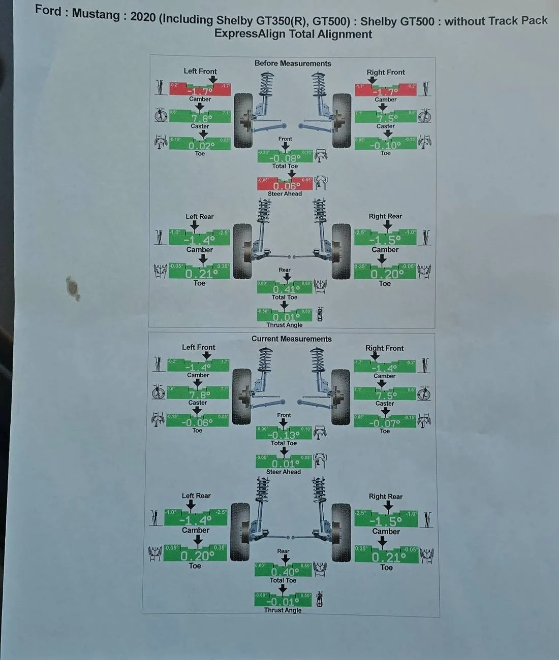

Here's my last couple of alignment specs when the dealership had my steering off center. It wasn't steering straight when I got it back from these but it was perfect when I sent it in initially.
I adjusted as described above. Equal turns on both tie rods in the direction I needed the car to steer. Very minor adjustment and I'm set up perfectly now. It takes some fine adjustments. A good alignment guy will take the time to road test the car enough to get it right eventually. It takes some work and patience and a couple of tries.

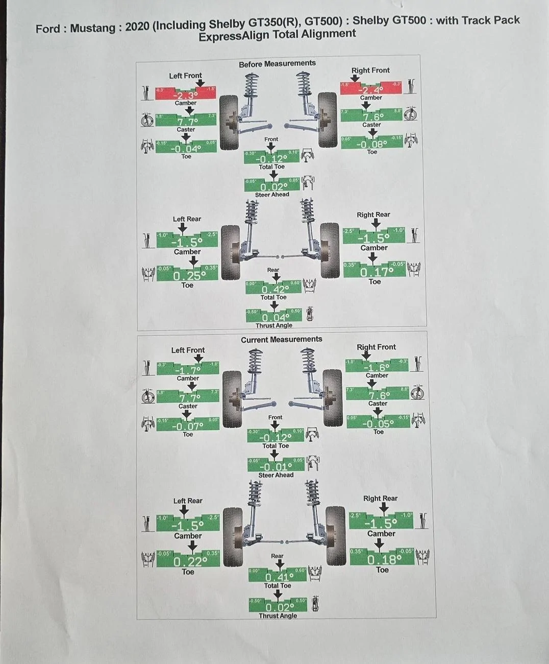

But you notice your cross caster is .1 degrees. With modern cars, they are usually this close, MAYBE .3 degree cross caster max (on alignments I've personally done).
The procedure you describe is useful for centering steering wheel. The only way to truly "fix" a pull, at least partially caused by caster differences, is to adjust the caster. Not factory adjustable, and typically does not change, unless you bend or wear out front end parts.
You can compensate for it by messing with effective thrust angle, but not really the correct way to fix.

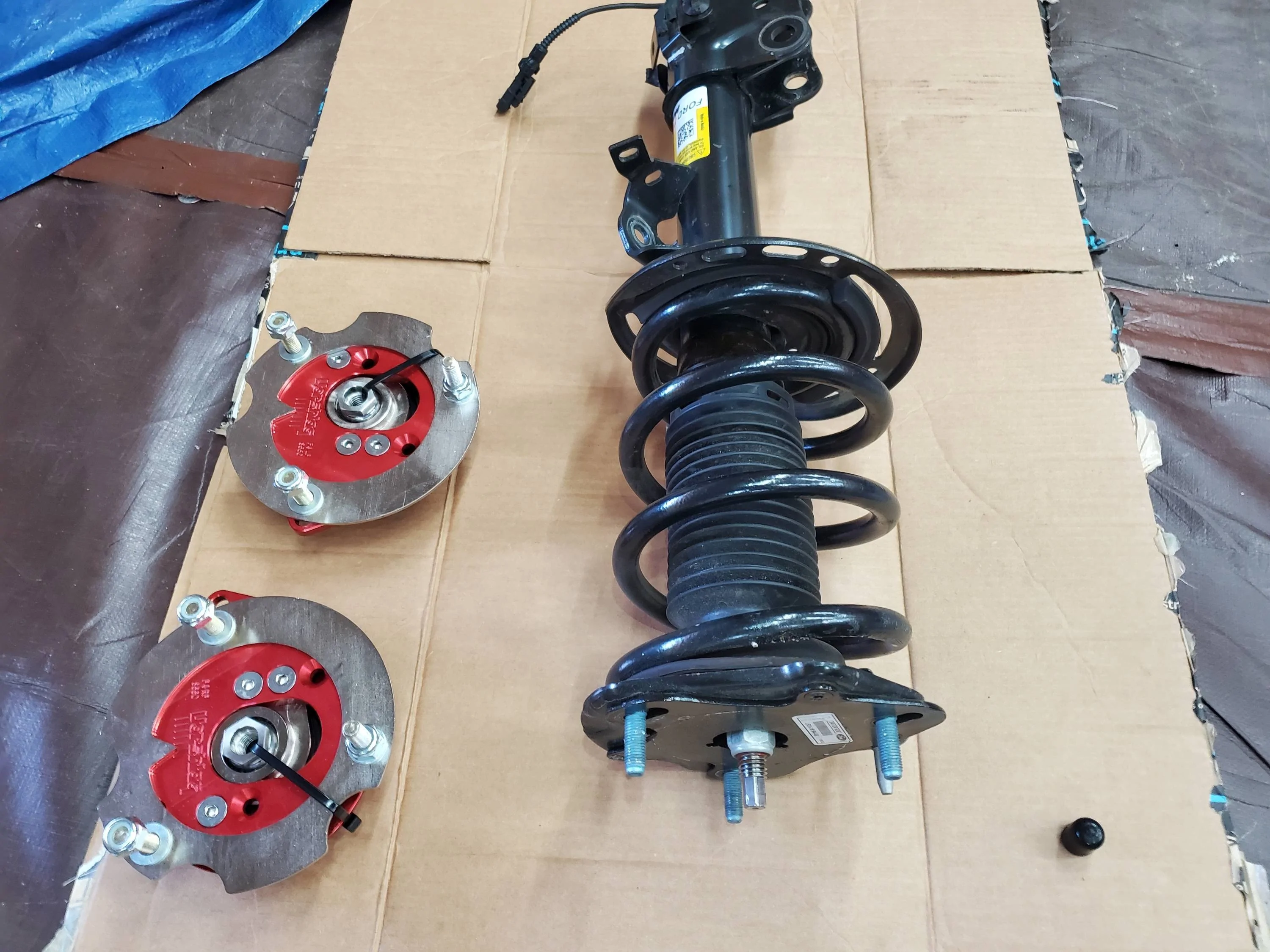

One thing that could be done (by OP), since he is exactly a degree cross caster, is get Vorshlags caster/camber plates. They are not infinitely adjustable for caster, but they have 1 degree of caster adjustment. Could set one side to stock and add one degree caster on the other side, to even them up.

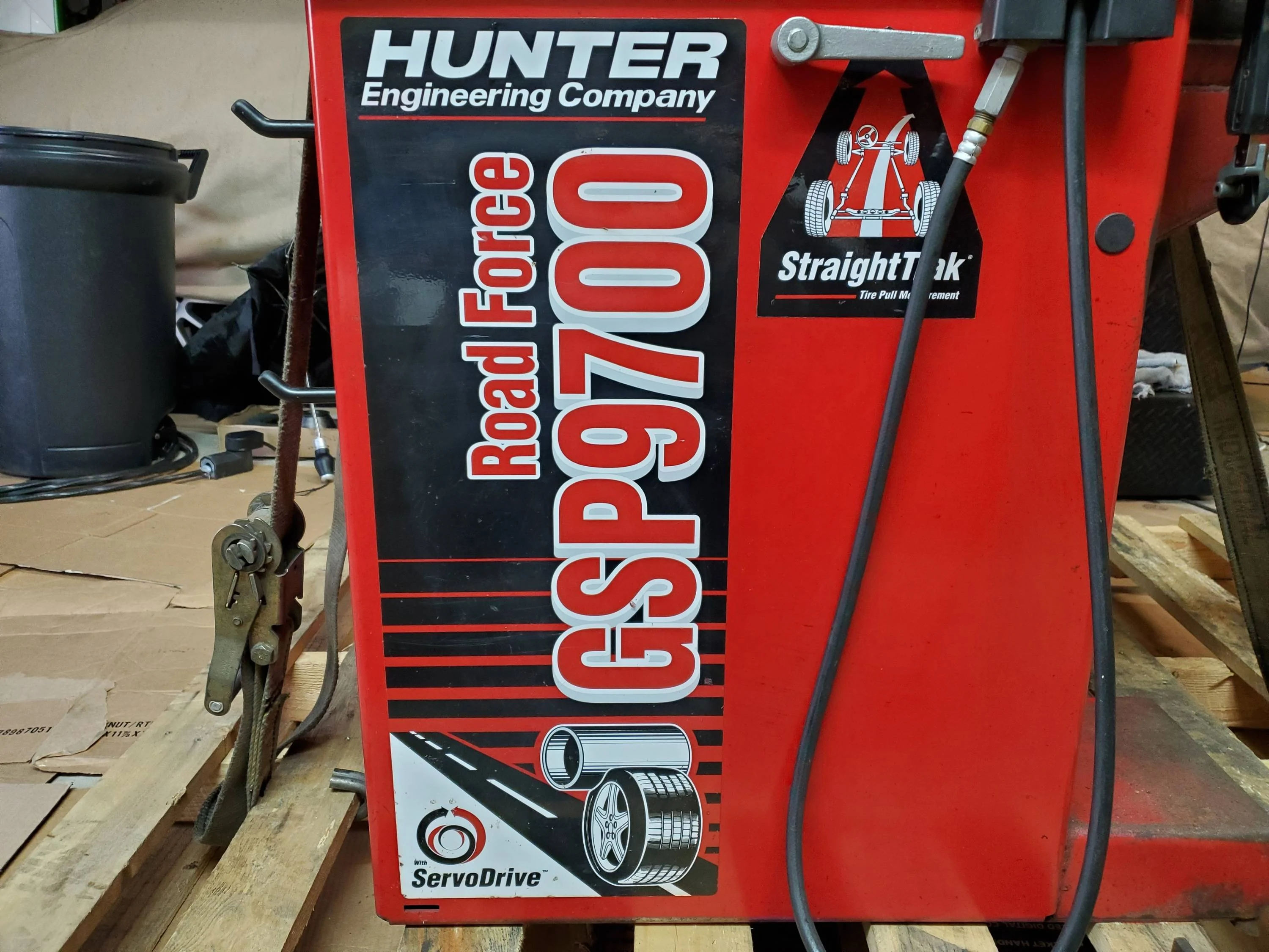

if you really want to get fancy, you can find a shop with a "Road Force" balancer. The newer one's can actually measure the "pull" of a tire. In fact there is a procedure of measuring this pull on all 4 tires, and the machine (balancer) will tell you which tire to put where, to minimize overall pull. My Road Force balancer is a bit older, so not sure if that procedure is updated for vehicles where you are not running "square" setups (with either rims or tires not being able to be used front to back).
If the machine has the "StraightTrak" sticker like mine on the front, then it has this feature.

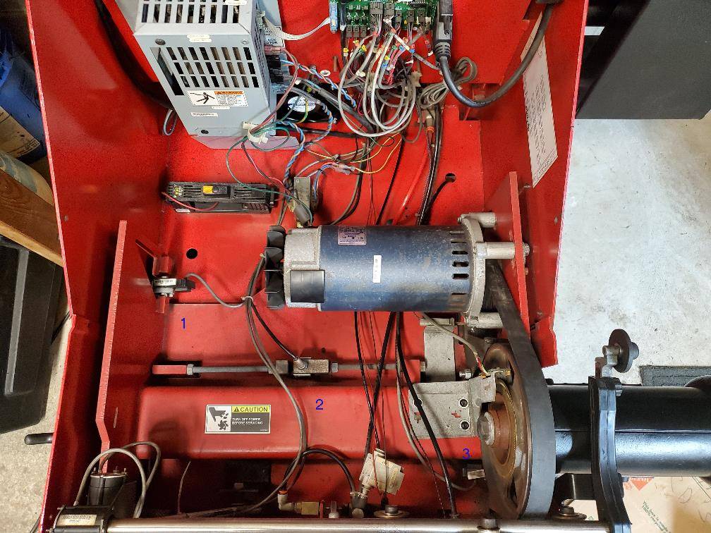

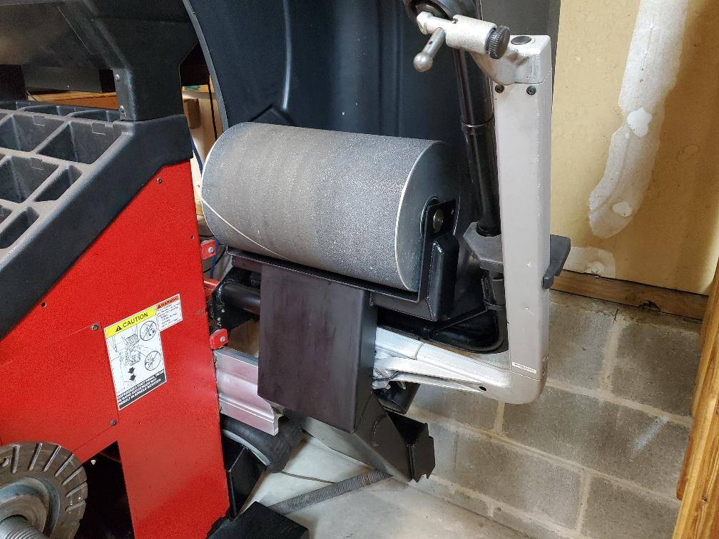

I bought my machine for the Road Force feature, and have not really used the StraightTrak much at all personally. Balancers typically have sensors 1 and 3 (#3 sensor is kind of hidden) in next pic (for vibration measurement/analysis), but this balancer also has a lateral force sensor (#2) that combines with the tire running under a 1400 lb load against a roller (attempting to simulate actual road forces).
This is the roller that is forced against tire.

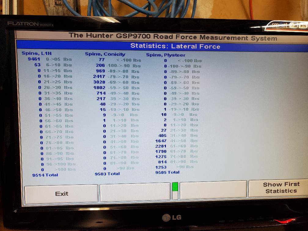

The machine keeps statistics (below is only the one's where StraightTrak was selected, as it is optional when balancing). Of the almost 10K balances that had been done before I got it, virtually all of them were within 0-5 lbs side load (see left most column). But "Conicity" was pretty high on quite a few of them.
https://atlanticmotorcar.com/casestudies/radial-tire-pull-or-is-my-tire-really-cone-shaped/
It also measures Plysteer, which I don't fully understand, but am "told" it typically does not create a pull the driver can really feel.
https://www.tiretechnologyinternati...ily responsible,not discernible to the driver.
