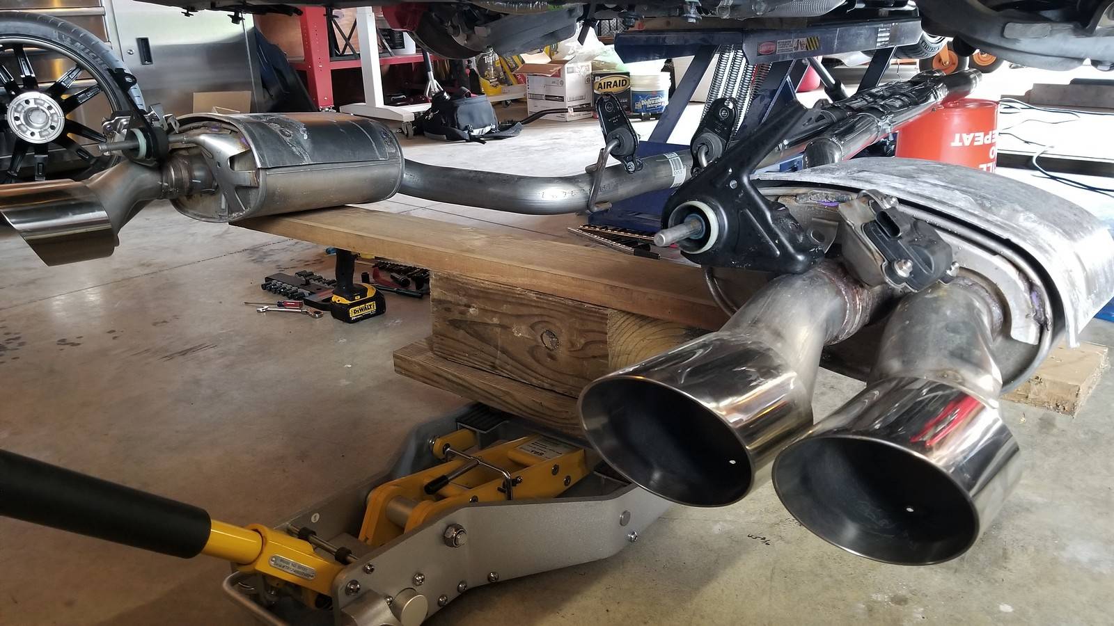

The harnesses can be inspected from underneath the car at the back bumper. A small flashlight will help to illuminate the area and you can follow everything with your hands.
As for lubricating the shafts for the active butterflies, I'd take the bellypan off and lower the exhaust system down at the rear. I've already done this and it is easy enough with simple hand tools. You can unbolt/disconnect the actuators and set them aside, which will allow access for lubricating the shafts. Trying to spray something inside the exhaust tubing would be a weak attempt at doing it right in my book. You can see everything (aside from the harnesses) in this photo...
You can use a small hammer to tap around the circumference of the valves to release them if they are binding but they really need to be lubricated.

Thanks for the tips it worked!
