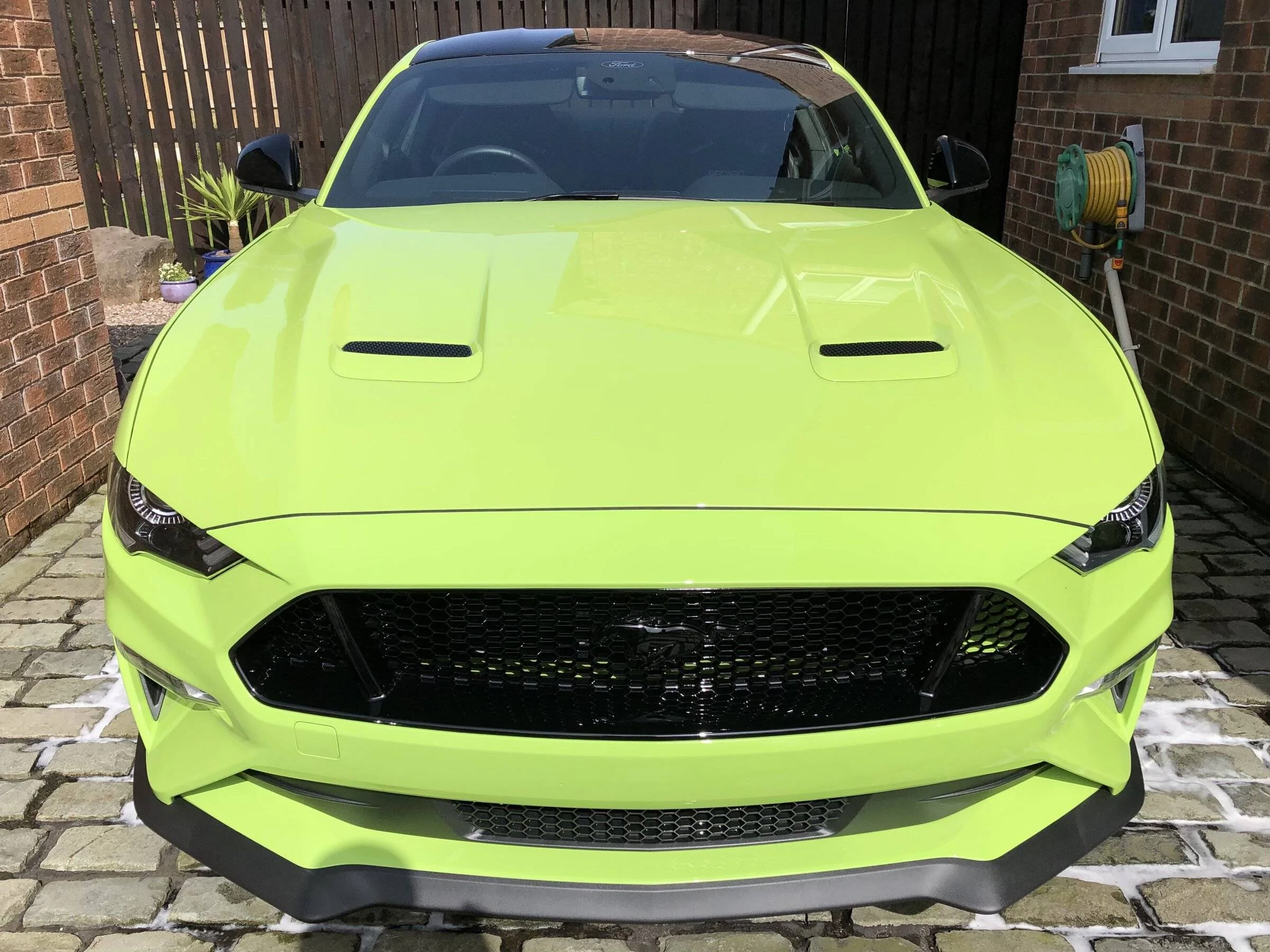

You are right on. My hood gap was creeping up. Not good for aerodynamics. I discovered one of the two 10 mm bolts was missing. Fixed that. Slid the bracket down to the stop, tightened the bolts. Firm pressure required to latch the hood closed. The surface match is jet aircraft clean.
From the factory, mine was ‘very’ low, I had to set my bracket against the upper stop to get it to flow with the bumper :

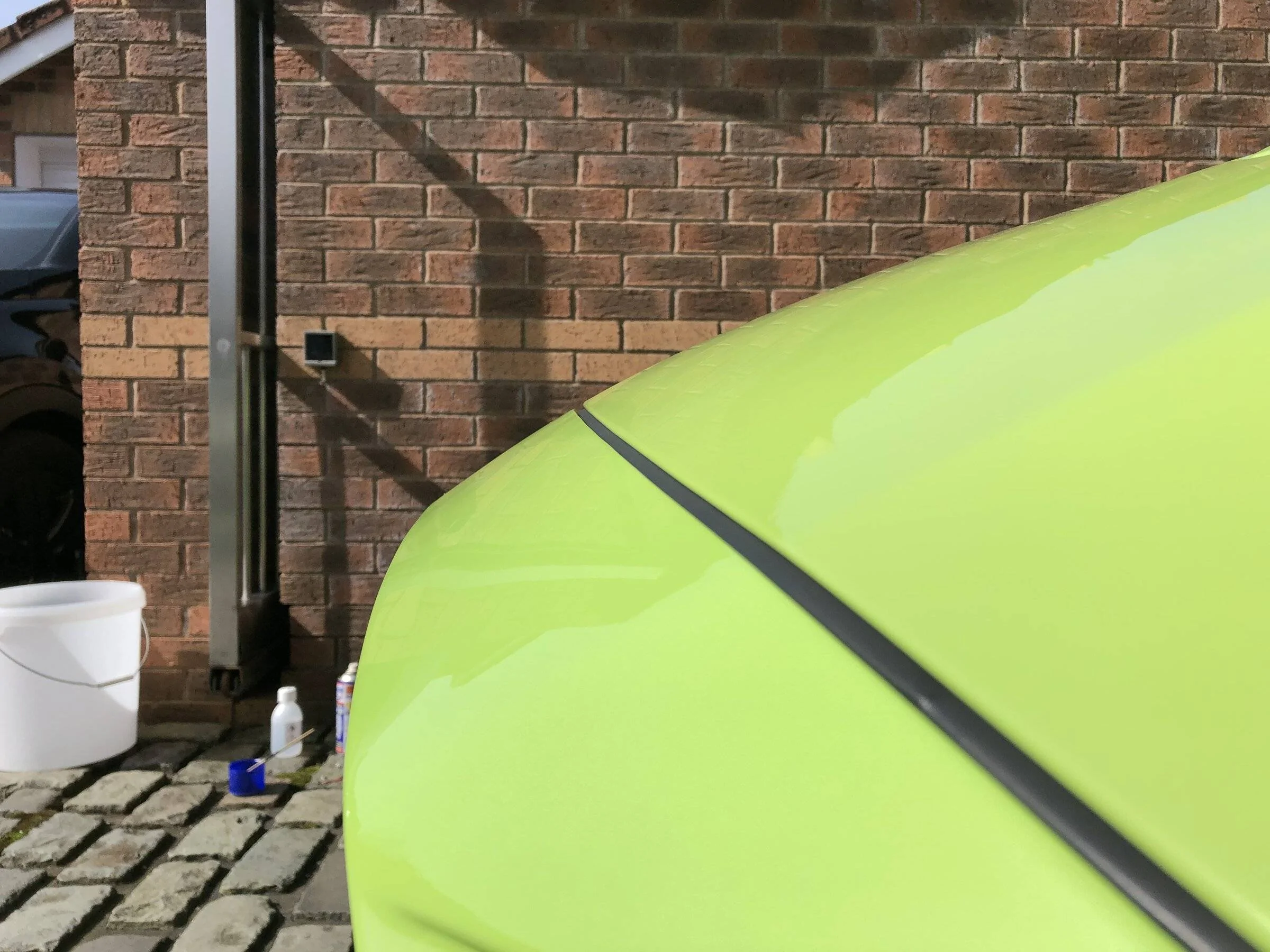

It has a nice front shut line now (it was obviously pinched in the middle beforehand) :

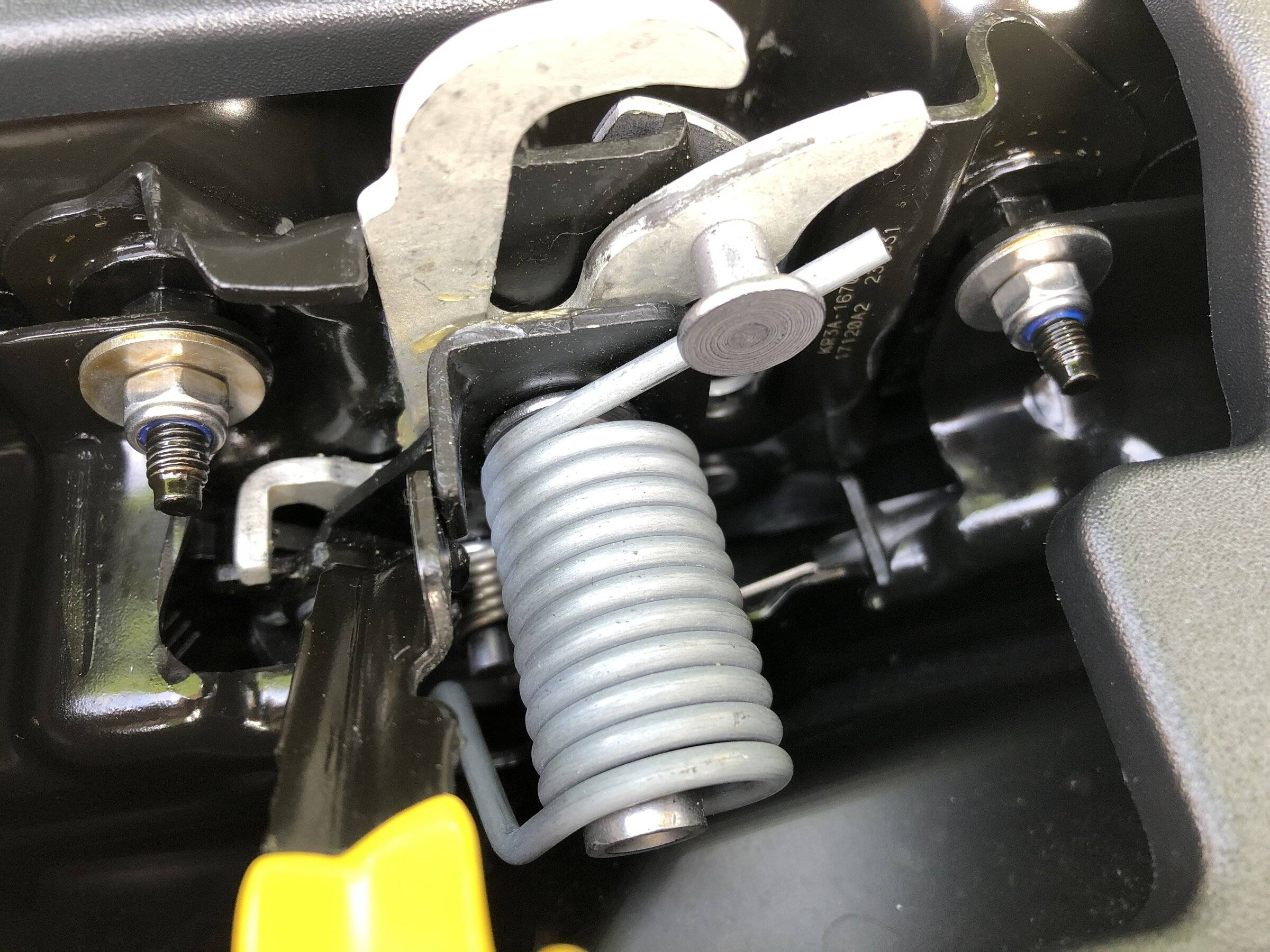

You can see witness of where the catch was from the factory and how much I had to move it :
