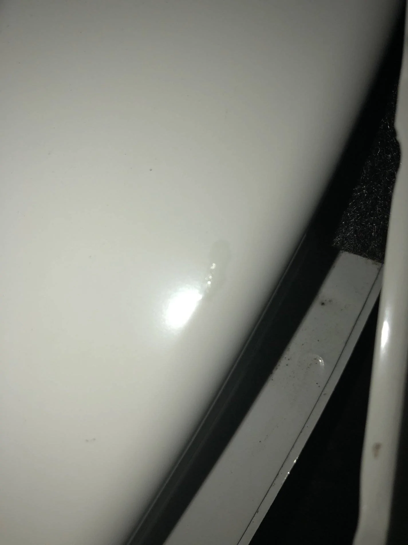

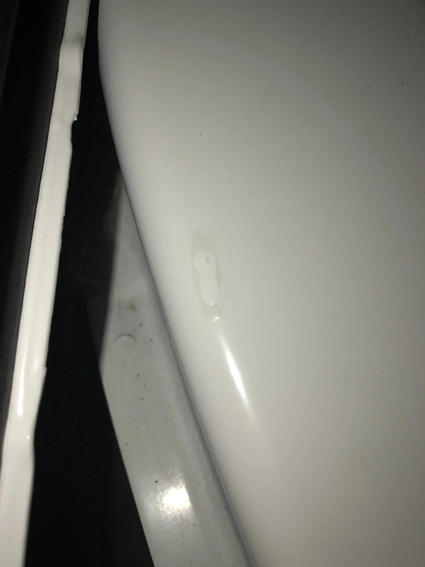

My hood seems to be rubbing in 4 certain spots I let the hood close under it’s own weight I hold it above the latch push up gently and let it fall Im not sure if this is because of it or if ford needs to adjust something. I put oem ford touch up paint on the spots but it appears to be beginning to hit the same spot again

I hadn’t noticed anything irregular but I can do a closer inspection for sure all I noticed is rubbing marks during oil changes in four specific parts on my hood and the body of the car on both sides so I thought possibly the hood is resting slightly to low?

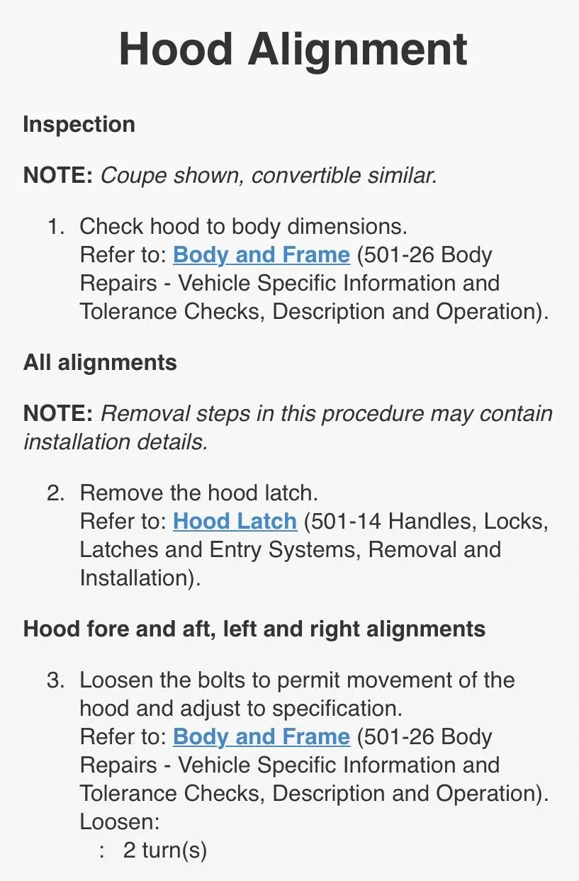

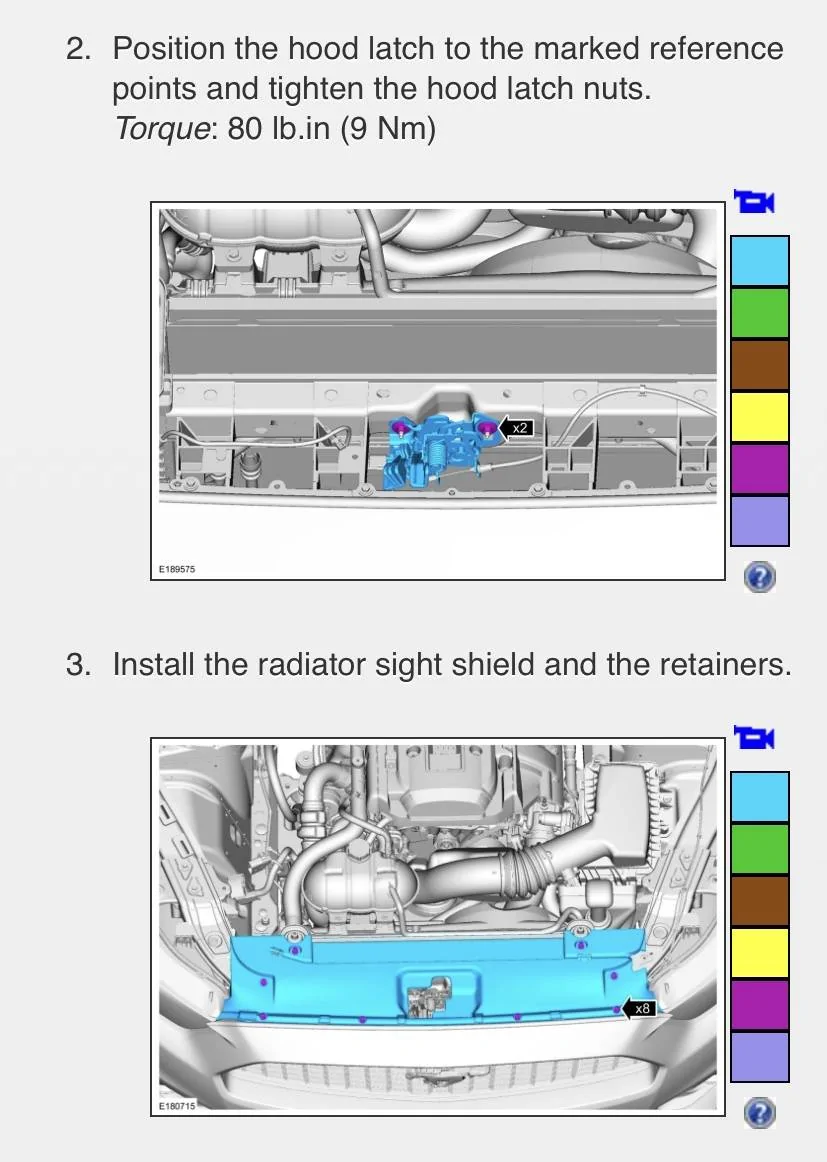

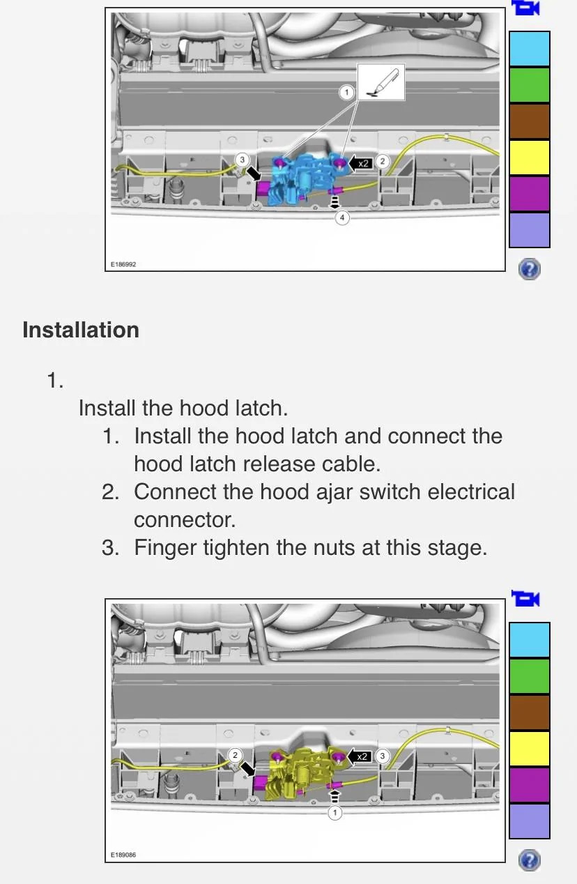

Here’s the alignment info for the 2015-2017’s.
It’s pretty much the same exact steps for the 2018-2019’s with the minor variances being the redesign of the front rad support cover and the actual core support structure.

Nah - don’t look too far into the details of the posted docs. I only posted so ALL of the info pertaining to the hood was available to everyone.
All you need to really do is adjust the rubber bumpers first, then slowly close and latch the hood and see how it sits in line with the tops of the front fenders.
You turn those bumpers clockwise or counterclockwise - that’s it.
You only need to mess with the hood latch IF the hood won’t latch IF you had to significantly raise the hood (and in most instances, a simple twist of the rubber bumpers is all that is needed).
