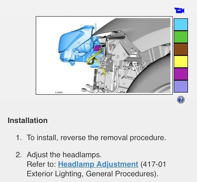

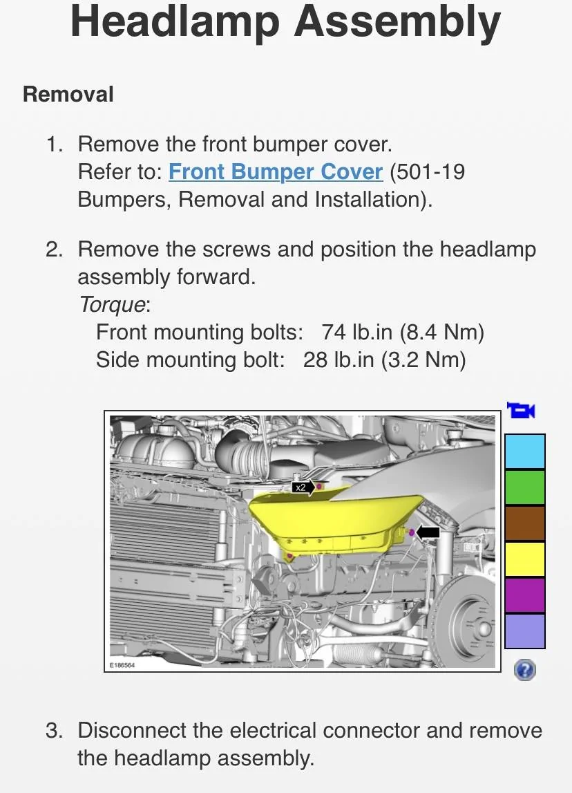

Knowing you have hit something, it's a very high probability that the back of the headlamp mounting points or the "header panel" to which the headlights mount into or the actual internal assembly is even damaged from such an impact.

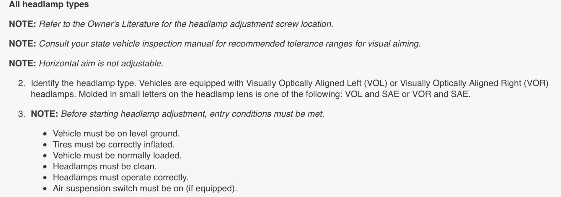

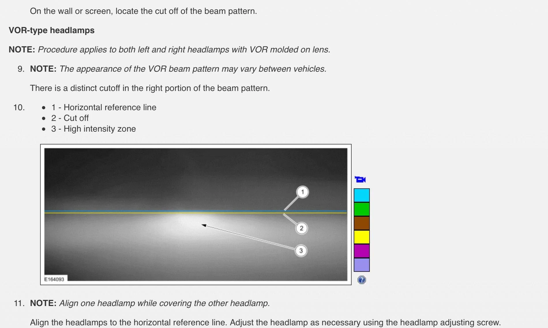

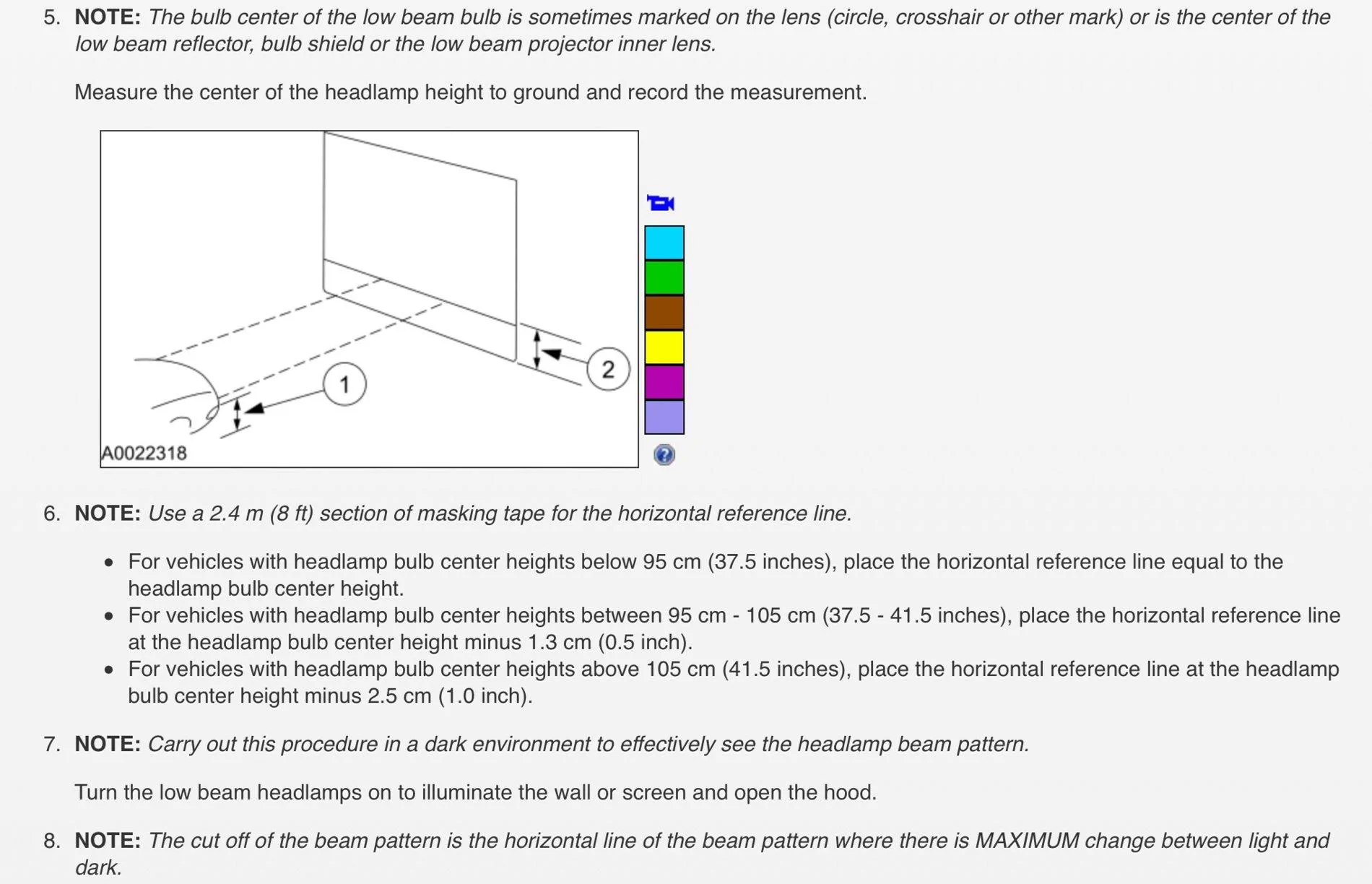

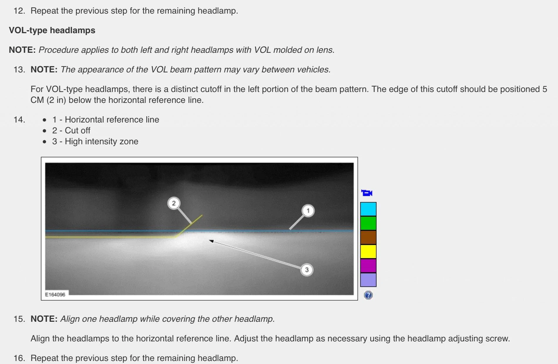

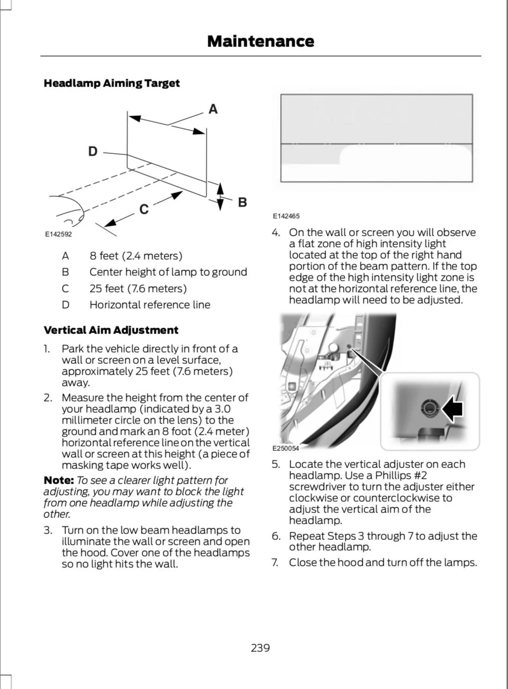

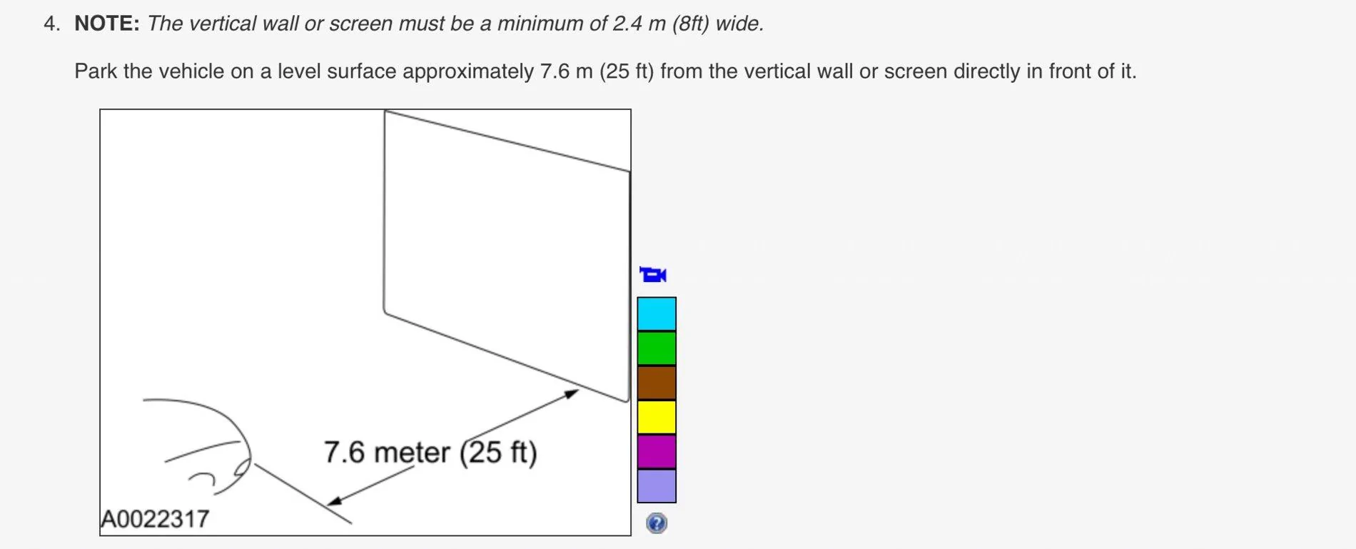

I don't know if the below will help you out, but this is the info for headlight adjustments and alignment of beams applicable for 2015-2018+.
In the below images (Image 2), you can see the adjustment screw protruding from the top of the headlamp and where it intersects the small “box” on the assembly; this would be the “ball and socket” reference.
Headlight Beam alignment details if anyone needs it:
For 2018+, the below is right from the 2018 Owners Manual:
